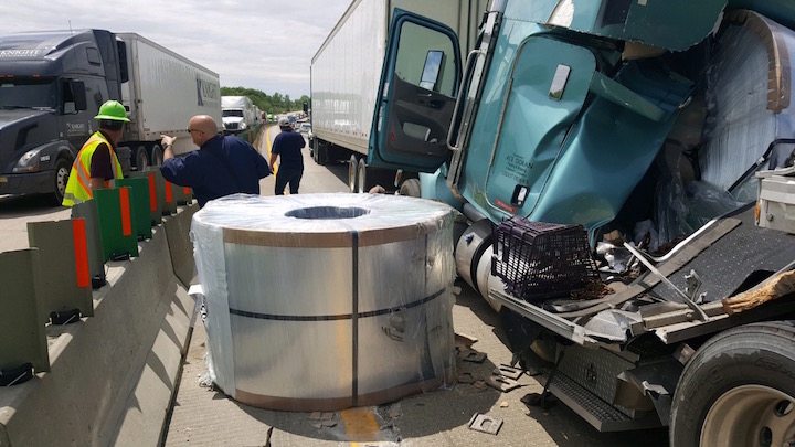

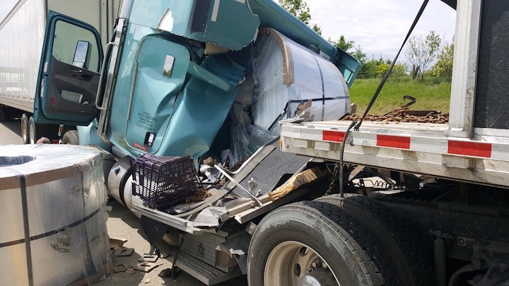

    Just happened today in Central Ohio. Amazing there was just minor injuries.
    As with most news videos, the link does not have much information. ODOT (Ohio Department Of Transportation) posted the photos.
    https://www.nbc4i.com/news/local-new...nty/2016780354

    In the trucking industry this is known as hauling suicide because a roll usually comes through the cab in the event of a quick stop. Most flat-bedders haul the rolls turned 90º to prevent this. I hauled suicide once (my first time - didn't know any better) and I used every chain and strap that I had onboard and drove slow and carefully the entire way. Going into the mill to get them was a memorable experience - most of you've never heard anything like a couple of 16" carbon arc rods going into the pot to melt a batch of steel.
    In that picture the rear axles have a 10' 4" spread between them so the rear axle set can carry more weight than the front axles (which are close together), because there's a span between the two rear axles.
