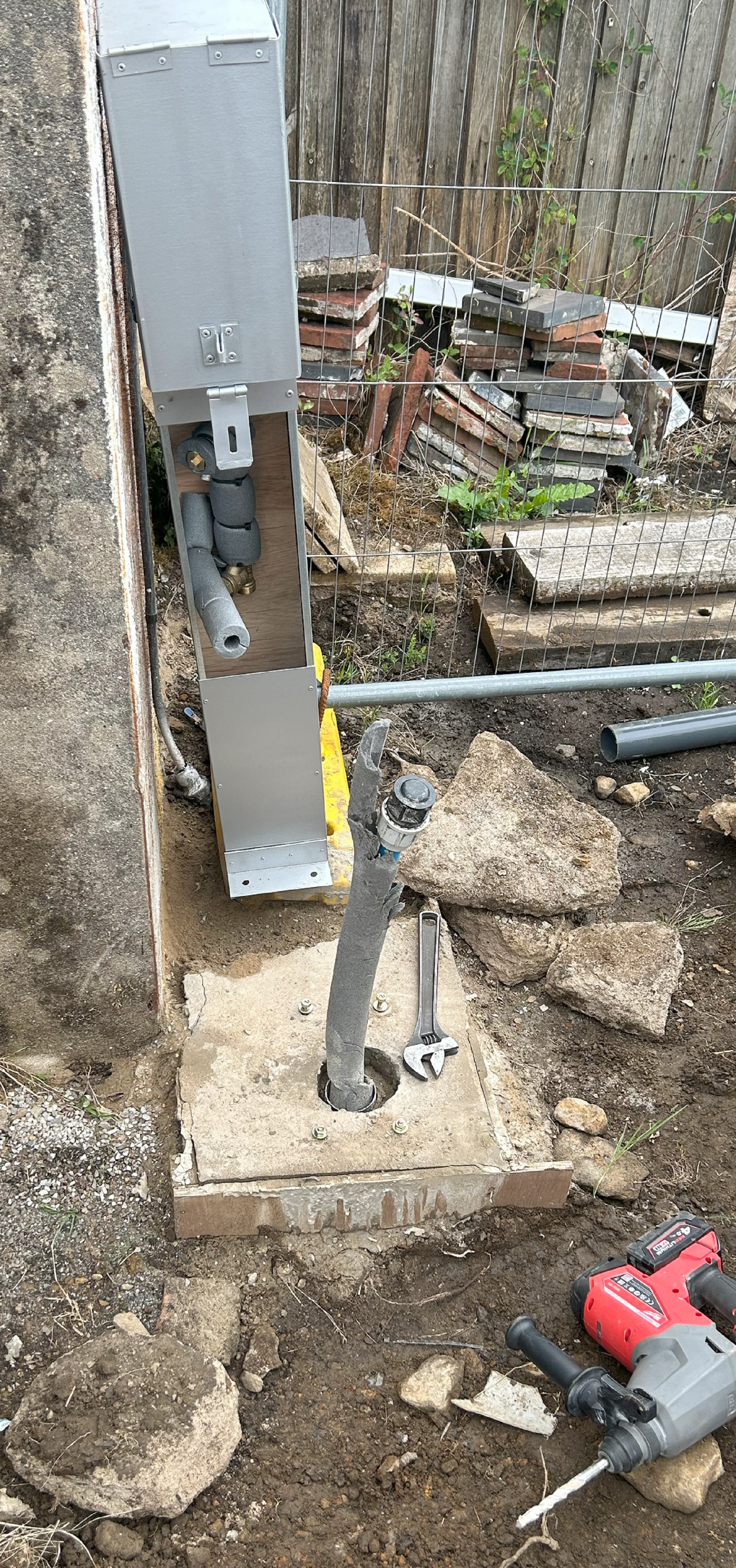

    Standpipe and lockable housing-inlet-pipe.jpg A concrete base for the housing to be bolted to.

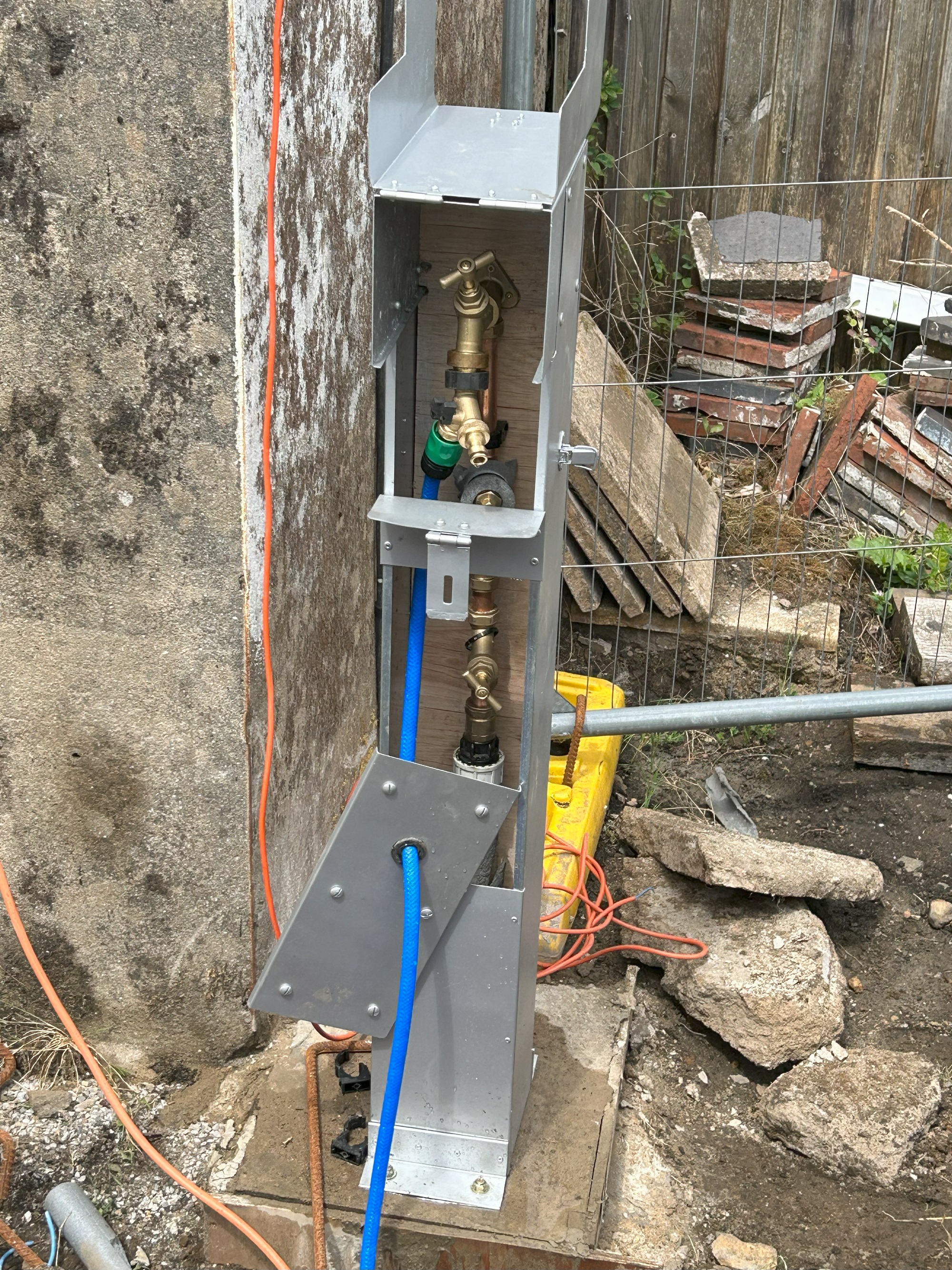

    Standpipe and lockable housing-loosely-conected.jpgBolted down and plumbing loosely fitted.

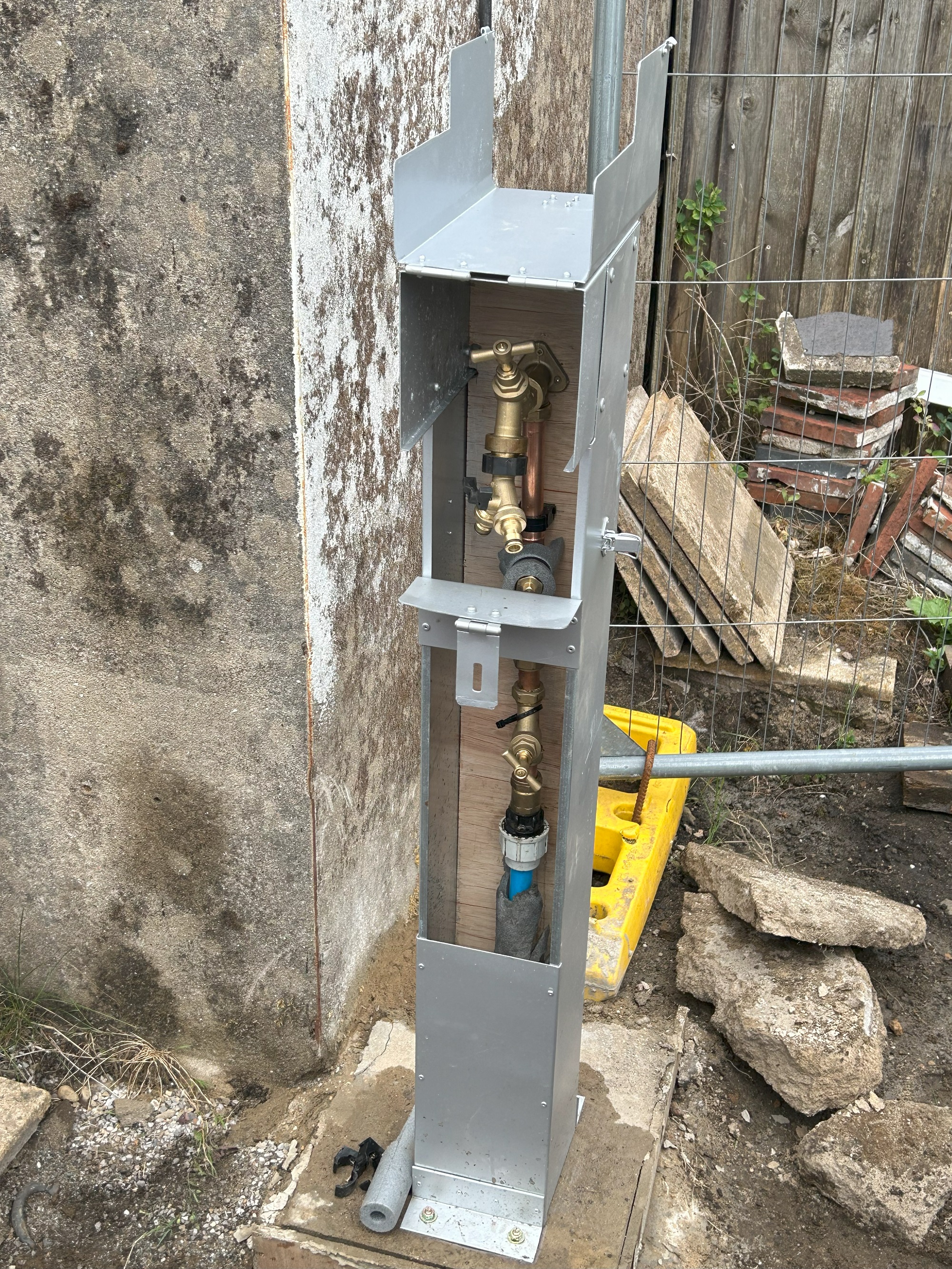

    Standpipe and lockable housing-pressure-test.jpg Pressure testing the fittings from the feed to caravan. (No leaks )

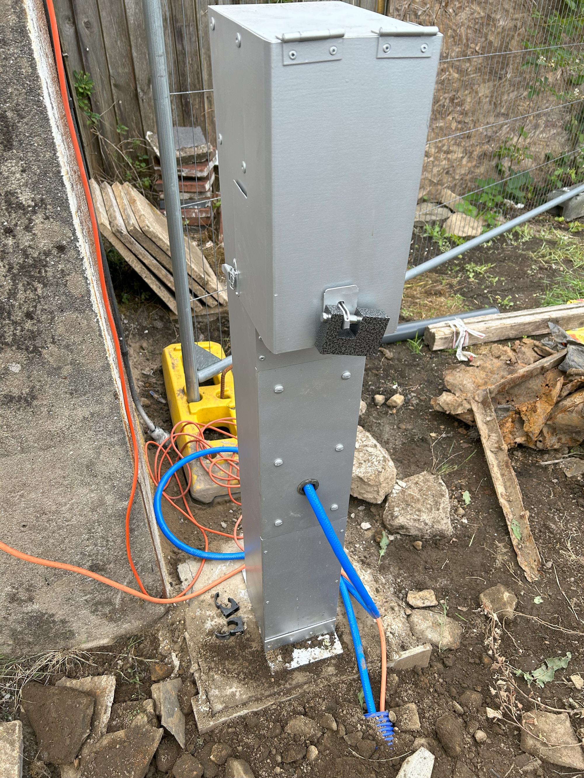

    Standpipe and lockable housing-locked-off.jpgLocked off housing

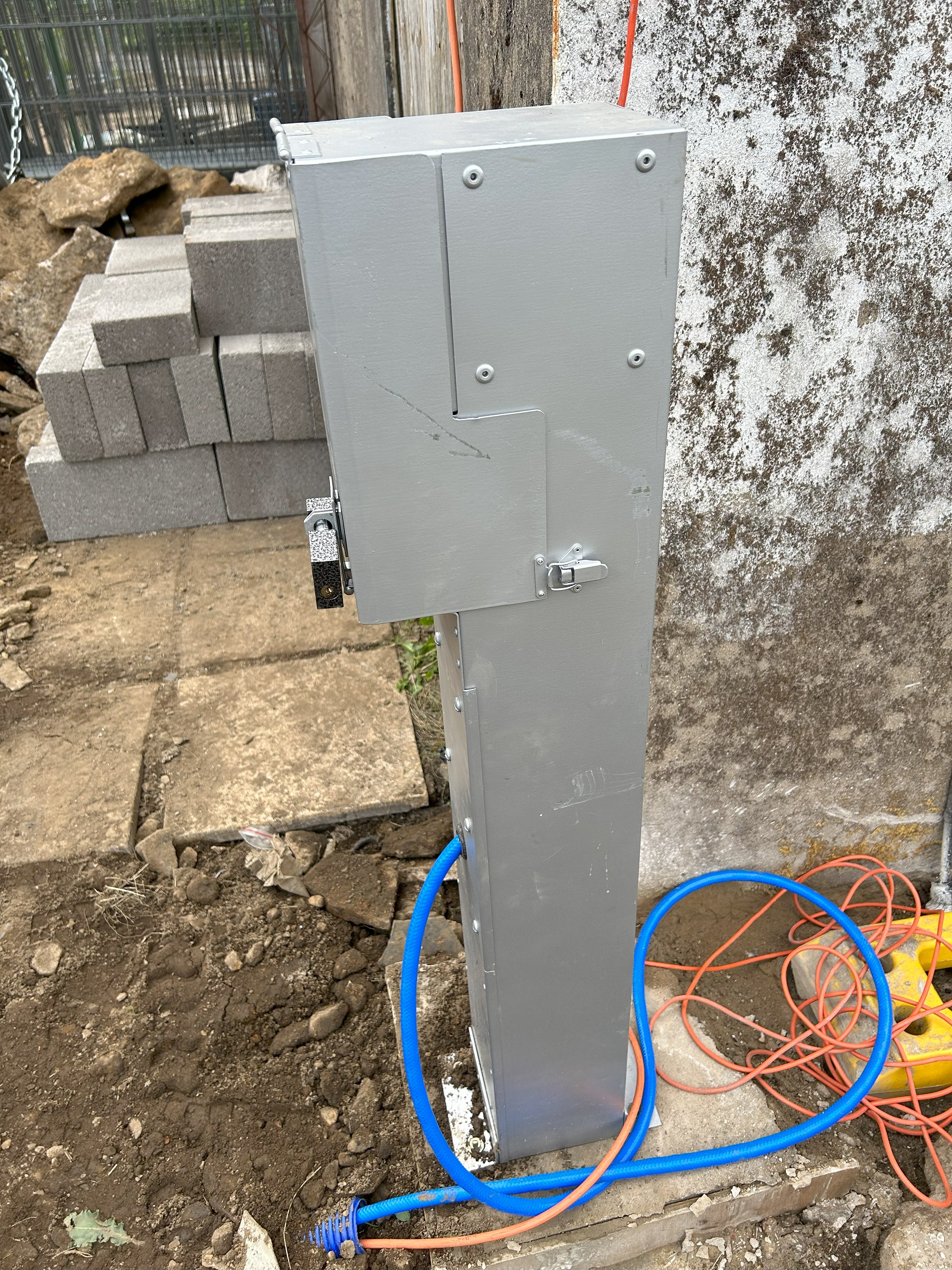

    Standpipe and lockable housing-side-view.jpgSide view. A piece of plastic conduit was buried with both the water and caravan hook up cable so they wouldn't get damaged when bring building materials through.
