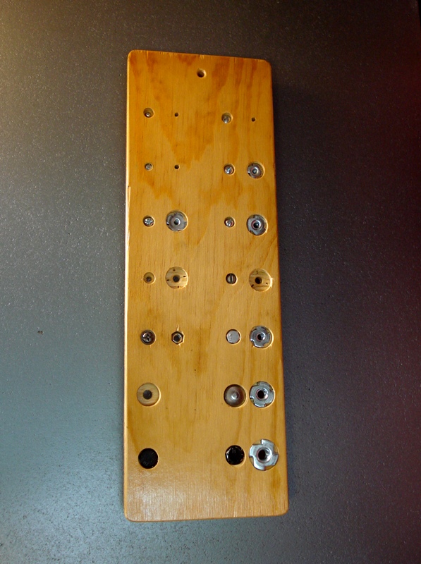

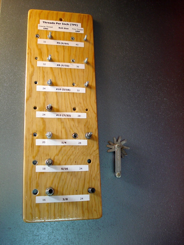

    STANDARD THREAD DETECTIVE
    Some experienced machinists can identify, at a glance, screw gauge, thread type, length, etc. For those of us who do not have much experience, a homemade gauge like this can be helpful to identify the size and thread pitch of both nuts and bolts. It includes nut and bolt sizes commonly used at the workshop: # 6, # 8, # 10, # 12, 1/4, 5/16 and 3/8, in (standard) coarse and fine thread:
    Although there are many commercial models, I preferred a homemade version.
    You could also make a metric thread detective.
    Regards.

    This is a really great idea. I have always been envious of the board at my local Ace Hardware for sizing random bolts and nuts. Thanks for posting this one.

    Thanks, blkadder.
    I made this gauge almost four years ago, and was partly motivated by envy I felt at seeing gauges in hardware stores and some online catalogs. I can guarantee that It has been very helpful for many projects.
