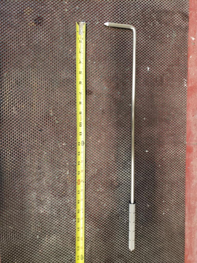

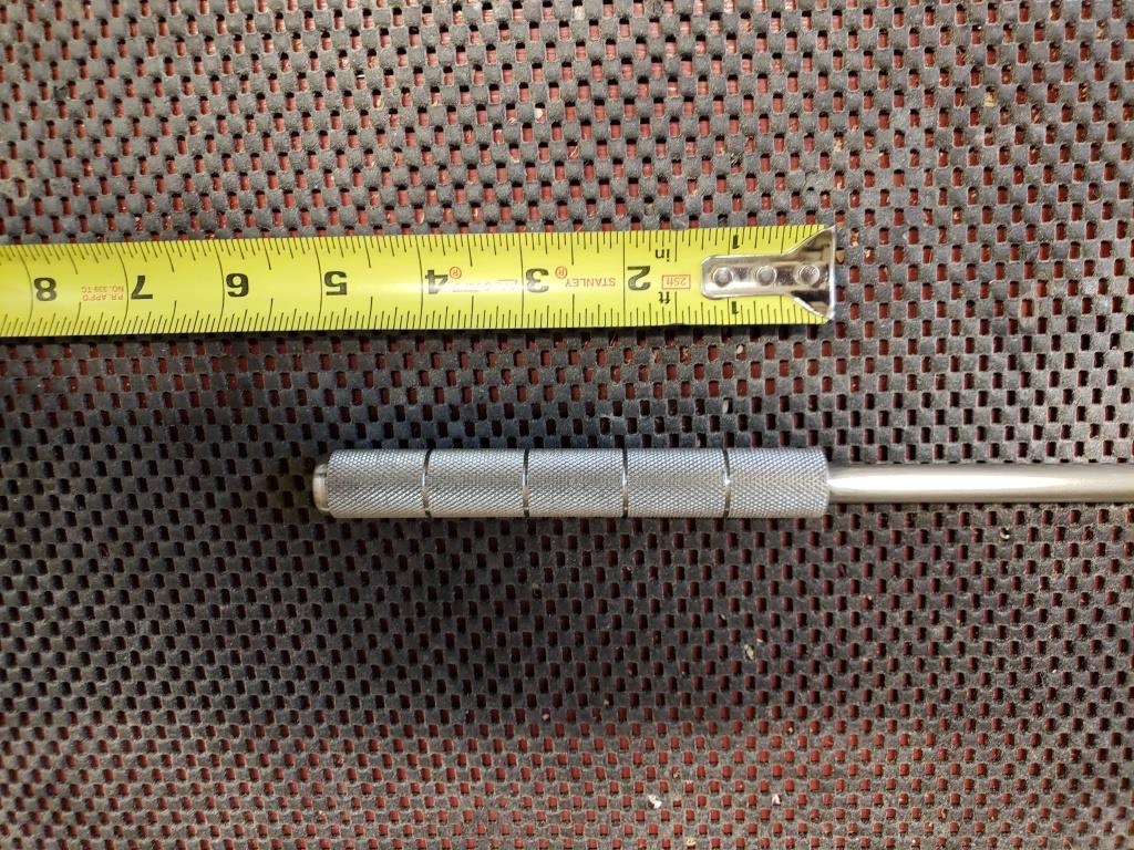

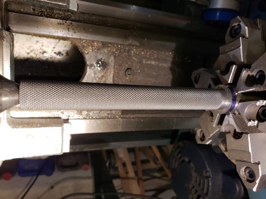

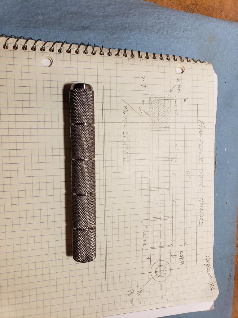

    I used stainless steel 303 0.375 inch diameter and 1 inch diameter rods to make a 24 inch long fireplace tool for our wood burning fireplace. We live about one block from the ocean and it seems that everything rusts or corrodes if it is not made from stainless steel. The fireplace handle has a knurled finished with a 21 a cross diamond pitch and is slightly larger than 5 inches long by 0.7 inches in diameter (actually machined down to 0.693 inch diameter for a perfect fit for this type of 21 pitch knurl – see Smartphone Android app “Knurling Calculator” for calculating the diameters) .
    The fireplace handle details
    Stainless Steel Fireplace Tool-plans-handle-stainless-steel-fireplace-tool.jpg
    The finished tool (shown against a dirty workbench mat)

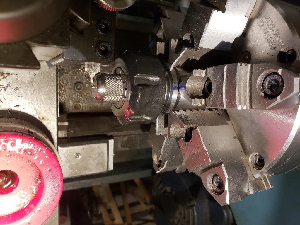

    Construction steps for making the handle
    Stainless Steel Fireplace Tool-finished-21-pitch-knurling-303-stainless-steel.jpg

    I wanted to make this type of stainless steel fireplace tool for a long time but never a priority. If I made this tool again, I would single point thread the male thread on the poker rod rather than do it by hand with a thread die. The stainless steel 303 is very tough on thread dies.
    Regards, Paul

    Doug, the chuck is a 6" Gator 6 Jaw Tru-Adjustable Semi Steel Lathe Chuck that can be trued to within a few 0.0001" using a gage pin. In the full range of the chuck capacity it will be held within 0.0005" TIR. The Gator chucks are made by Fuerda. The chuck designs are clones of the better built Bison chucks but are far less expensive. Also, in one of the photos I am using a Techniks CNC ER32 collet chuck being held within the 6-jaw chuck. This is how I chuck parts that are less than 0.5" in diameter because the 6-jaw chuck can't hold smaller diameters.
    JR, the 303 stainless steel 6" long 21 pitch knurl turned out well by pre-machining the diameter according the SmartPhone app "Knurling Calculator". I usually add another 0.002" to the calculated diameter. There are different knurling techniques but in my experience the pre-machining to the correct knurling diameter based on the knurl pitch guarantees the best sharp-pointed knurl surface every time.
