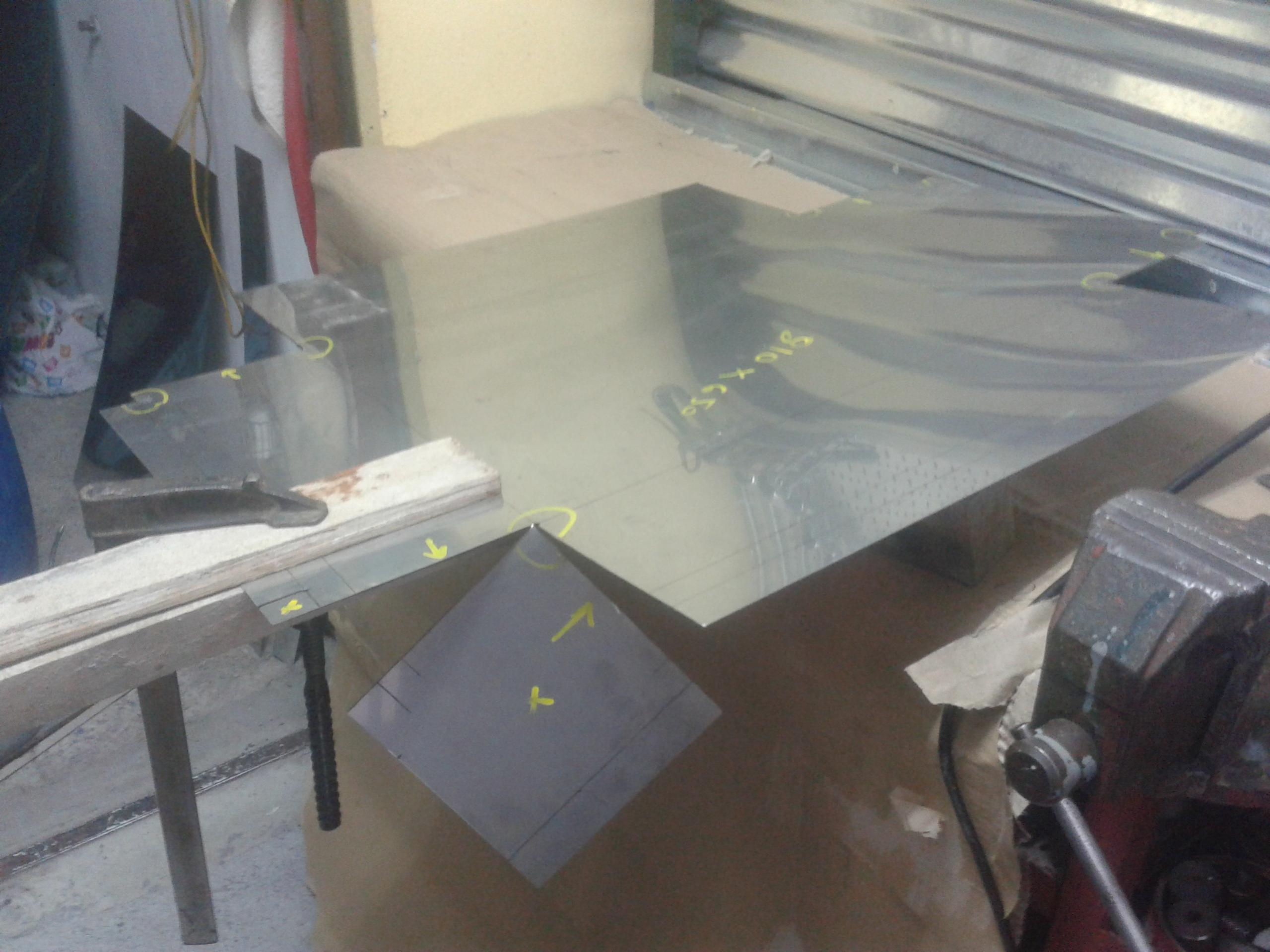

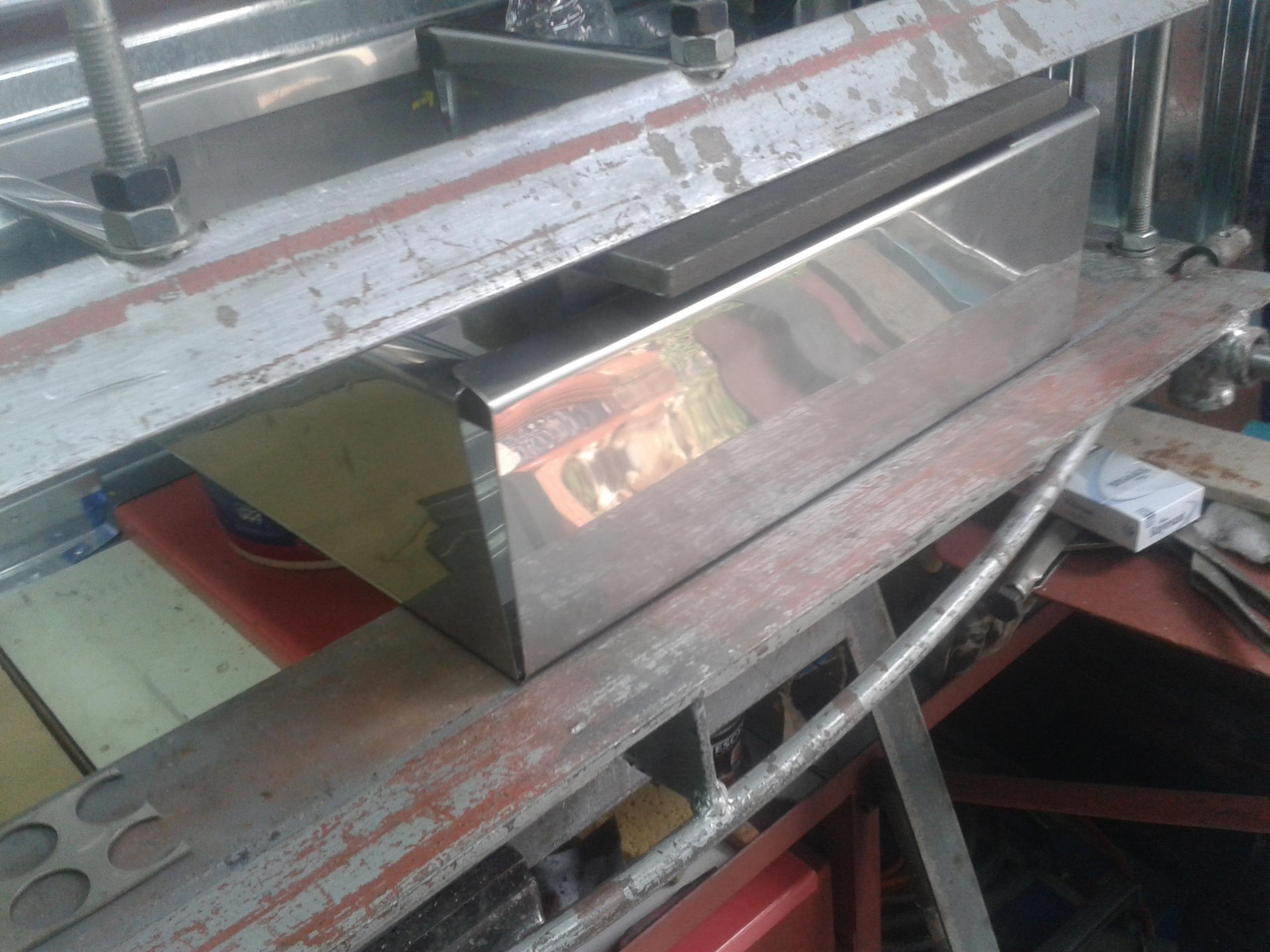

    Stainless Steel Barbecue with double layer bottom

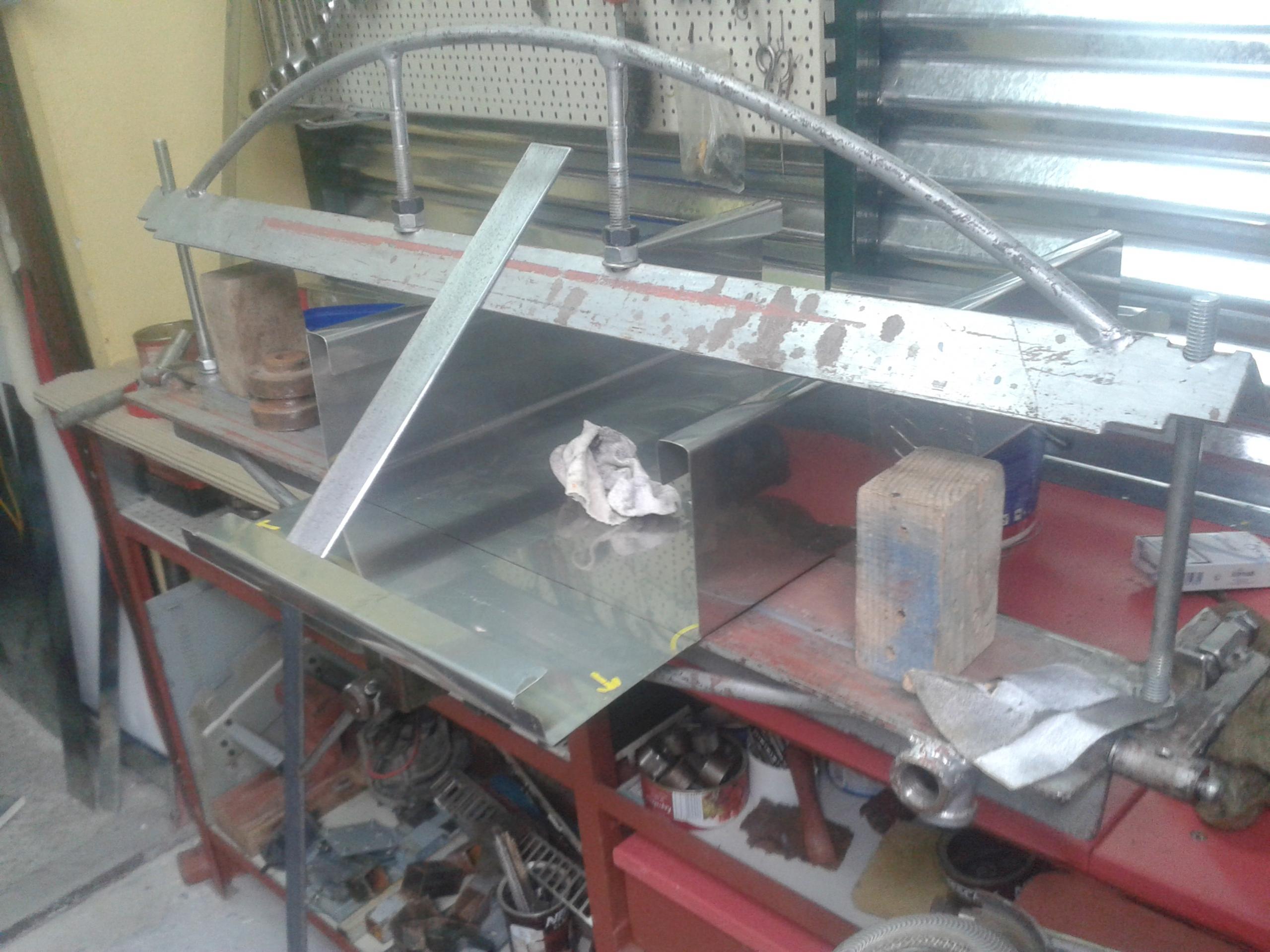

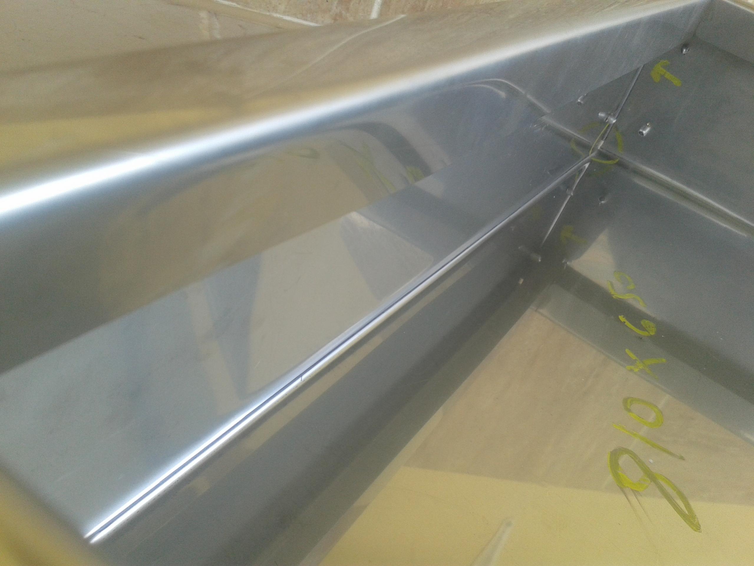

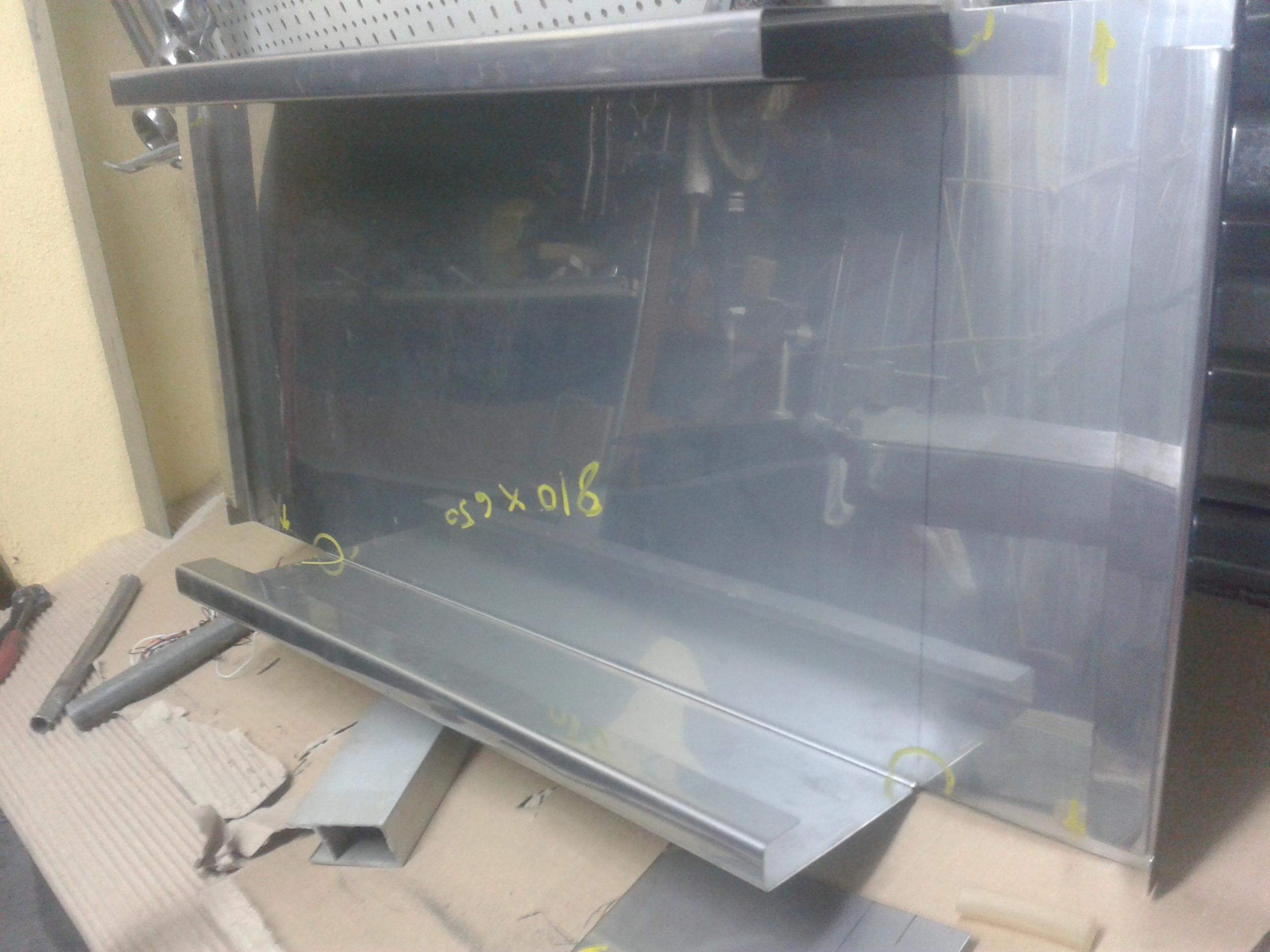

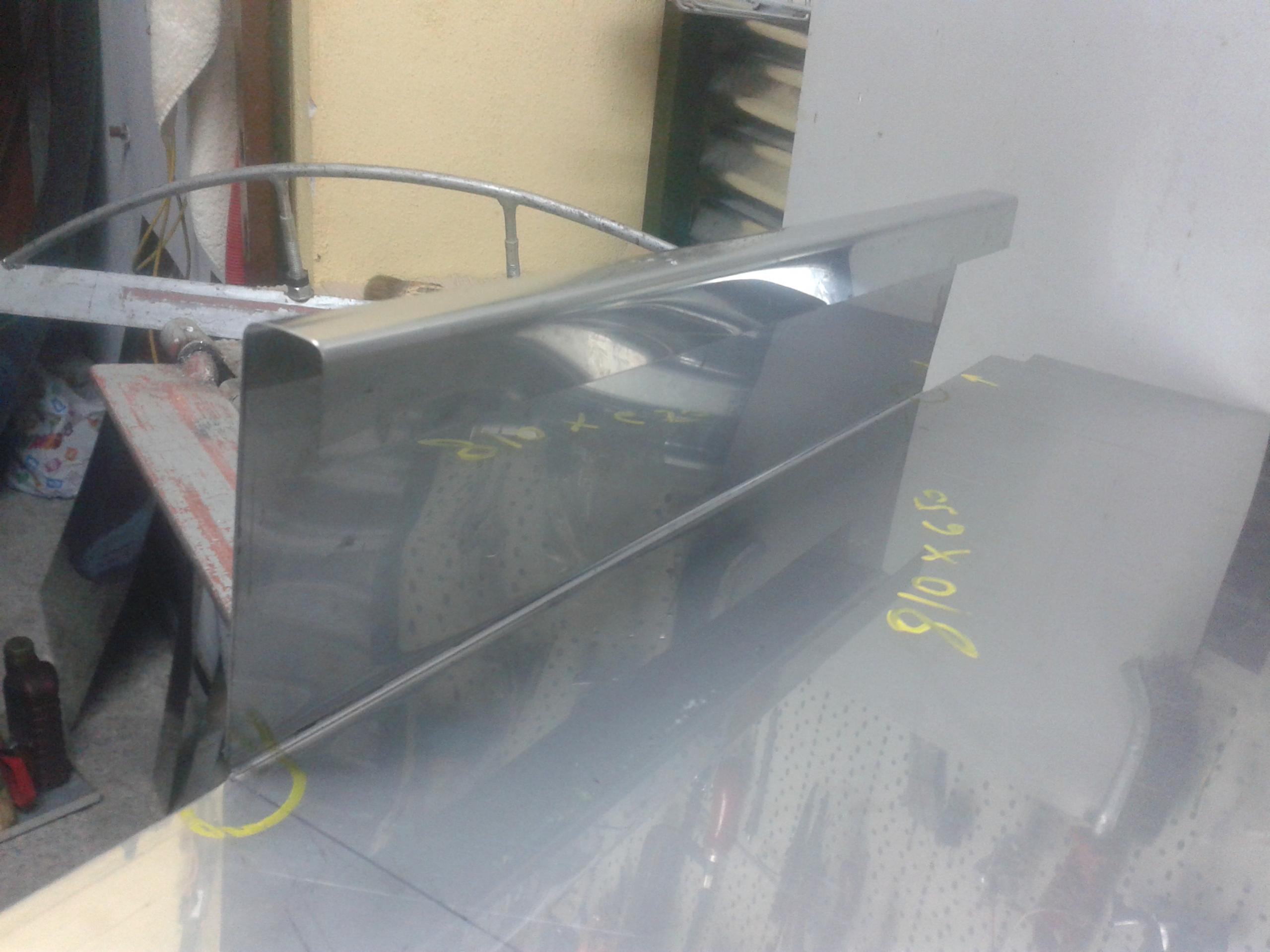

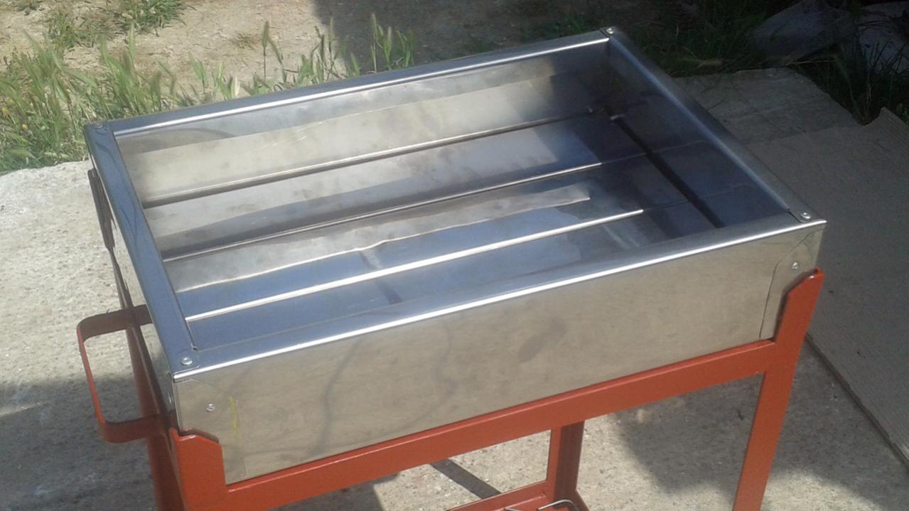

    340x500mm Stainless steel (AISI 304) BBQ with double layer bottom.
    The second layer protects the bottom from
    overheating, dilation, deformation,
    and reduces the loss of the heat.

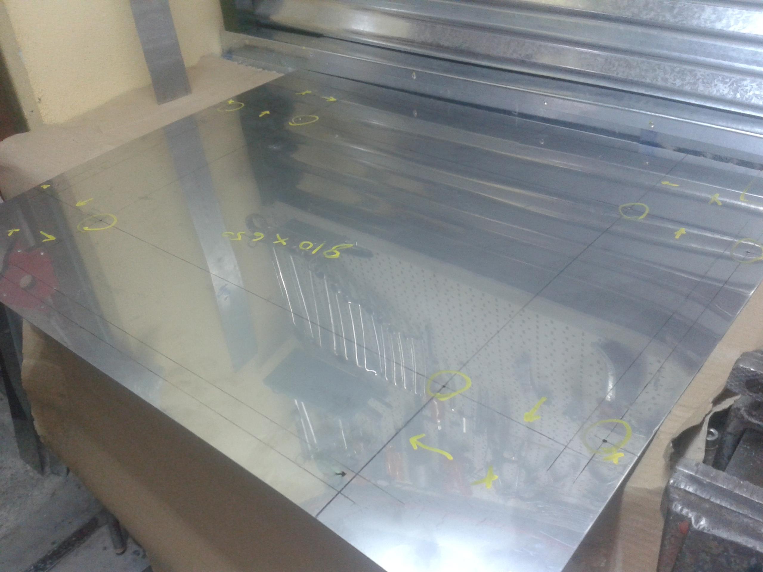

    materials for BBQ
    Sheet metal AISI 304
    1pcs 810X650mm thick 0.7mm
    4pcs 490x140mm thick 0.6mm
    The thickness of the material that I have use, isn't one way root,
    you can use thinner or thicker materials as you like.
    20pcs Rivets 4mm
    materials for stand
    Angle iron 30x3mm about 6m
    2pcs 508mm
    2pcs 348mm
    4pcs 600mm
    4pcs 60mm
    2pcs 448mm
    2pcs 288mm
    Flat bar 20x3mm
    2pcs 250mm
