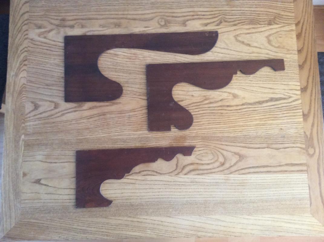

    Making use of some very nice pine from the back of a wardrobe, I made these squares, one as depicted in antique prints, the other two which seemed pleasing to my eye.
    Most of you know that, to try the square, you rest it on a straightedge, mark, flip it over and strike another mark. If the marks agree, the square is accurate. If not, plane off a bit!

    My Grand pa was a farmer for almost as long as I can remember but before he retired he worked as a finished carpenter and cabinet maker.
    He had a lot of wooden hand planes, and squares made out of wood with ornate curves and a wooden level that he had made. I can remember stories he told us kids as to why this curve or that curve was cut into the squares. It seems to me that he probably made the curves to suit his needs and the squareness of the 2 sides was only an after thought, also some were made as set angles not squares at all.

    Thank you, Frank, I would be very interested to learn why your grandfather selected a particular curve and for what purpose, if you can remember. I also have made templates for angles other than ninety degrees, eg for spandrel frames

    Phillip it probably had something to do with him being a Mathes and a first cousin to George Curtis Mathes of Mathes coolers which later became the Curtis Mathes Corporation. I remember there used to be a television ad after the corporation was bought out and Curtis had passed away the ad ""read the most expensive television made in America and worth it"". My grandpa made high end custom cabinetry for the company from just prior to WWII until sometime before I was born then He moved to Austin for maybe 7 or 8 years until he retired a to take over the Texas part of the family farms where we wound up living and he remained there until finally selling off at the age of 94 He and my mother spent his remaining years traveling all over the country.He passed away in 1986 1 of my cousins still has several of the Mathes fans and coolers
    So I would venture to say the curves were templates or go no go gauges for the things he made while at Mathes coolers
