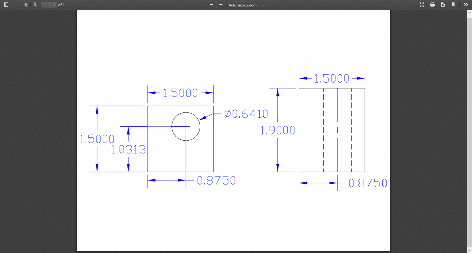

    Both of my square stop blocks have the following dimensions:
    1.900" tall x 1.500" square w/ a pin hole diameter of 41/64" ( 0.641" ) for the 5/8" diameter pins.
    The "offset" pin hole is located as follows:
    With the square stop block standing as it would be pinned in the bender with the 1-1/2" x 1-1/2" top surface up and the "offset hole" in the upper right hand quadrant, the vertical centerline is is exactly 7/8" (0.875") from the left hand side or 5/8" (0.625" ) from the right hand side and the horizontal centerline is is 1-1/32" ( 1.03125") up from the bottom edge or 15/32" (0.469" )down from the top edge.
    This puts the "crosshairs" for center punch and drilling in the upper right hand quadrant.

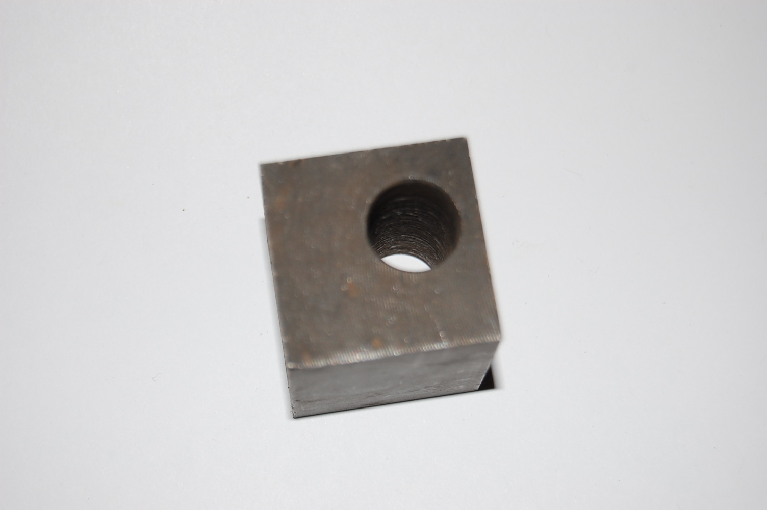

    WyoGreen's Avatar
    20
    Thanked 14 Times in 10 Posts
    I've got one. It's 1 7/16" square, X 1 15/16" long, with a 5/8" hole drilled length ways, center of hole being 9/16" from one side and 7/16" from the adjoining side in the corner of the block.

    Thanks WyoGreen & bumJelly...thanks very much!Square Stop Block for Harbor Freight Bender-harbor-freight-bender-square-stop-block.png
    Here's a drawing for anyone else who may need it.
