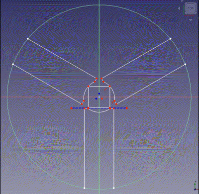

    Given the proper thickness shim, I think I can center square stock in a 3 jaw chuck. I just tried it in my shop. I haven’t derived the equation relating stock size to shim thickness but I’m sure Marv can do it quicker. With one jaw vertical, shim goes on it. Other two jaws press on the stock at the top corners.
    My chuck jaws have a taper on the flank so that complicates the math.

    Quote Originally Posted by rgsparber View Post
    Given the proper thickness shim, I think I can center square stock in a 3 jaw chuck. I just tried it in my shop. I haven’t derived the equation relating stock size to shim thickness but I’m sure Marv can do it quicker. With one jaw vertical, shim goes on it. Other two jaws press on the stock at the top corners...
    I think the maths for this might be quite complicated

    Quote Originally Posted by Alans Home Workshop View Post
    Accounting for the shape of the jaw tips would make it complex indeed !
    If the jaw tips were flat, I think it might be easier. Since the 3jaw is self-centering, the bottom jaw must be at the same distance from the center of the square as the two top jaws are.
    Let:
    S = length of the side of the square stock
    Then S / √2 is the distance of the top jaws from the center of the block and the shim needs to be S / √2 - S/2 = S ( √2 / 2 - 1/2) = S (√2 - 1) / 2 = 0.2071 S
    Oh, that it were that simple. :-)
    Regardless, shimming isn't nearly as safe as a collet arrangement along the lines of what I described.
    Regards, Marv
