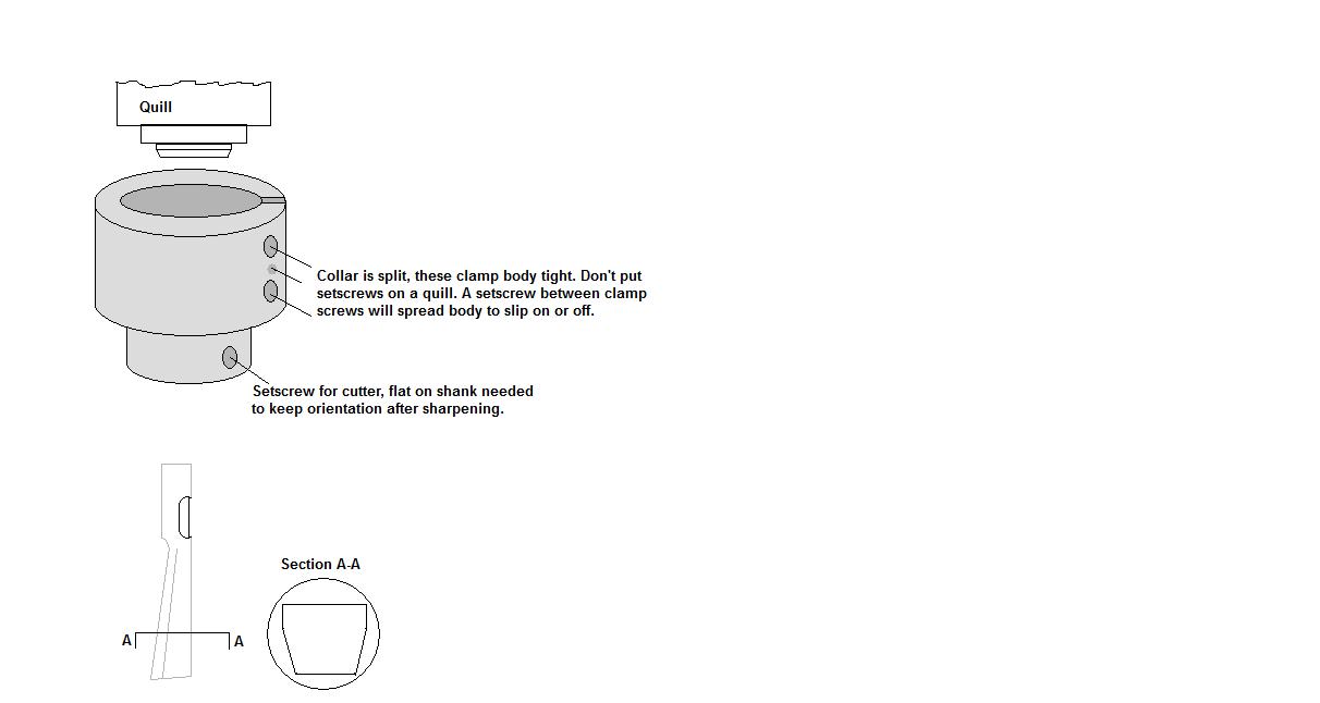

    Quill stroke shaper
    All these suggestions work; but one solution hasn't materialized. If you have a quill or area you can clamp a 'fitting', make a single point shaping tool. Mine is bored to fit Bridgeport, split for clamping. Has a blind hole 1/2" diameter about 1.25 deep. Holds high speed blank, like a broken endmill shank or drill blank. If you can surface grind, a bit of negative clearance in front and a triangular shape will make sharpest corner you could want. Something like a cutoff tool, but cutting on the 'face' instead of top.
    Drill undersize of 9/16" and use smallest endmill to square up inside as far as you can. Put the 'shaper' on and shave .001 increments from each (creating) 4 sides. It works well. Have done narrow slots and a hex once, with a rotary table for 60 degree sides.
    Another way is to use an endmill holder, just lock the spindle brake.
    If a sketch would help, I'll edit this and insert here. Just click on this illustration

  7. #5
    California, central coast
    720
    689
    C-Bag's Tools
    I think I know what you're describing but a pic of your setup sure would be nice and to make sure I'm not misinterpreting
