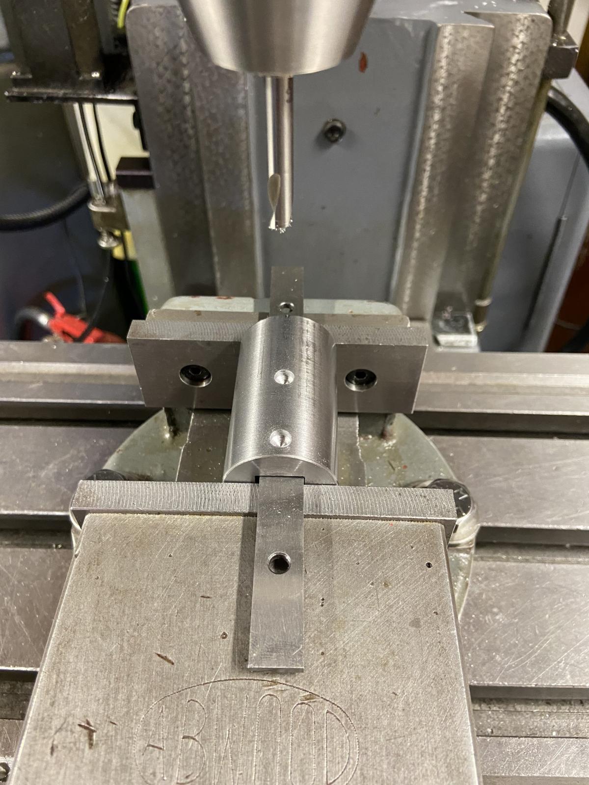

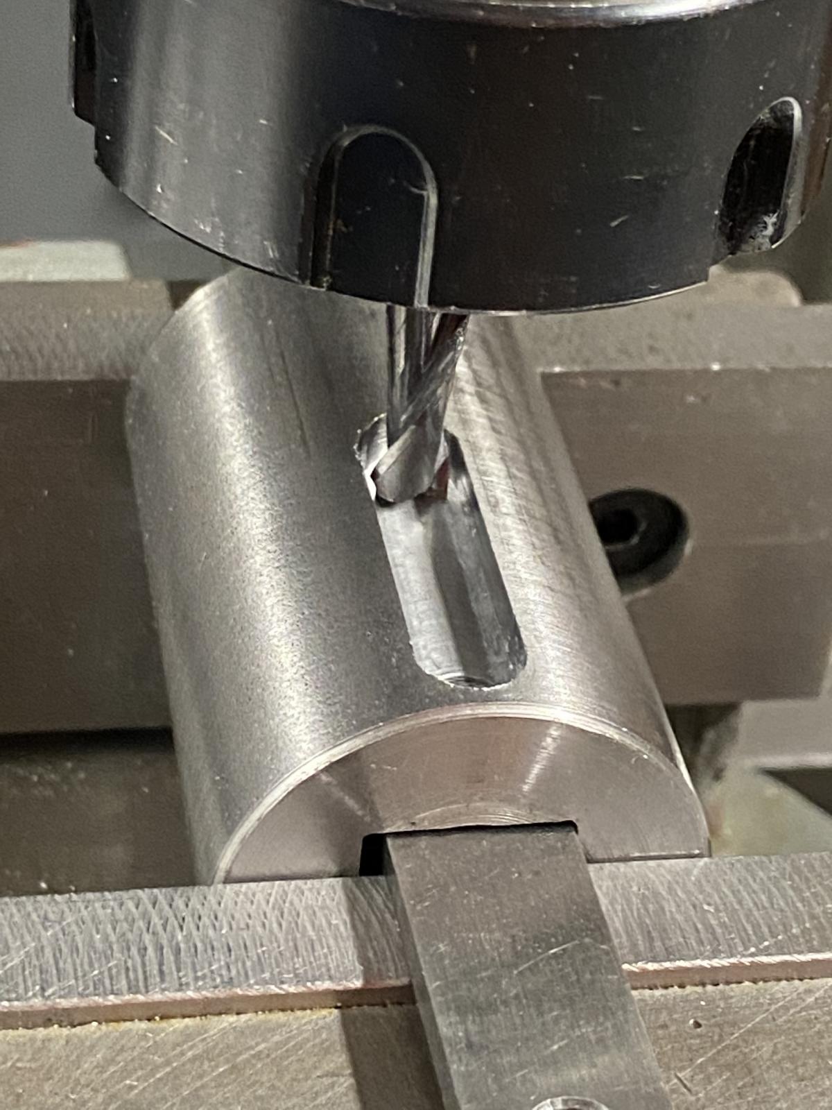

    The taper lock pulley and bushed arrived so the first process was to cut the keyway. The adaptor bush was set up in the mill vice and to ensure the orientation of square to keyway position a parallel was used to align.
    Square drive coupling and key for taper lock pulley-set-up-mill.jpg Parallel used across vice jaws

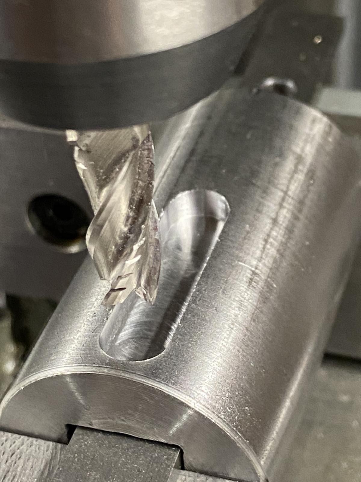

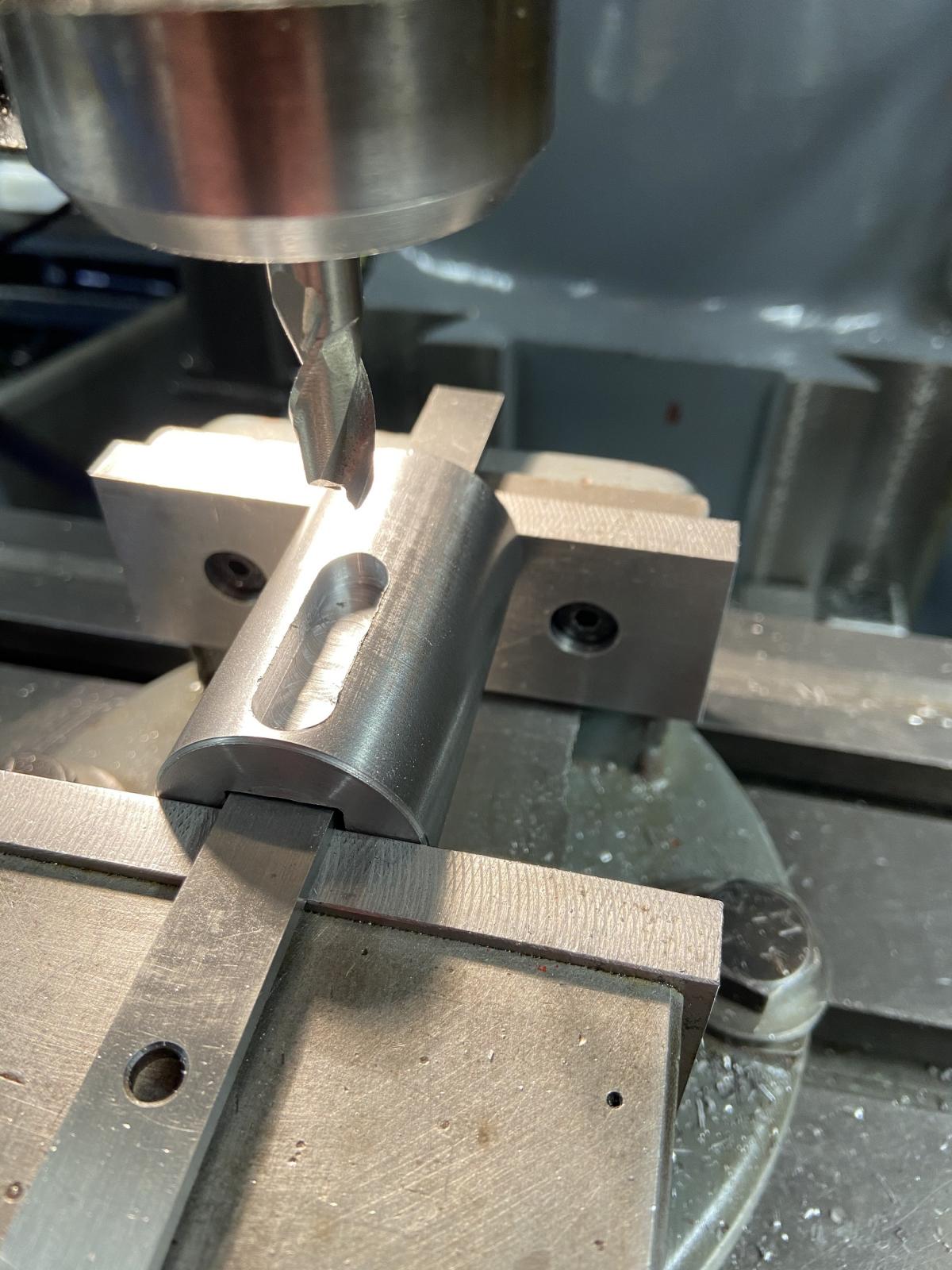

    Square drive coupling and key for taper lock pulley-roughing-out.jpg Roughing out keyway
    Square drive coupling and key for taper lock pulley-milling-keyway.jpg Square drive coupling and key for taper lock pulley-finished-keyway.jpg Finished keyway

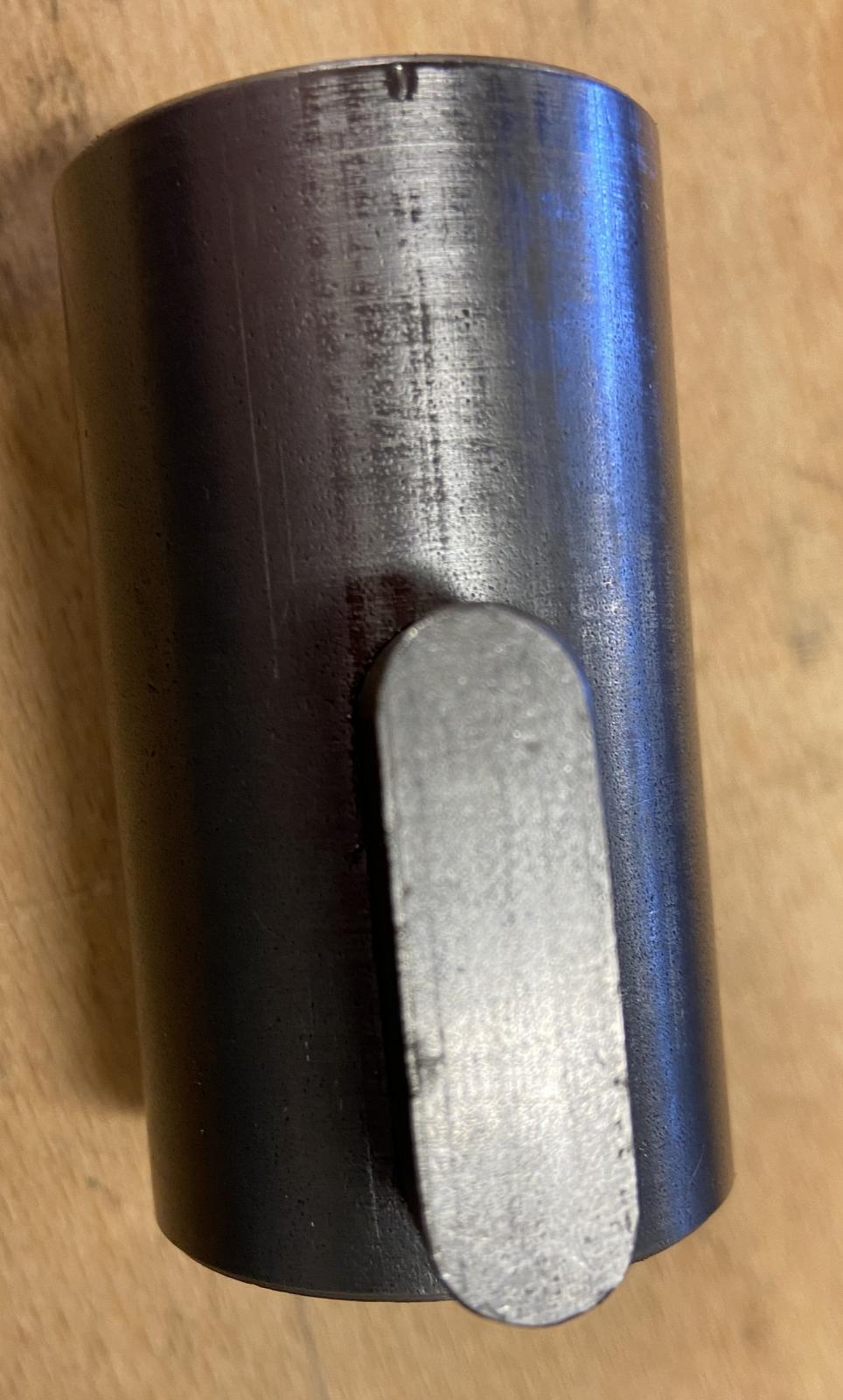

    After milling the keyway this was then used as a gauge to make the key.

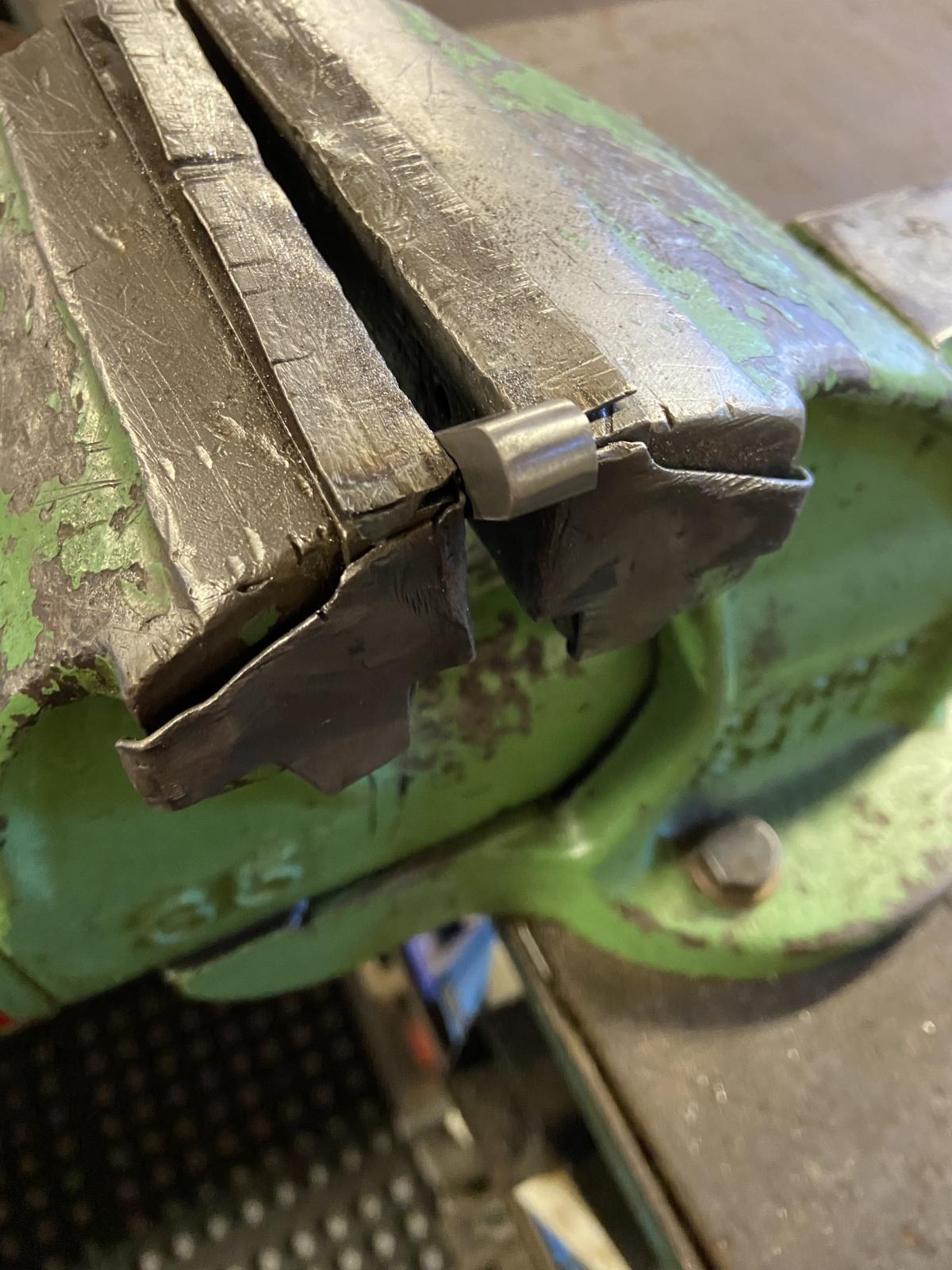

    The key was made from a piece of 3/8" square steel cut just over length and ends filed to full radius.
    One end filed.
    The machined keyway used as a gauge to check fit.

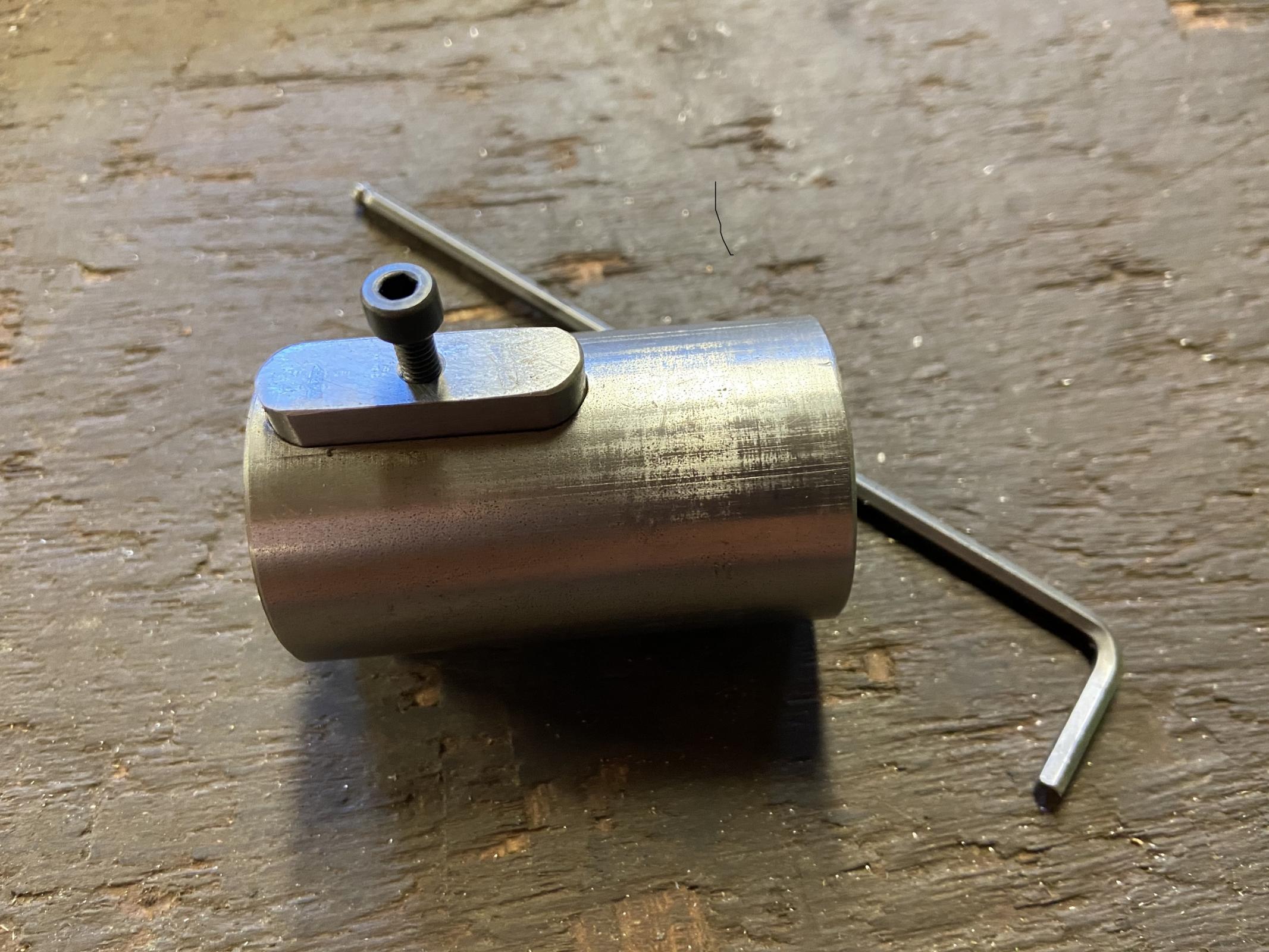

    I machine a screw in the middle of the key to aid removal.

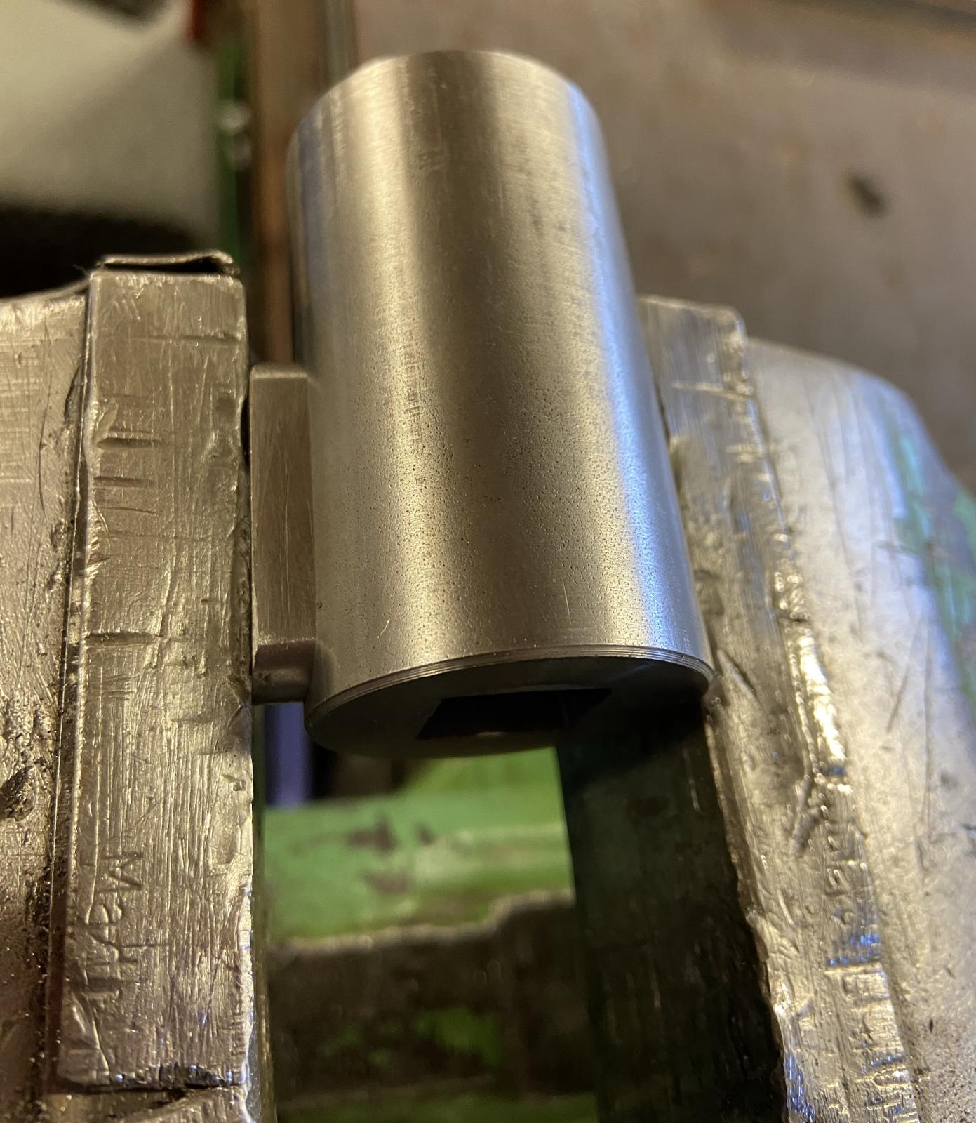

    The key is pushed into the keyway and this highlights the tight spots once removed.

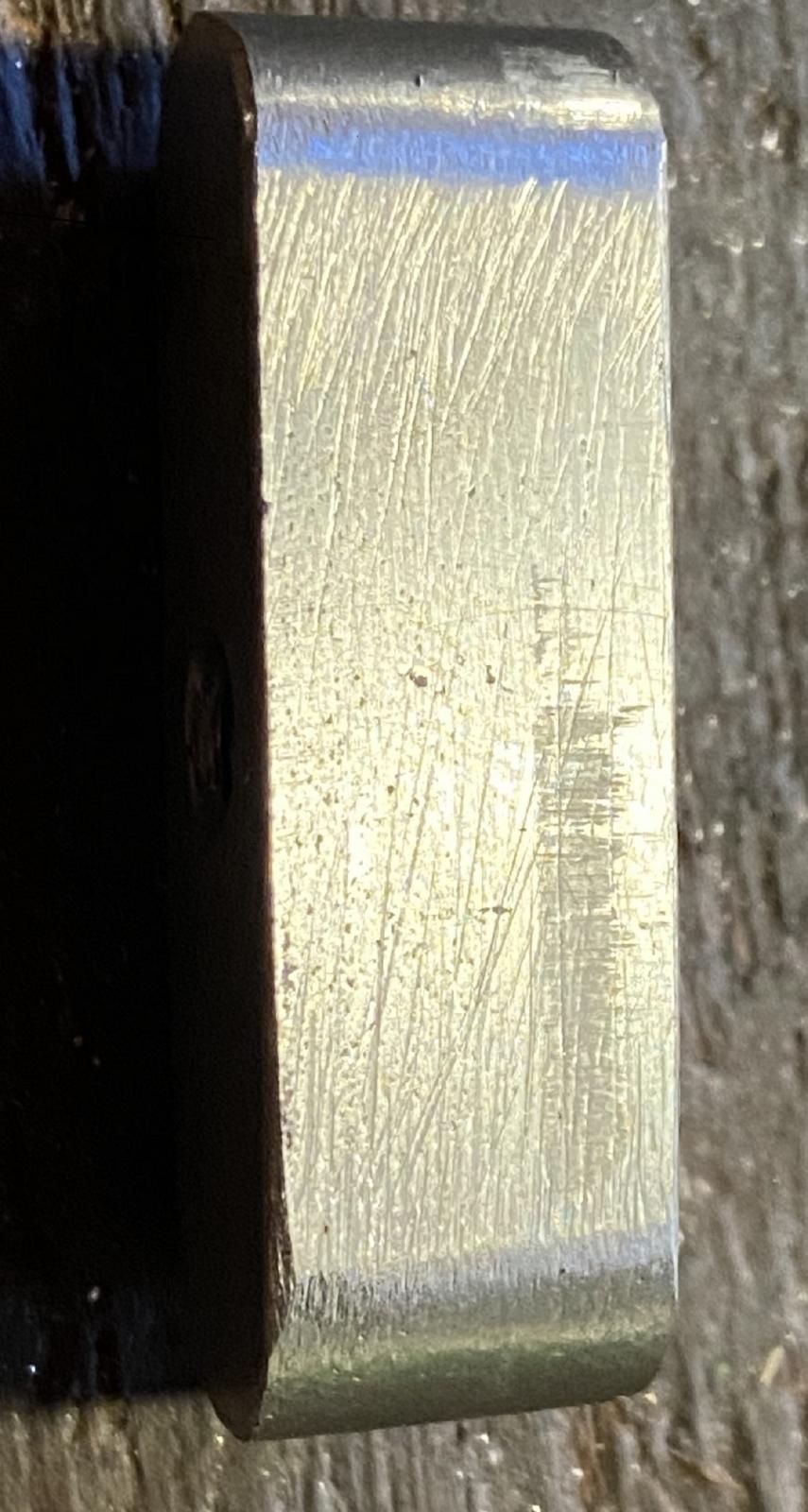

    Witness spots identifying high spots on key.

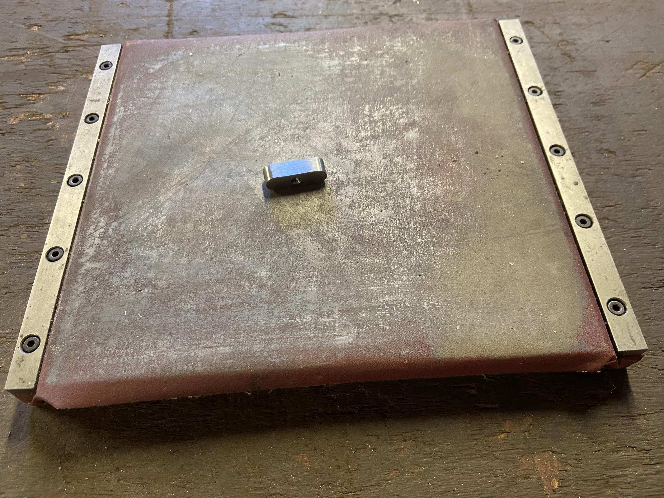

    The high spots are removed on the homemade lapping plate.Link to lapping plate: Recycled steel if you can find any.

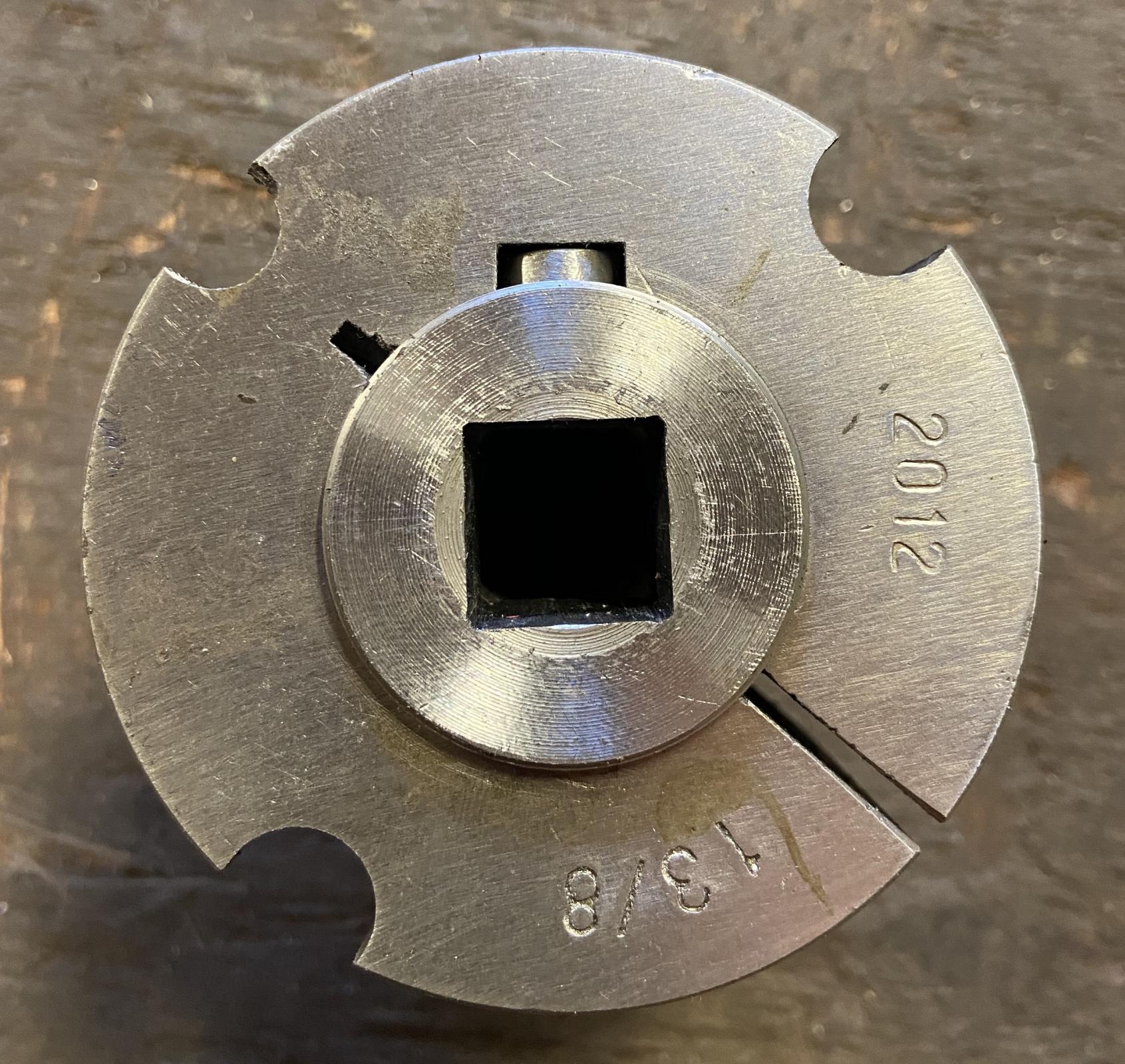

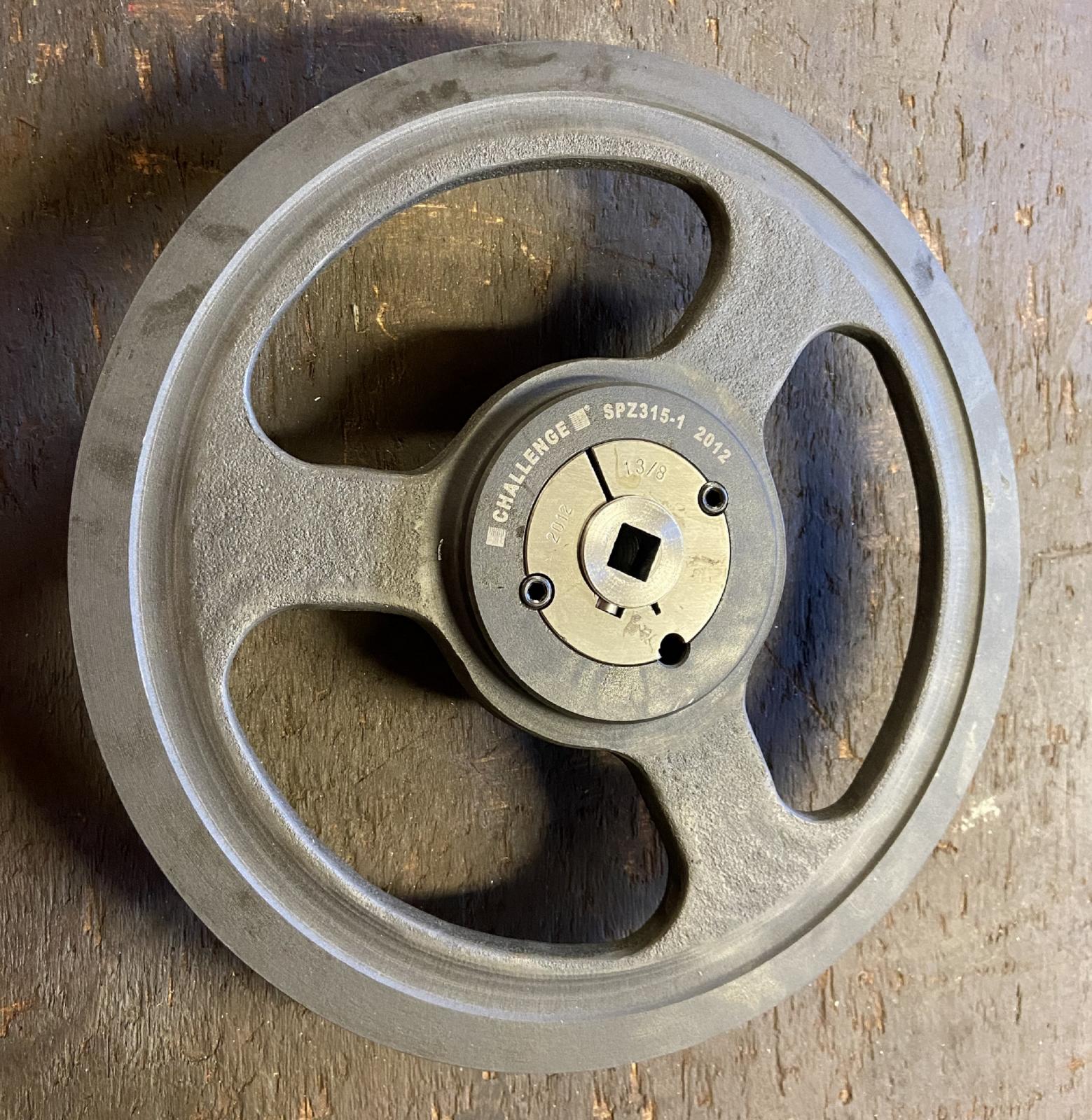

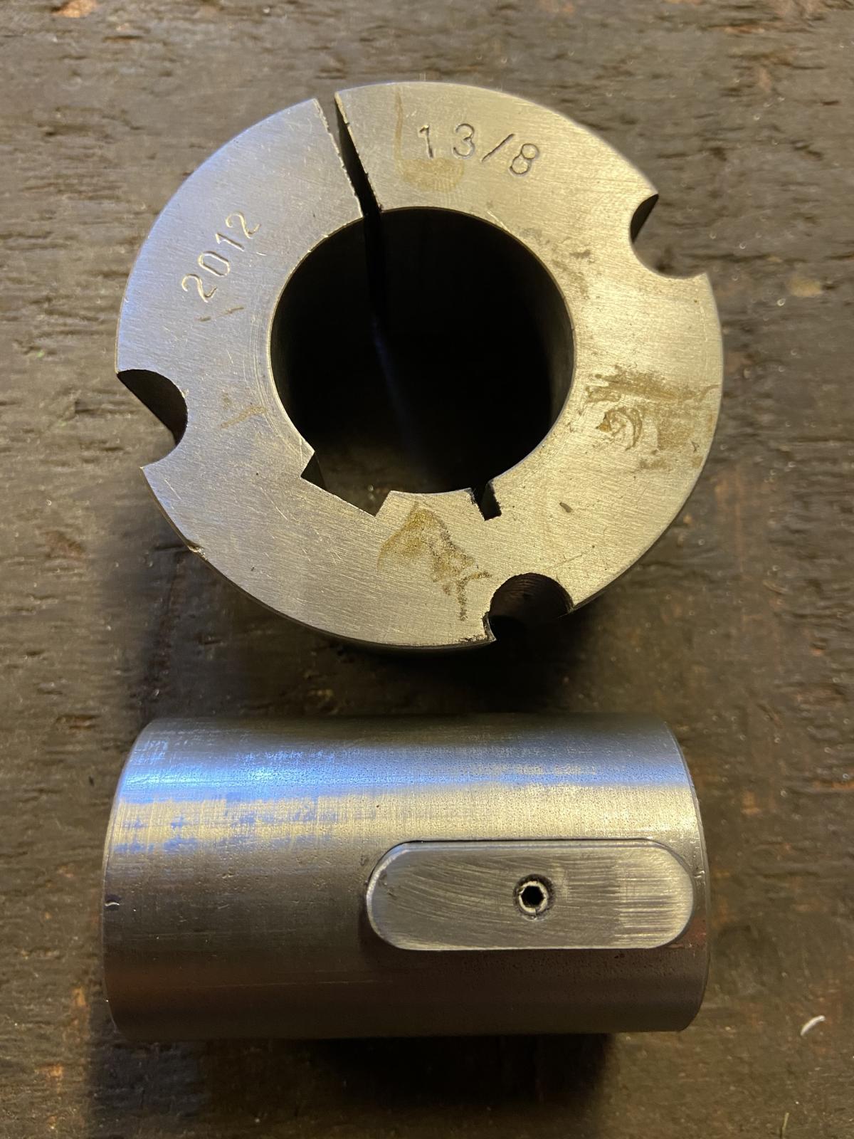

    Square drive coupling and key for taper lock pulley-taper-lock.jpg Square drive coupling and key for taper lock pulley-fitted.jpg
    Taper bush and adapter

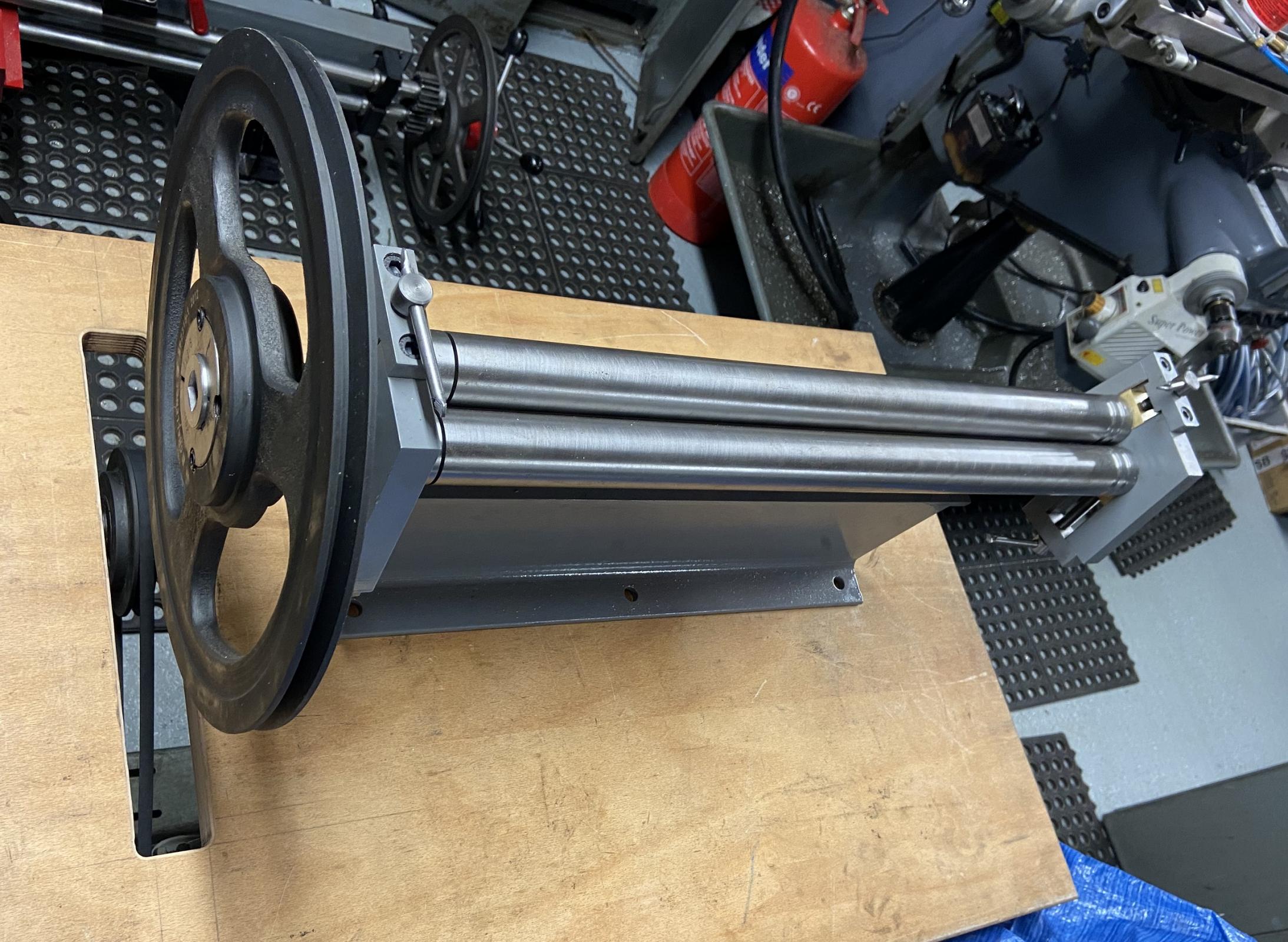

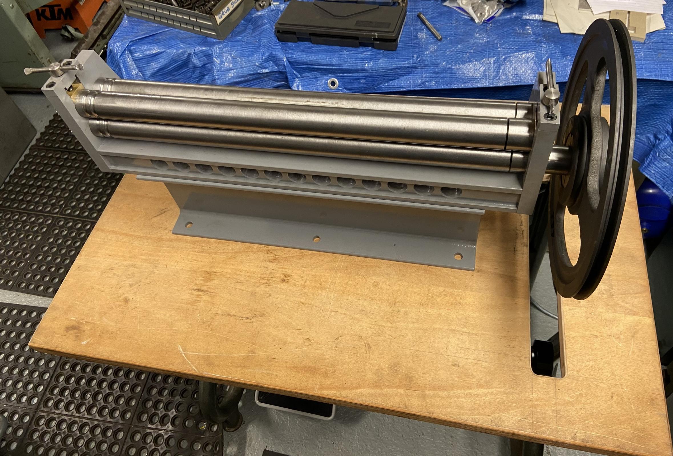

    Completed assembly ready to fit to slip rollers.
    Square drive coupling and key for taper lock pulley-front.jpg Square drive coupling and key for taper lock pulley-back.jpg
    Pulley pushed on slip rolls waiting to be positioned correctly and bolted to table top via M8 prong tee nuts.
