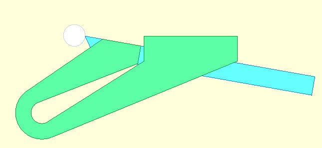

    If the theory is right, it should be simple for all of us to build a toolholder like yours and discard the troubles many of us have with parting off on the lathe. But wherever I look, parting off is not as simple a task as e.g. facing a piece of metal. There are many instances to be found on the internet that experienced people have broken their parting off tools, and even their parting inserts and tool holders, and not just on small and flimsy lathes. That is why I suspect that the cutting forces encountered during parting off are close to the limits of what is permissible, and that exceeding them will lead to failure in the form of excessive chattering or even broken tools.
    Thus my question to you: does version 2 operate on the wrong side of the tolerance margin, and version 1 on the right side? Is it the reduced stiffness of the spring in version 3 that allows for easy parting off, or do I need to consider the combination of spring stiffness and lever arm length to make a successful parting off tool? In other words, how do I extract myself from the mess I am in after having built version 4 instead of version 1 or 3, and fix my shining new parting tool so that it works as well as you have demonstrated a parting tool can work?
    You have the tool that can answer these questions, and all of us will benefit from getting these answers. I am not asking to destroy a working tool, I am asking to change a (hopefully still) existing, non-working tool into one that works. If my proposed action does not lead to the desired results, then it is back to the drawing board and the theory will need to be reconsidered. If it does work, you will have another parting off tool, and all of us will have a much better idea on how to build a parting tool holder that can be trusted to work.
    And, lastly, what I am dreaming about is a parting tool holder along these lines:
    (white = item to be parted off, green = toolholder, blue = tool bit)
    so that the pivot is forward of the work piece and I have an unobstructed view of what I am parting off. What I have is a basic idea, what I need are the facts upon which final dimensions can be based.

    That's a very cool idea and it might work great. You moved the point of flexing in front of the tool which would have similar effect as above I would think. Obviously a change in flex position is not the different between tool 1 and 2. I still feel that moving the point of pivot or flex is helps this type tool work better and yes, I think the first tool was close to not working and there is a slight difference between them. A few observation: The second tool works on smaller stock and or when the lathe is in back gear (very slow). If you are in the US I can ship you the first two if you want... you can keep them. One more idea I had was weld and extension on to the arm that flexes and add a weight. I think resonance is huge with any cutoff and this would change the frequency.
