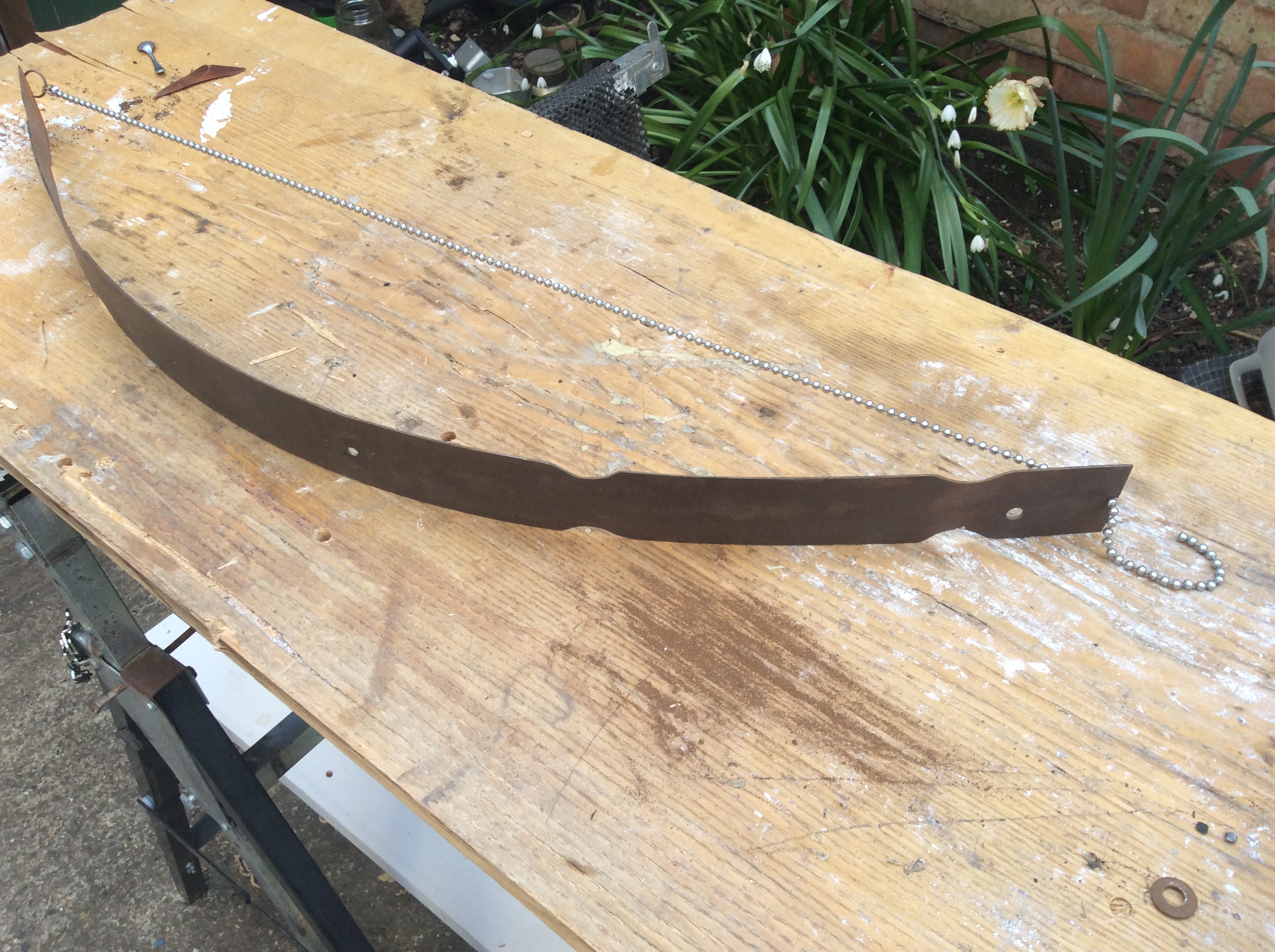

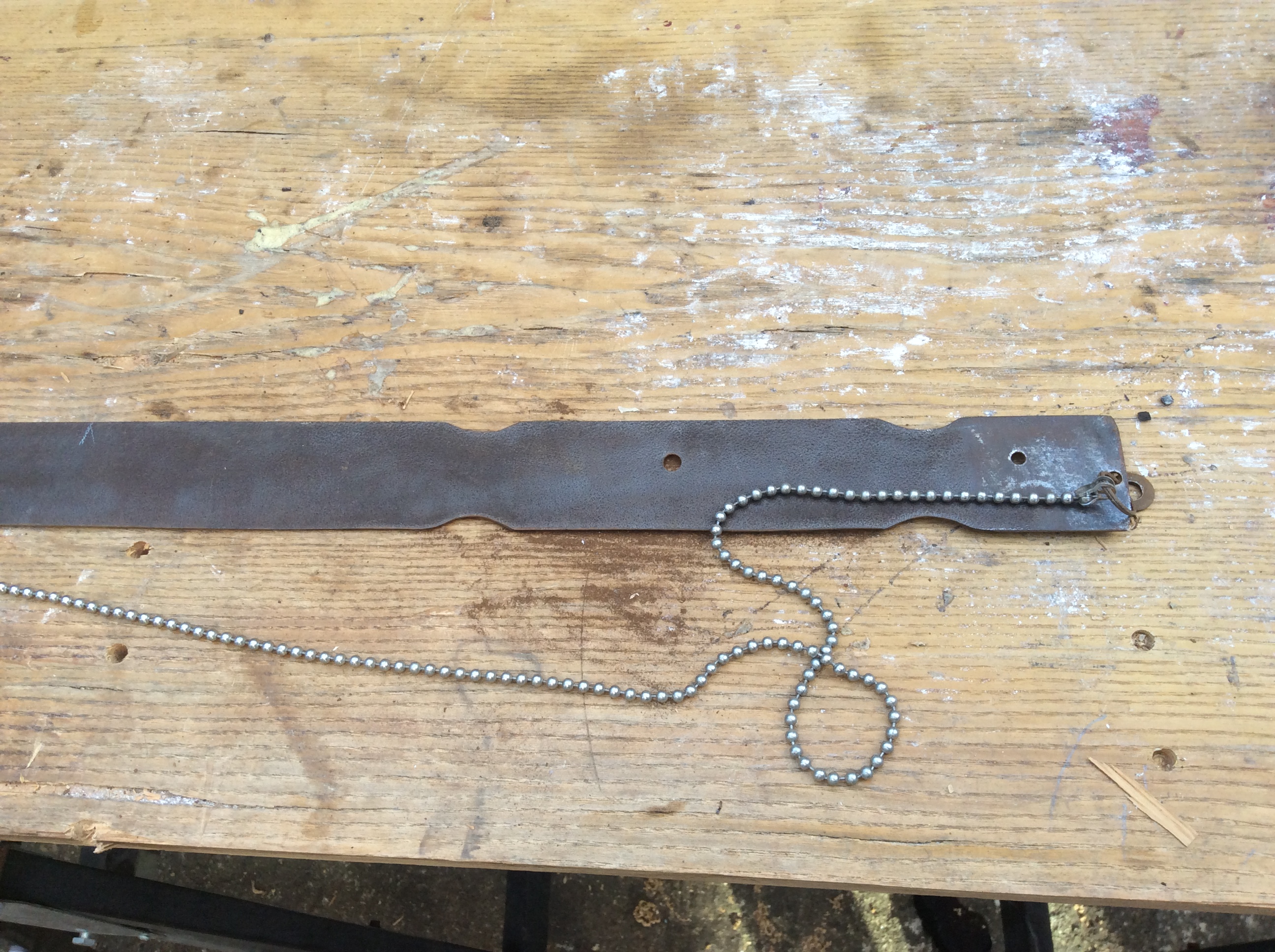

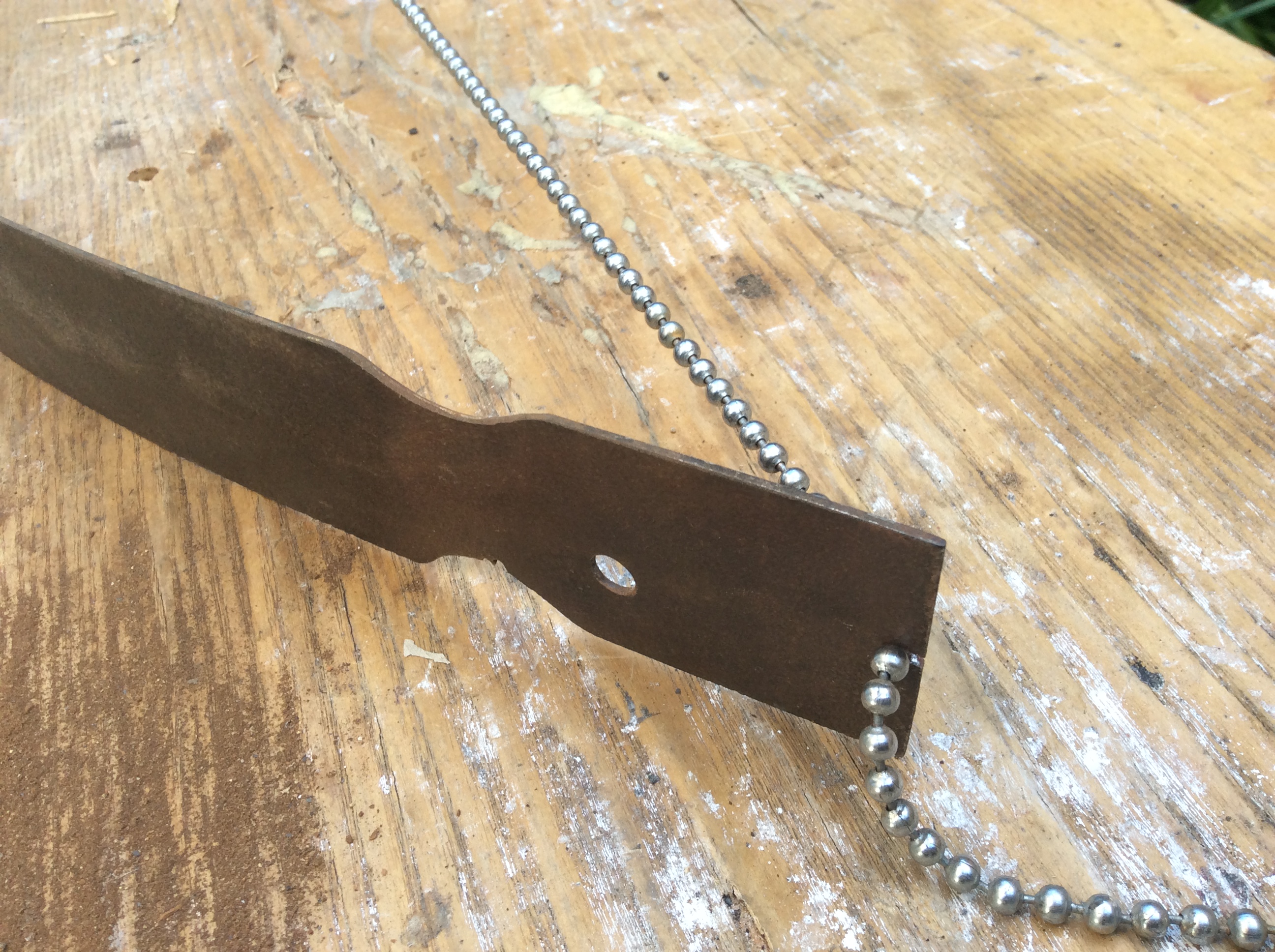

    Spring curve marker
    Sources for this idea came from “Fine Woodworking” contributed by Floyd Lien and from Robert Wearing’s book, “Woodwork Aids & Devices”.
    The spring is in its 3rd incarnation. It was cut from a logging saw to make a spring return for my hydraulic press, hence the notches. The chain is that sort which is used in bathrooms. It is strong enough to hold a reasonable tension, but if I wanted to form a sine curve with it, I would need something stronger. This makes it adjustable. If I wanted to repeat the curve, I would just mark the ball where it is inserted in the notch at the end.
