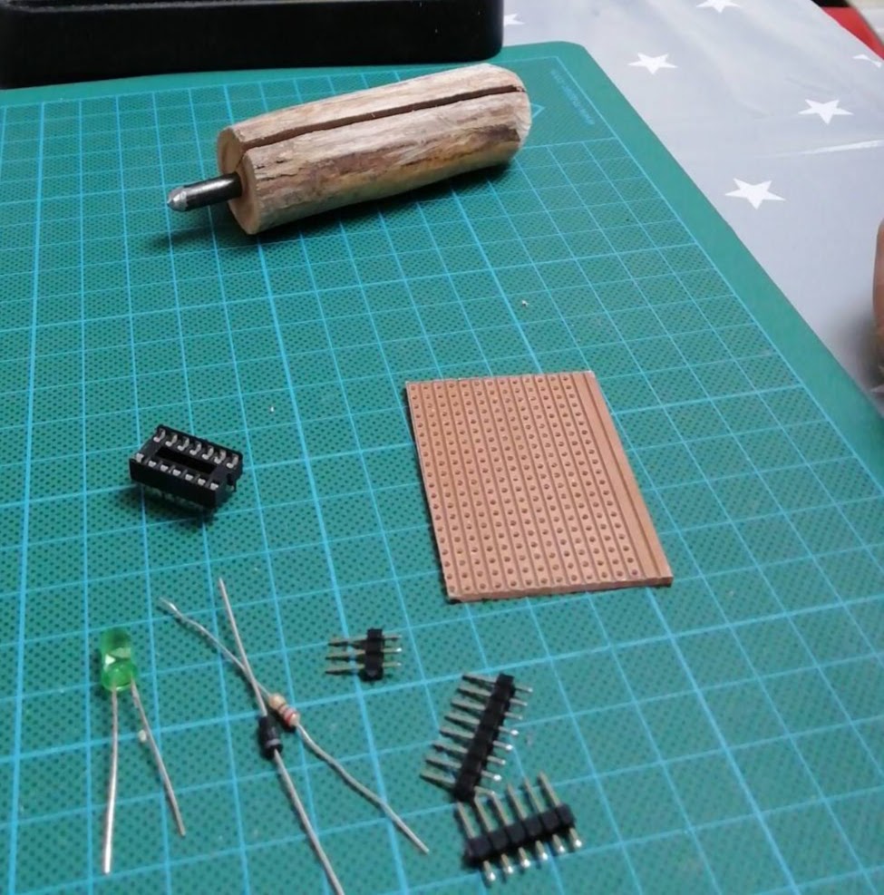

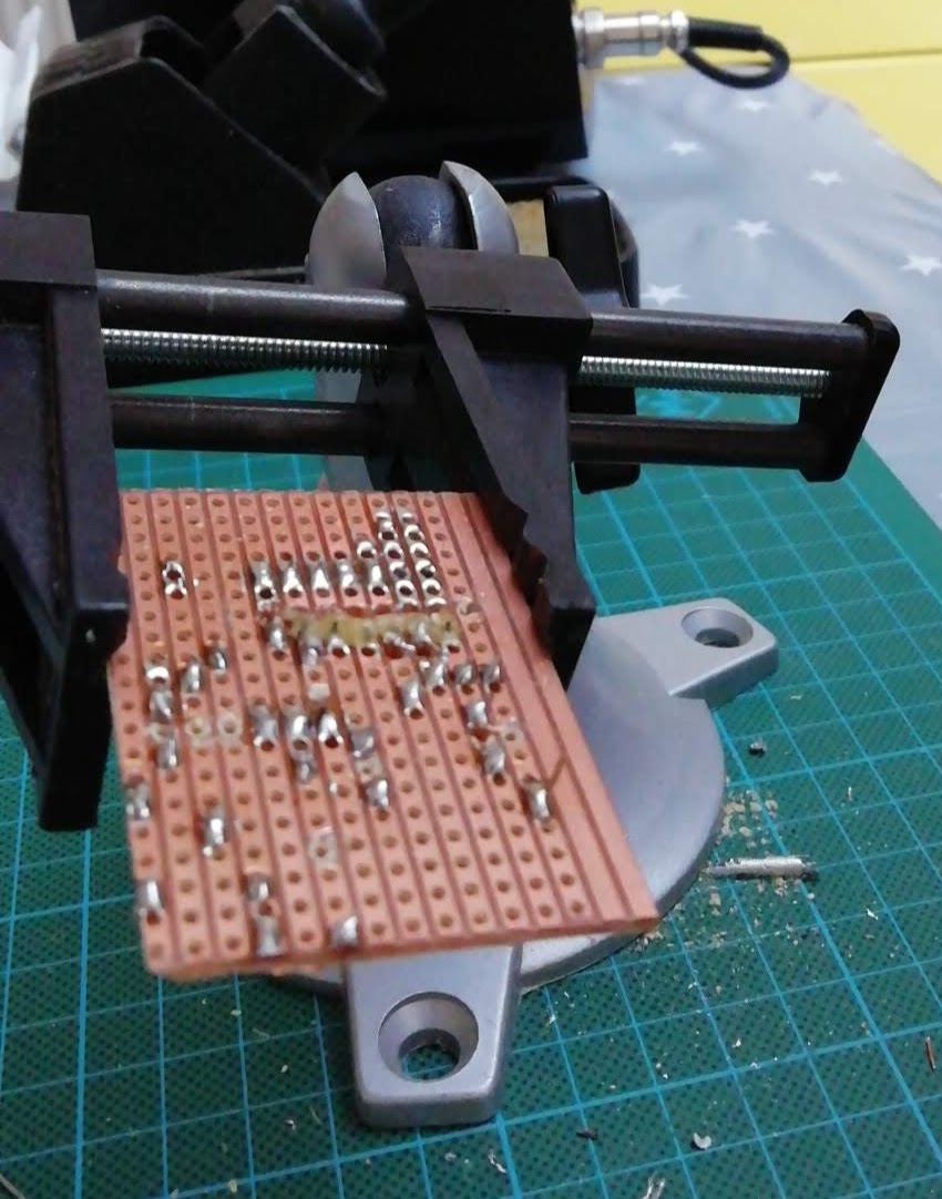

    I was making a stripboard project for a magazine and wanted a quick and easy way to make the cuts in the tracks. So I made my own spot face cutter from an old drillbit and a bit of old branch from thee garden.
    Spot Face cutter-img_20200415_162528.jpg Spot Face cutter-img_20200415_172853.jpg
    https://www.workshopshed.com/2020/04/spot-face-cutter/

    Vector makes an expensive tool for cutting these traces. Well, expensive compared to a standard drill bit. I have been using drill bits for this for years. I put a 1/8" bit in my drill press and set the down feed stop for the correct depth to remove the trace. That takes a few trials. From there, I just mark the places to break the traces with a marking pen and drill away. The hole in the board centers the drill bit very well and the 1/8" size bit cuts the trace with a wide enough break so that solder will not bridge it easily but it does not touch the neighboring traces. Works great.
