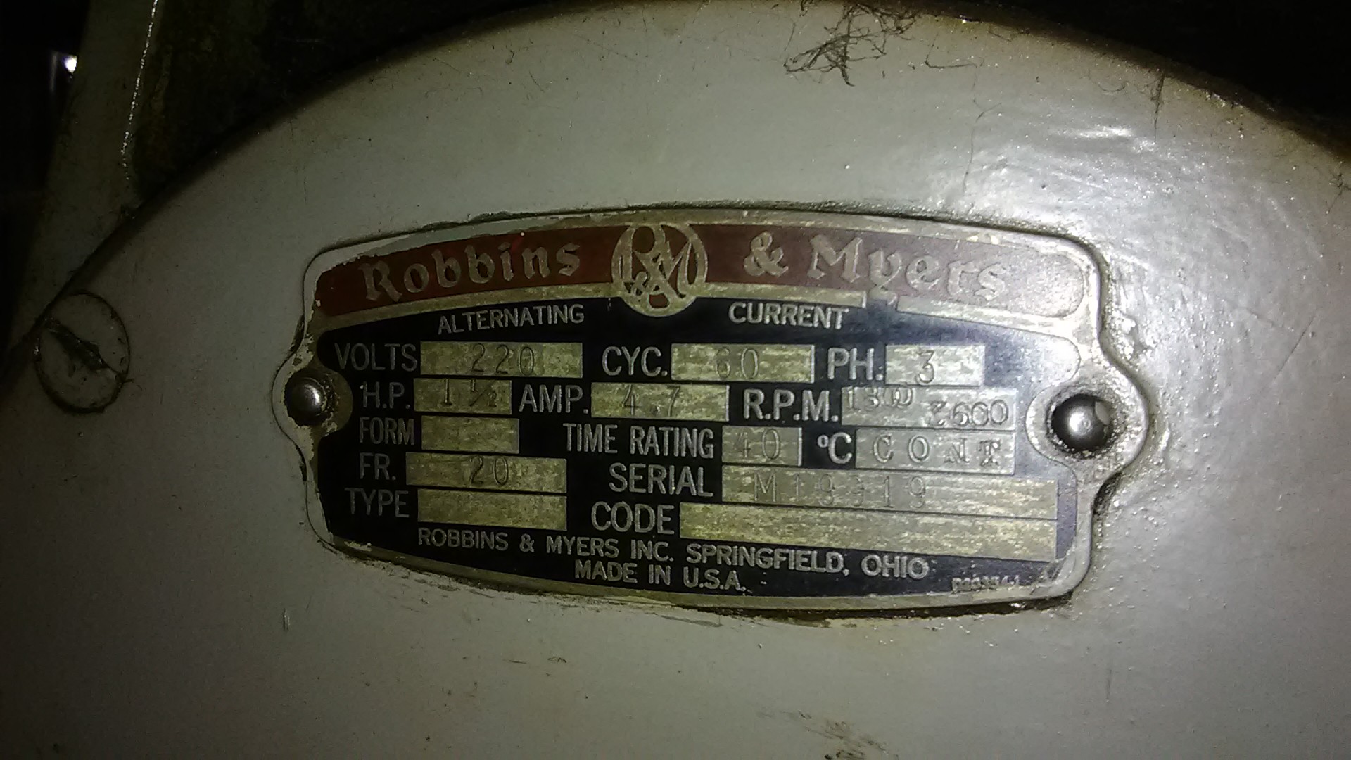

    Tony's 'bushed washer' for bench or pedestal grinders seems related, to an odd surface grinder application.
    Lots of surface grinders carry 1.25 [31.75mm] ID wheels. Generally the wheel shroud/ guarding indicate largest wheel diameter, zillions are 6", 7" and 8". Average surface grinders, 5" x 10", 6" x 12", 6" x 18" use them, and lots of cutter grinders can. If you examine wheel catalogs, their prevalence is clear. . .
    Between ticket work, I'm trying to get their shop more operative. Let's just call it a Herculean task. Like horizontal mill I've run, until riggers dropped it about 20 inches. . .but wait; there's more!
    You know when someone thinks out loud? I'm writing the same way, working out day-end events. Follow along while I ramble.
    For a reason I have no explanation, what look like comparable sized machines still have 1.25 arbors; inside a 12" shroud! Puzzled, I've looked for 1.25 x 12 wheels, knowing they'd be rarer than hen teeth. Yeppers, none found.
    Examined the machine further, this case happens to be an auto-feed Thompson, cast iron everything. Even the base, with cast-in baffled coolant reservoir. Tag indicates a single voltage motor, but capable two different RPM 1500 and 3000, by switching leads [not direction, or change 220/440, RPM only]. Smaller wheels, higher RPM's. Bigger wheels, lower RPM, increased diameter creates the effective FPM [Feet Per Minute].
    Our wheel storage is all 6 inchers, and one 8, still 1.25 bore. In a box of grinder stuff [I found], a weird looking bushing [I think] like Tony's but slightly different [I guess] for the 'front' of the wheel. 12" wheels are 3" bore. This spacer [steel] is 3 plus, maybe someone didn't finish it. I have to look, yes spindle is 1.25, but outer washer is larger than a 6", 7" or 8" would use, probably spindle flange is too? Checking that tomorrow.

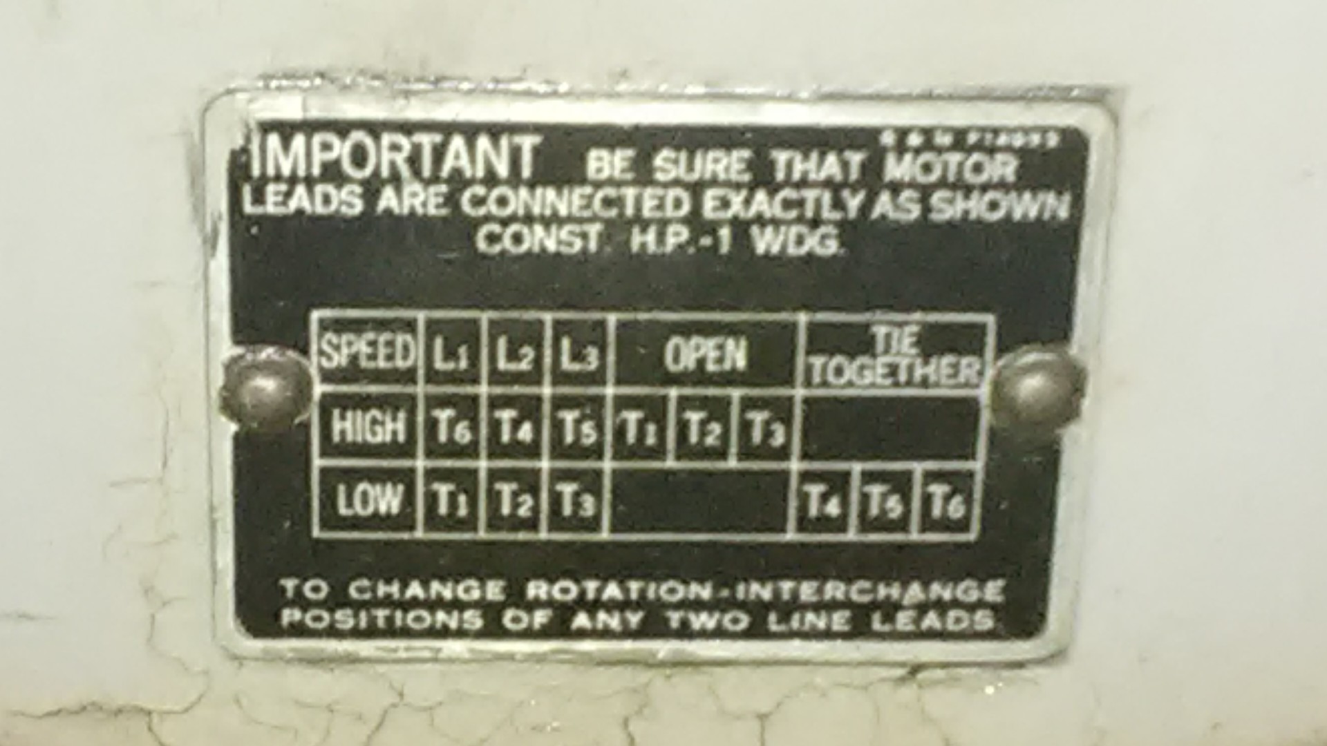

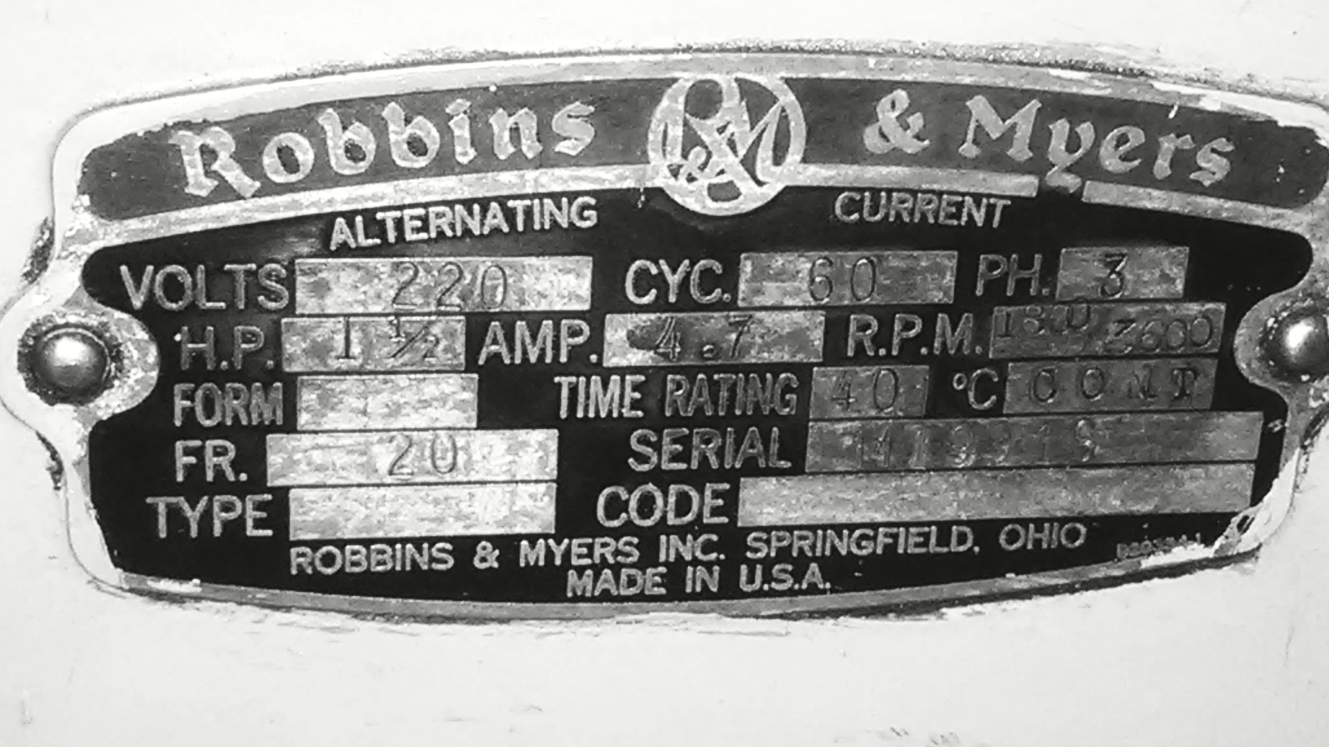

    3000 rpm motors have two poles, 1500 rpm have four poles. Sometimes you find a four pole motor where all the winding connections are brought out such that with a bit of switching it acts like a two pole motor.
    These two speed motors can be very useful on a machine tool, lathe or mill, because you can run at half speed with near double the torque compared to running a two pole motor at half speed with a VFD. This can often eliminate the need for back gears to go slow with high torque.
    I had a lathe with a motor like yours 2/4 pole, I kept the motor when I scrapped the lathe (the bed was worn right down in one area due to its previous life) and I now use the motor on my shock absorber dyno. It is driven by a VFD but being able to switch pole numbers is handy.
    Your motor must be 50 Hz not the US 60 Hz. The synchronous speeds for a 60 Hz (US made or sourced motor) would be 1800/3600 rpm. So under rated load yours should spin at around 3450/1725 rpm with reduced torque on American electricity or 2850/1425 rpm at specified torque on everyone else's electricity.
    All the above assumes an induction motor.
    'We' are correct; me barely, Tony accurate.
    In my defense, the tag was very hard to read until cleaning it better.
    RPM 1800/3600 60Hz 3PH 220V 4.7A
