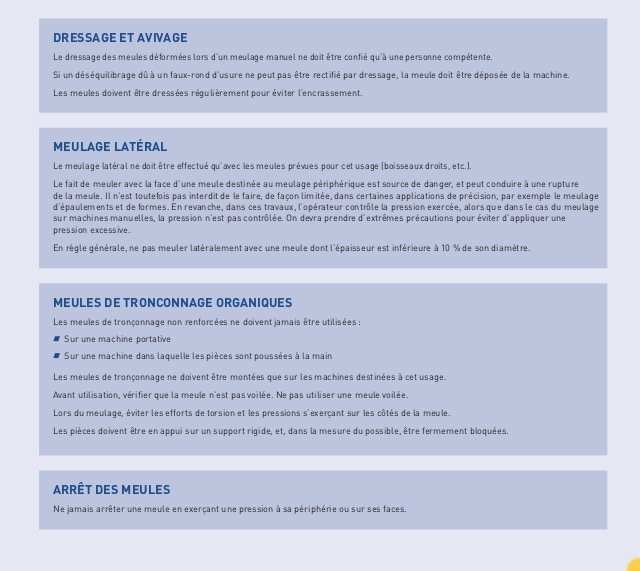

    I'm not totally in accordance with Tony's explanation, they are grinding wheels made as cups(or others for 45° use) for grinding on the lateral part, all makers of grinding wheels explain that you never use a wheel made for perpendicular use as a lateral use, you find it that on makers like Norton, I've only the french catalogue from Norton but you can found the same in english on the web easily.
    They explain to never use on the side a wheel cup or another when the thickness is less than 10% of the diameter, then 30mm. for a 300mm. wheel etc…

    Just as Tony and others describe, side-wheeling on bench grinders is not unheard of, and safely pursued by a sizeable group of workers. That manufacturers advise against it, has at least two faces. One is a wheels design intent, coupled with how its made. The other avoids litigious involvement with a careless public, and government agencies.

    I didn't give any explanation, I asked a question which has not been answered yet.
    WHY should I break the habit of a lifetime and stop tool sharpening on the side of flat wheels?
    As advised I looked on Norton's site but the only relevant text that I could find was a list of DOs and DON'Ts. The DON'Ts said avoid the side but without explanation.
    I have never been very good accepting DOs and DON'Ts as plain statements, but I will always consider an explanation. When someone tells me not to do something I expect that they will know WHY and be able to explain it to me. So far in this case the WHY is lacking.

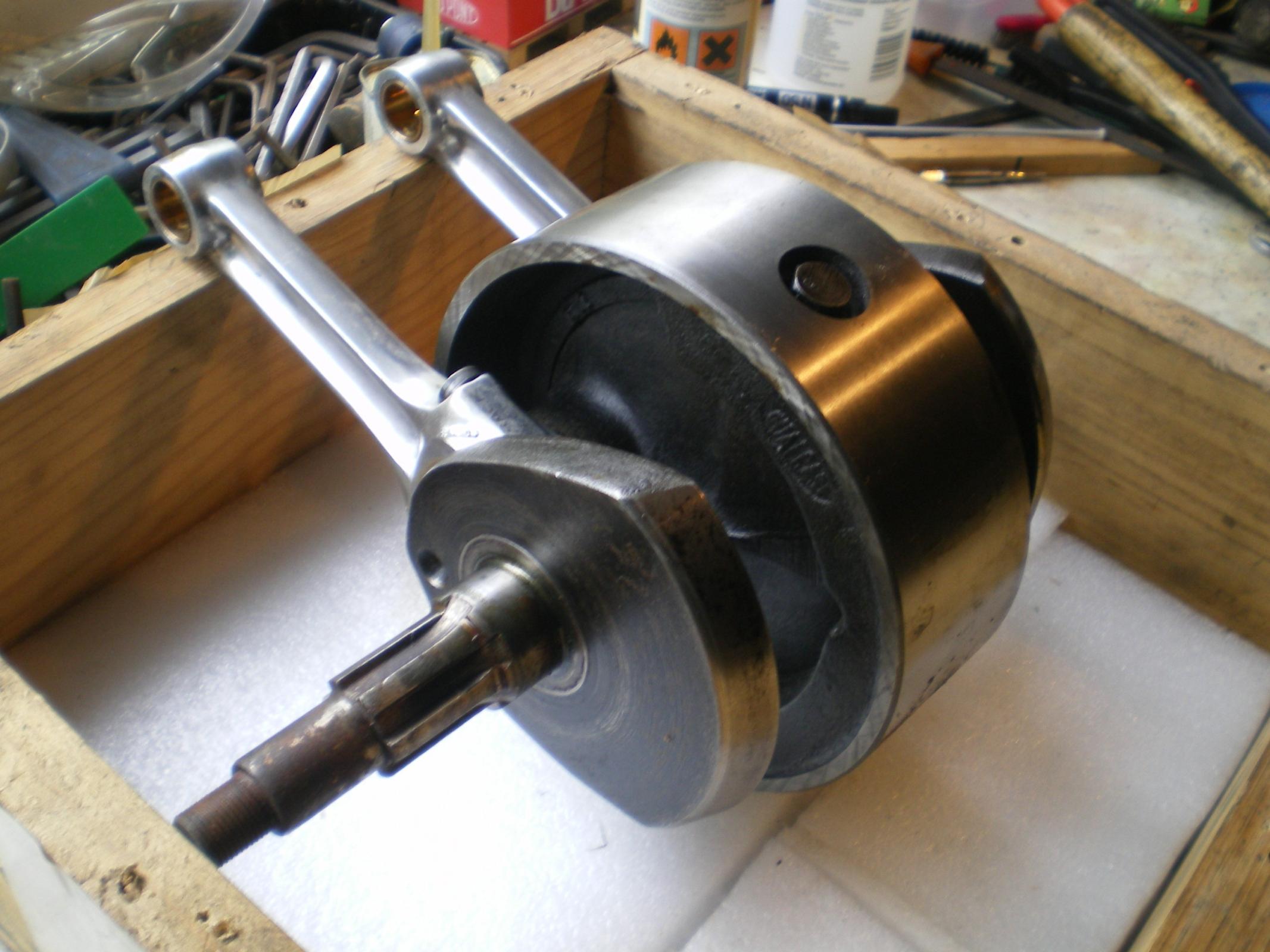

    Grinding with the side of the wheel is accepted practice in machine shops on both surface and cyl machines. The wheels are usually backed of by hand to leave a ragged edge to prevent burning of the material. The flywheel assy shown is an example where the edges have a cross hatched finish, this was done with a 12 x 1 inch wheel. Split Point Drill sharpening-crank.jpg
    These wheels are available already dished for this purpose.
    For bench grinders the only way to get a flat face instead of a concave one is to use the side of a diamond trued wheel with common sense pressure, same goes for any freehand use. Any protection is a personal choice unless instructing beginners, probably best to agree to disagree on this subject.

    We are cutting hairs in four to translate from french, excuse-me tony if i use explanation in place of writing or similar.
    I'm always working with the idea to transmit goods infos to the apprentice and to use safely the tools etc…, the question on "why" can be easily found on every book for mechanical apprentice when it was authorised to use some tools before CNC, as I've not read the more recent edition, I suppose they explain simply that if you have your piece entrained by the wheel in the protection carter it's about 90% more chances to see the wheel broken that on the good side.
    If it's not necessary to use specific wheels, why making so many cup wheels(and a lot of others forms) witch are a lot more comfortable and with a lot more efficiency than plain ones ?
    After that, if you want to make the same manner you use the tool since decades, it's your business, but they can be others ways to arrive at the result needed more safely.
