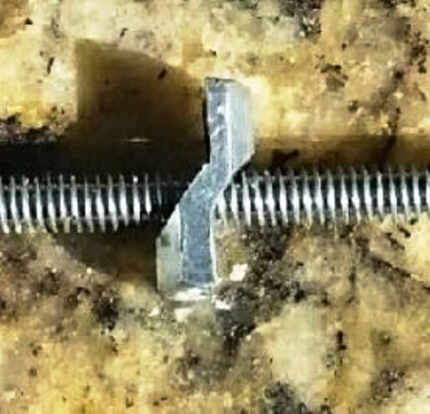

    The only problem I had with making them is milling off the wrong side on the second cut. I had to go to the hardware store twice more than should have been required.
    Some quality time with needle files is also required to get them operating smoothly.

    You could have used one of these, they've been around for years: https://www.mcmaster.com/slip-on-nuts

    I'm guessing you cross drilled a clearance hole through the coupler first. Then milled the appropriate portions of the sides away. I like the idea of a washer with a recess, too. Looks like a very handy setup.

    I guess I should have mentioned that the end which bears against something else goes into a washer with a short recess bored to prevent the nut from flipping outward and disengaging from the threads. As soon as pressure is off the nut then it can be opened and moved.
    I have looked at this a dozen times and could see the principal.. so I spent a half hour of my life to make one- took a bit of drilling and rattail file work to make functional but then I wondered how to keep it engaged. So thanks for your comment- I love creative minds and you, Sir, have one. Gene

    One can also weld this up from two half-nuts.
    I'm thinking of a vise that has a lever on the side that engage and disengages this 'flip nut' so one can quickly move the dynamic jaw.
