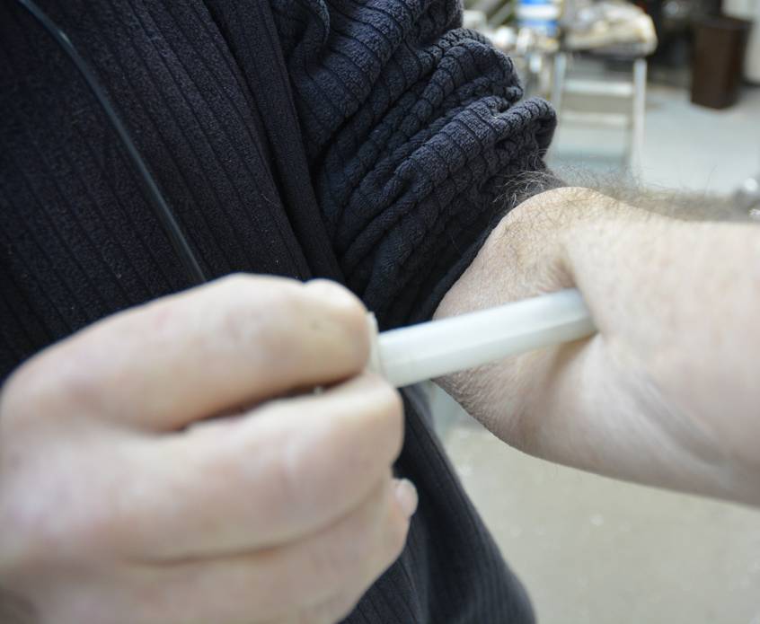

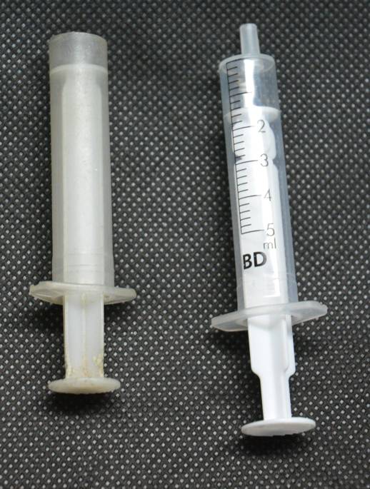

    I got a metal splinter this morning which I could feel (badly) but I couldn't see it even with magnification. I have a solution that I only need to use on those hard to get with tweezers. I use the same tool very often for insect bites.
    Splinter tweezer magnifier-dsc_0637.jpg Click image for full size
    As shown on the left I cut the end off a syringe as shown right.
    I depress the plunger, press it over the affected area and pull the plunger to the end. This creates a partial vacumn which sucks out whatever the mosquitos leave behind and stops the itch, the bites generally heal quicker. It works best the sooner you do it after the bite. One day in desperation I wondered if it would work to extract splinters. So far it has never removed a splinter completely but in all cases it has pulled the splinter out enough to see it and get tweezers on it.
    Mode of use. Depending on the location of the bite or splinter it is sometimes impossible to operate the syringe one handed, I often use my teeth to pull the plunger, but sometimes you need an assistant.
