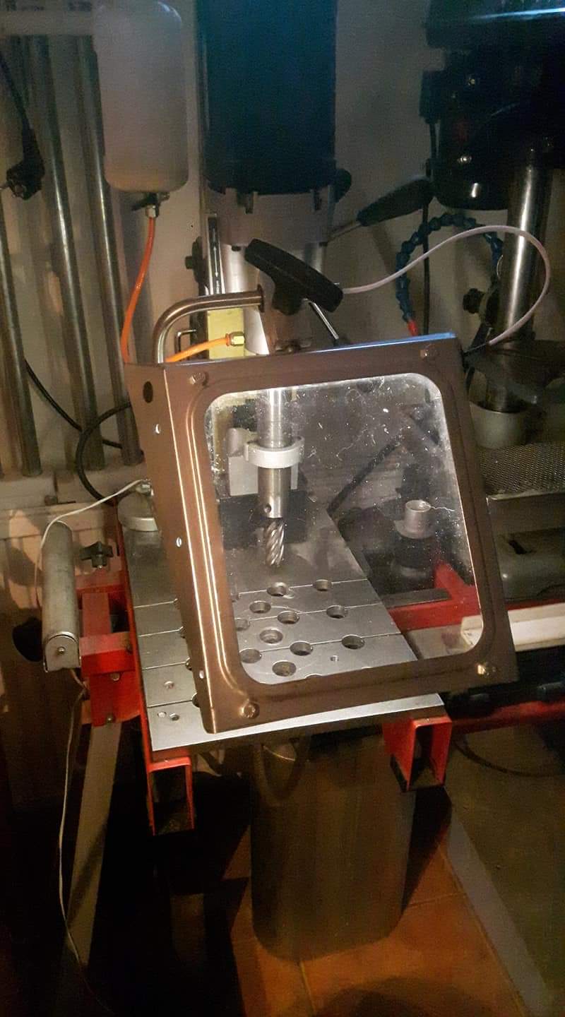

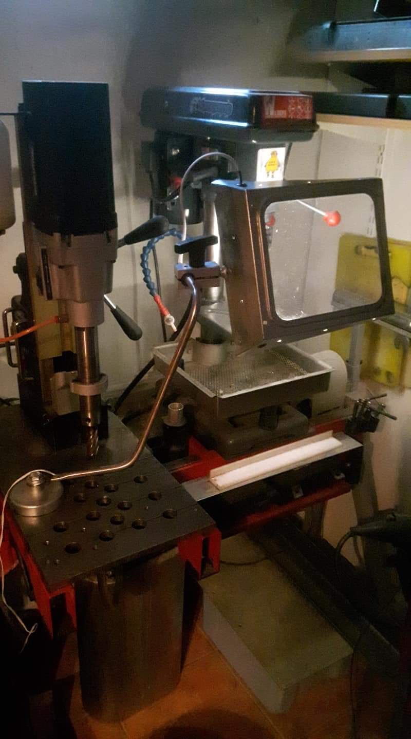

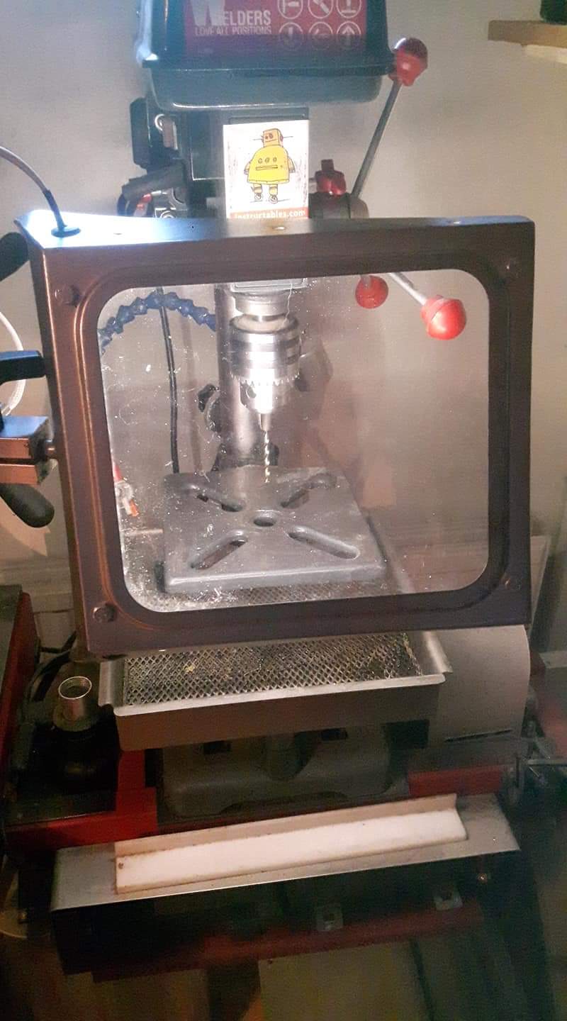

    Splash guard..
    Splash guard with light.
    Light comes from led-stripe.
    Connected to table with strong magnet.
    I use it with dremels / rotary tools also.
    Specially tungsten carbide cutters throw annoyingly sharo splinters.
    Because use of magnet for mounting, its easy to remove or turn a side if its on the way.
