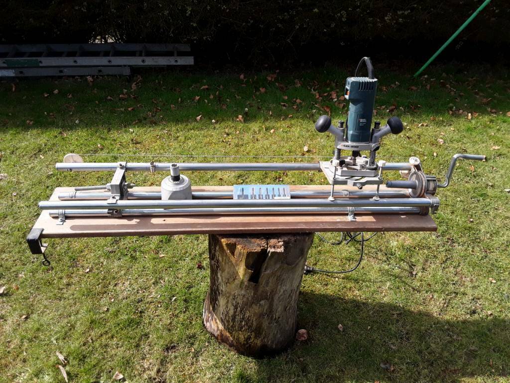

    Because there seems to be only one lead on the spiral, or 5 or 6 start screw and not disengaged, dividing is achieved by the little rotary table on the face plate.

    There is a 'Router Lathe' that was common late last century that was used for making table and chair legs among other things.

    The type I recall. Never saw one demonstrated; did changing spool ratios generate a different helix? How was dividing managed?

    "did changing spool ratios generate a different helix? How was dividing managed?"
    I spent some time trying to find the instructions,(with diagrams),that I have somewhere without success. From memory the drive plate had multiple divisions like a dividing plate and there were different size pulleys to alter feed rate. They had a sliding guide bar for doing tapers and the more complicated ones could trace curves as well.
    Not a lot to them but turned out lovely repeatable work fast.
    I only know this because I had a friend,(now passed),who made high end custom furniture and he used one to great effect.
