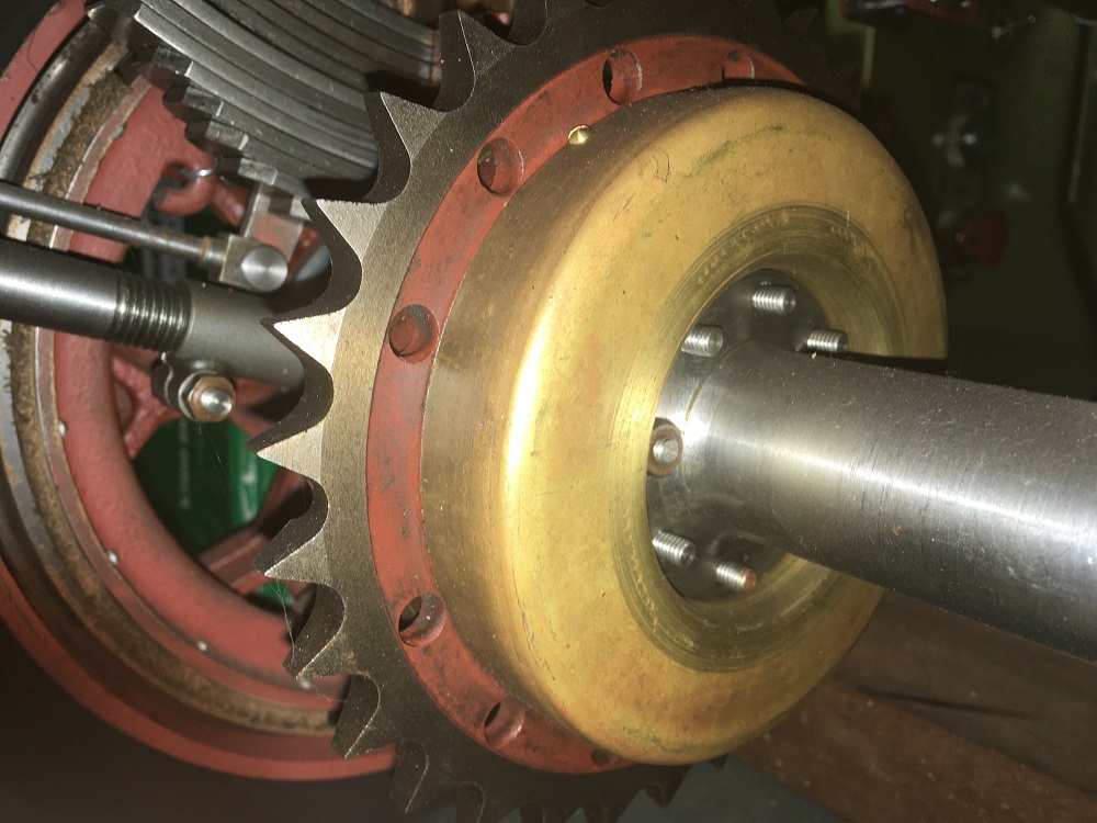

    The photo below shows one side of the diff with the completed brass cover in place.
