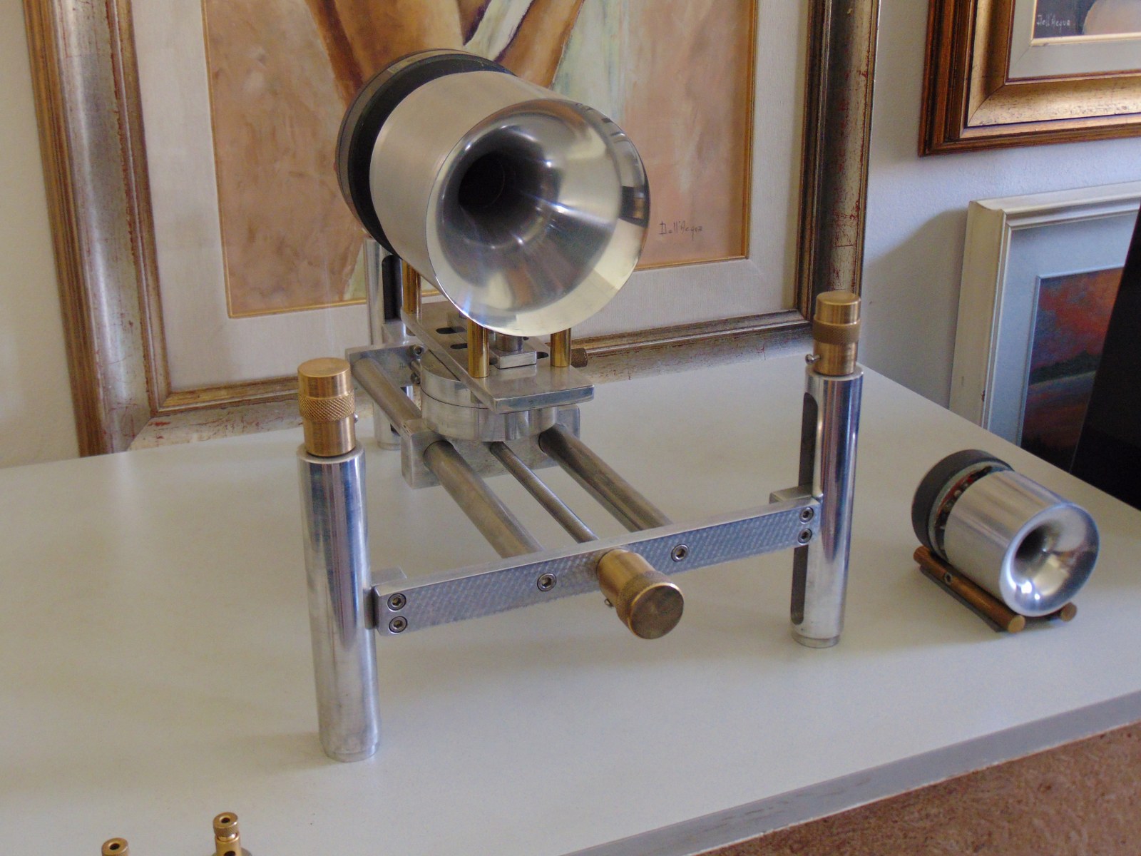

    Thank you for advices! It seems not an easy job to do, I havn't considered the possibililty to break the aluminum. I'm curious to see your tools and setup also!
    I'm thinking about using plaster for a prototype, having a couple of horn finished and polished it would make a good mold (and a new polishing for sure). I'm so undecided about.
    The big horn is the object I would like to duplicate
