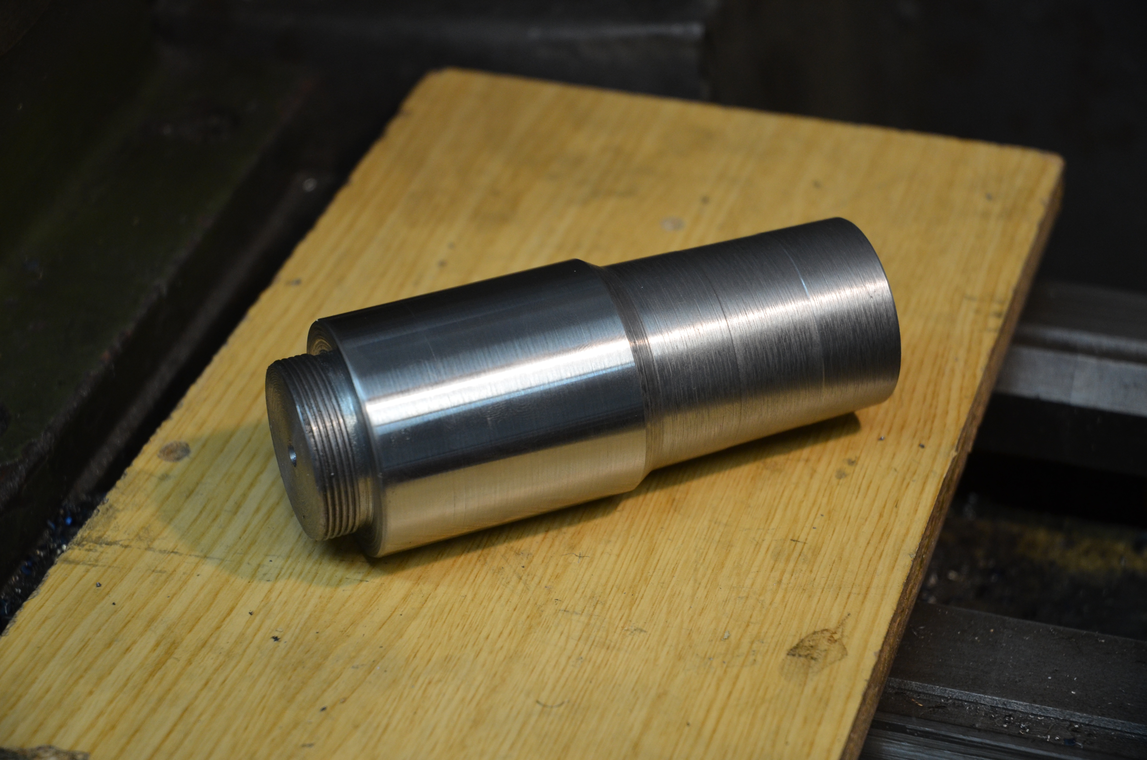

    Hi folks
    I recently scored myself a brand new Indexa Seiki facemill for very little on eBay and while it was a deal for the money, it didn't come with an arbour, so I figured I would make my own, though I will be deviating just a little from the standard design by omitting the taper shank and after taking measurements from the facemill, I eventually drew up the plan below (see attachment for high res version).
    The main reason for the change is that my mill's drawbar is only 9/16" in diameter and rather prone to malformation when attempting to dislodge stubborn MT2 shanks. So instead, I plan to bore and thread the arbour to fit the various spindles I have in my workshop, which are all the same size and tpi.
    The advantage of going this route is that the arbour will be concentric to the spindle during the turning operations, once the initail drilling, boring and threading operations have taken place.
    Here is part 1

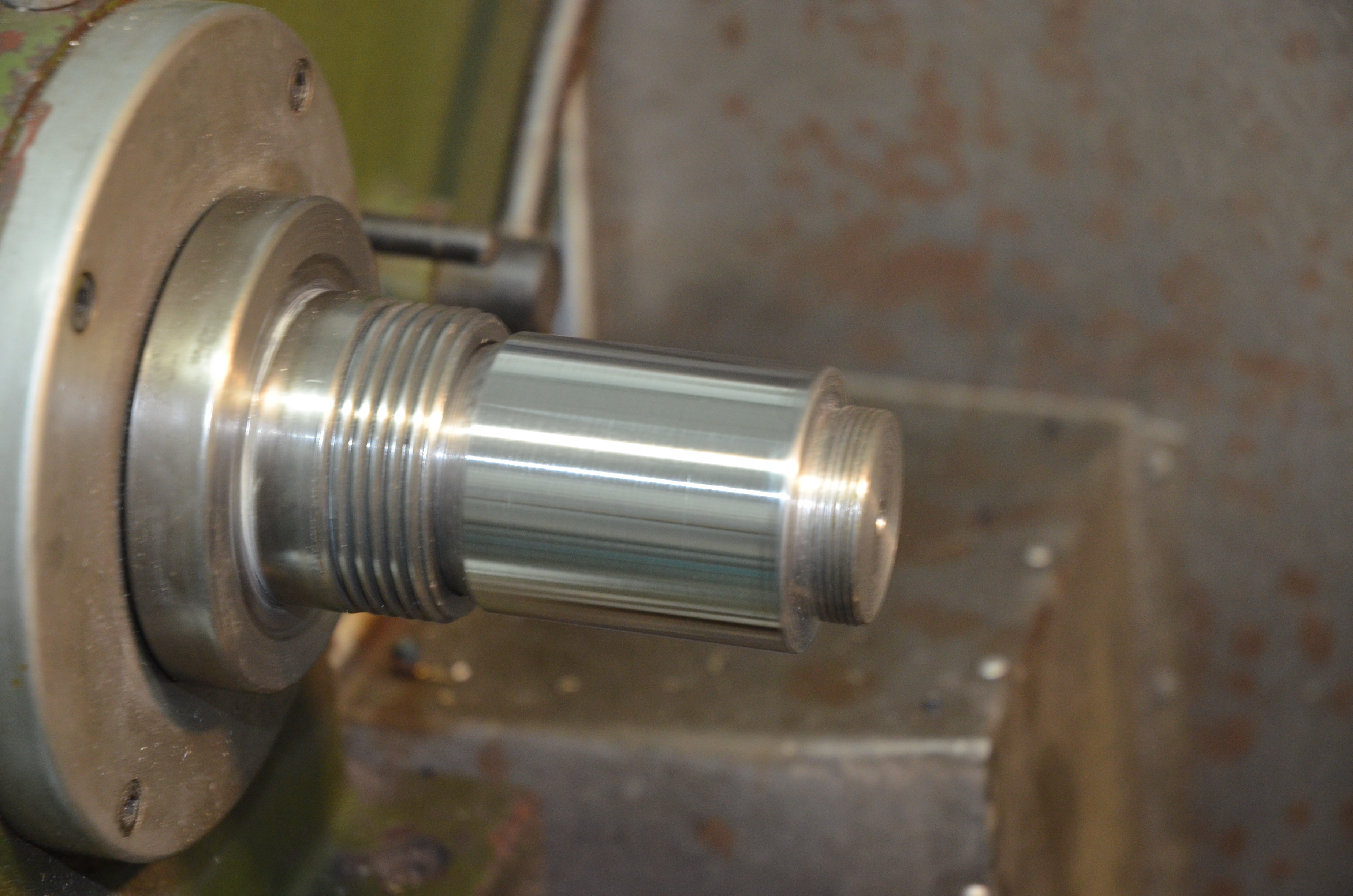

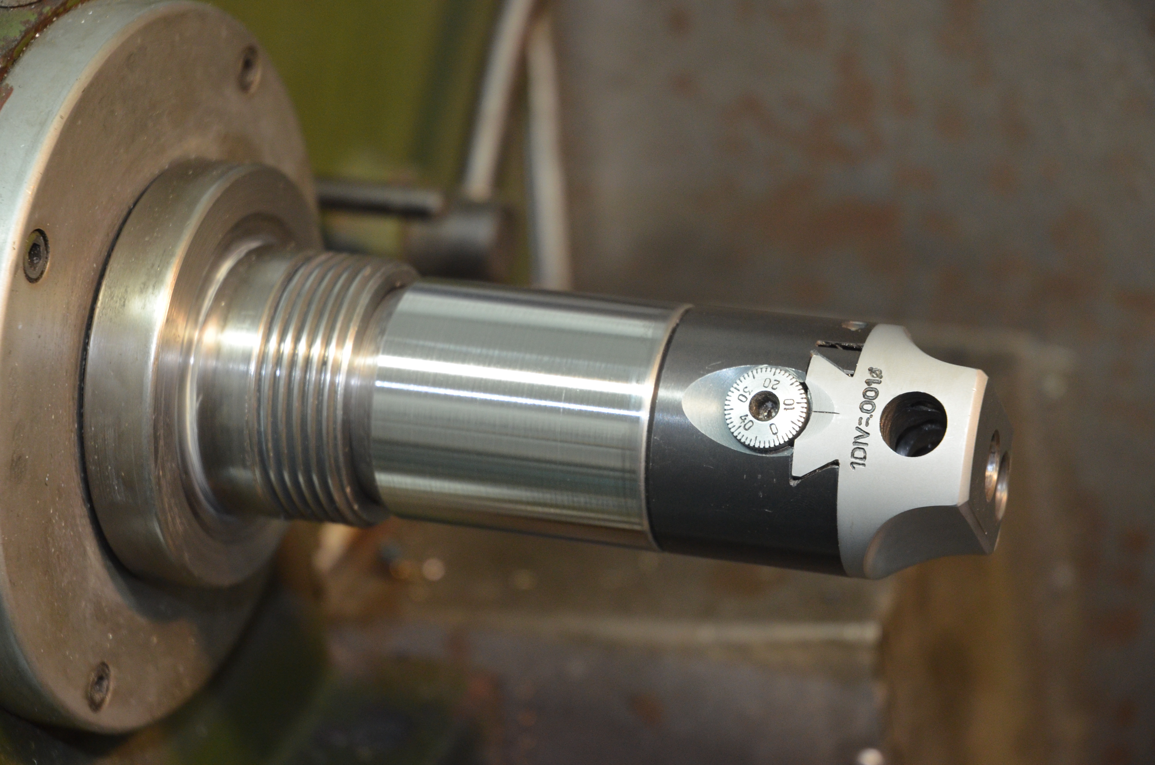

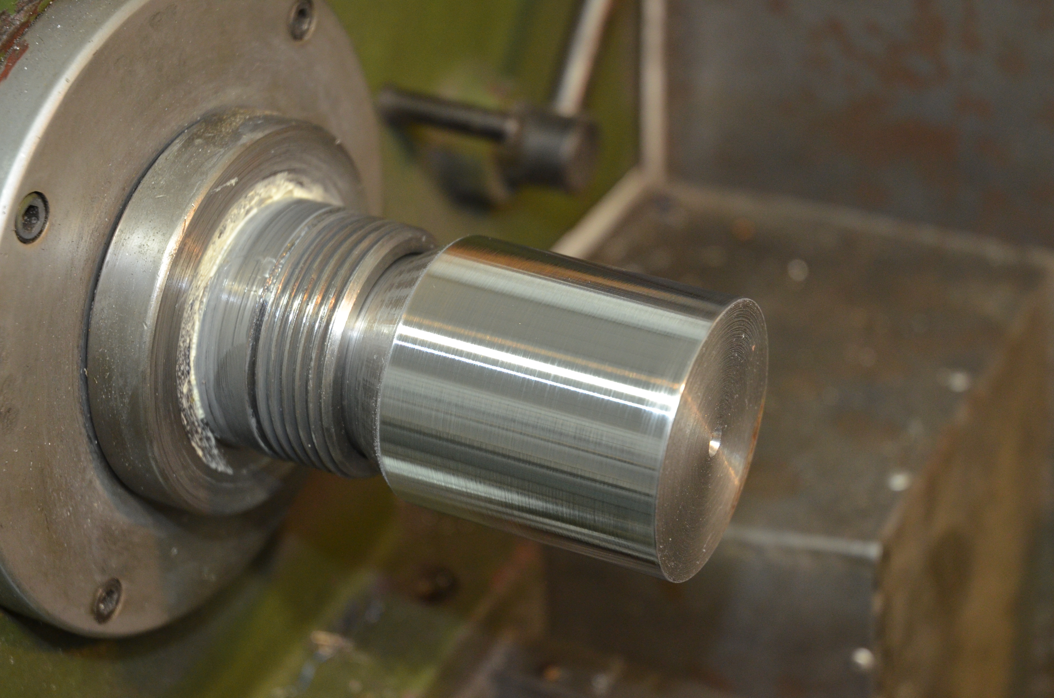

    Canobi,
    Great job as usual. Rigidity is so important in tool holders and yours looks to have plenty of that. I made something similar but dedicated to hold an adjustable boring head. The end fixing was different to yours because the boring head was screw on. The nose of my lathe has a beefy MT5 taper so the whole assembly is very rigid.
