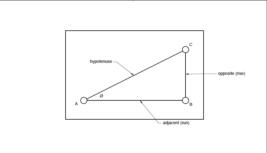

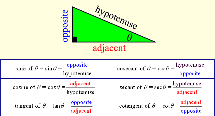

    First of all, this graphic summarizes most of what we need to know about trigonometry:
    (I printed this picture and I keep it handy for reference.)

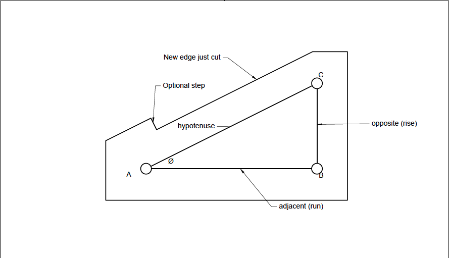

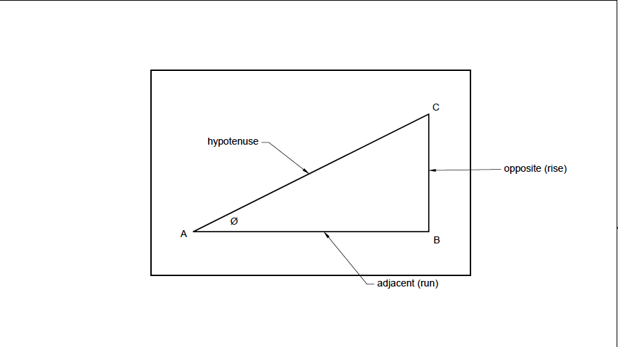

    For my project, I started with two identical squared pieces of aluminum, and I needed to find points A, B and C so that the angle Ø was 7.5 degrees. By squaring the blanks first, I was confidant I could use any of the edges to indicate my angle plate later.
    The length A to B doesn’t matter much, so I chose 1.5 inches. (As you will see later, it is important that the distance between A and C is less than the width of your vise jaws.)
    Using the definition tan Ø = opposite/adjacent, and multiplying both sides by adjacent, you get the formula tanØ x adjacent = opposite.
    Plugging this in my calculator: 7.5 [tan key] x 1.5 = 0.1975
    So I drilled and reamed the hole at A, ran the x-axis 1.5, then ran the y-axis 0.1975 and drilled and reamed hole C.
    For this case, there is no need to put a hole at B. In other instances it might be beneficial so you could put pins in either A & B or in B & C to register your soon to be cut angle off the edge a part or off the slots in your table.

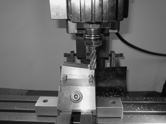

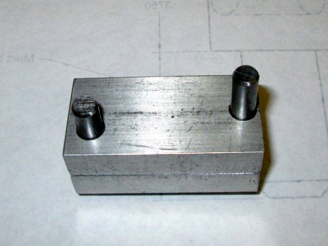

    I then put pins in both holes. In my case, I was making 2 identical parts so I put the pins through both blanks.

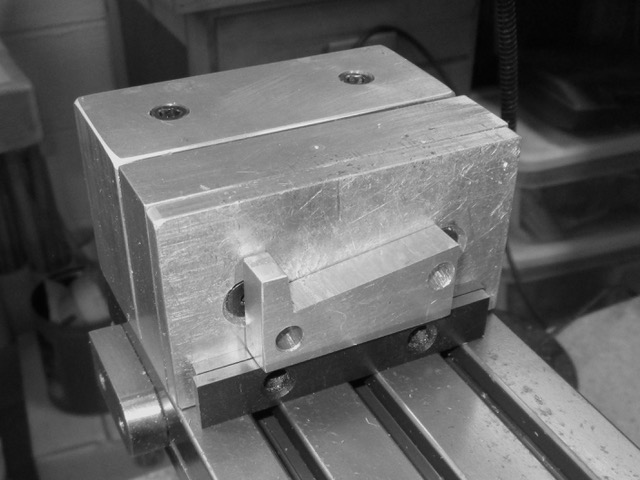

    The pieces are then placed in the vise with the pins firmly against the top of the jaws. (You could add parallels on top of vice if the pins are too far apart to fit on your vise, but that decreases the amount of material you have to hold them.)

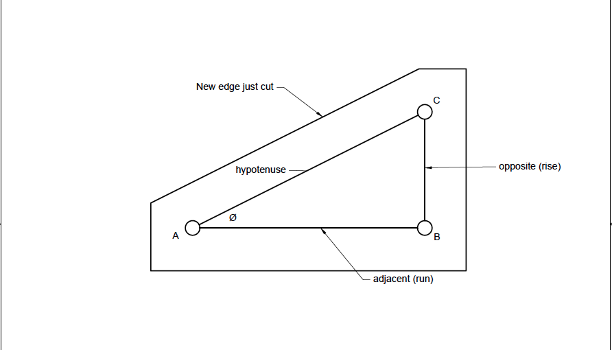

    Then I simply cut the pieces to give me a precise 7.5 degree angle block.

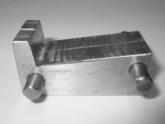

    I wanted to be able to register both blocks on my table, so I added an optional step in them.
    And here is one of the blocks in place.

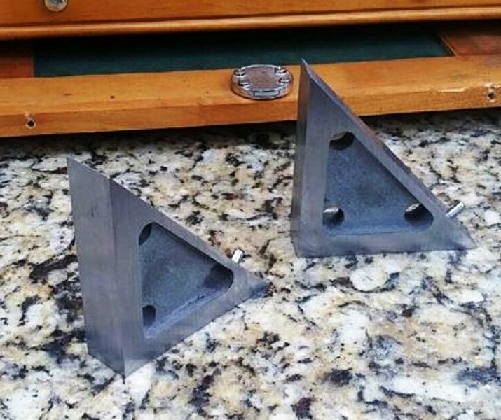

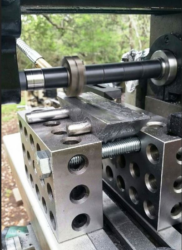

    I made mine with removable dowel pins in the long face for work stops because it could give me another option for use. Mine are general purpose 45º blocks but I made them essentially the same as you made yours. The trig and dowel pins method can make angles so close to the desired angle that the error can't be measured with the usually available tools. I used a couple of 2-4-6 blocks bolted together and clamped to the table as a vise since mine were too big for my milling vise.
    Specialized Angle Blocks-finished.jpg Specialized Angle Blocks-planing-long-face.jpg
    I keep thinking of comments to add. If I do it again I'll fill all three holes with dowels as long as the stack is thick and just drive 2 out far enough to set that angle on the vise so that the stack is always pinned together until all 3 faces are planed.
