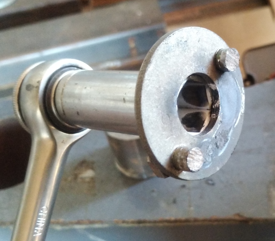

    This is the spanner socket for the spanner head bolts

    I was expecting to see the tool used for the spanner bolt build.
    11,729
    2,238
    Thanked 9,229 Times in 4,406 Posts
    It just seemed the simplest way to tighten the bolts was to use one of the extra washers I made as the spanner the holes are 5/16" so a couple of grade 8 bolts welded to a washer and a sacrificial socket welded to the center made perfect sense to me
