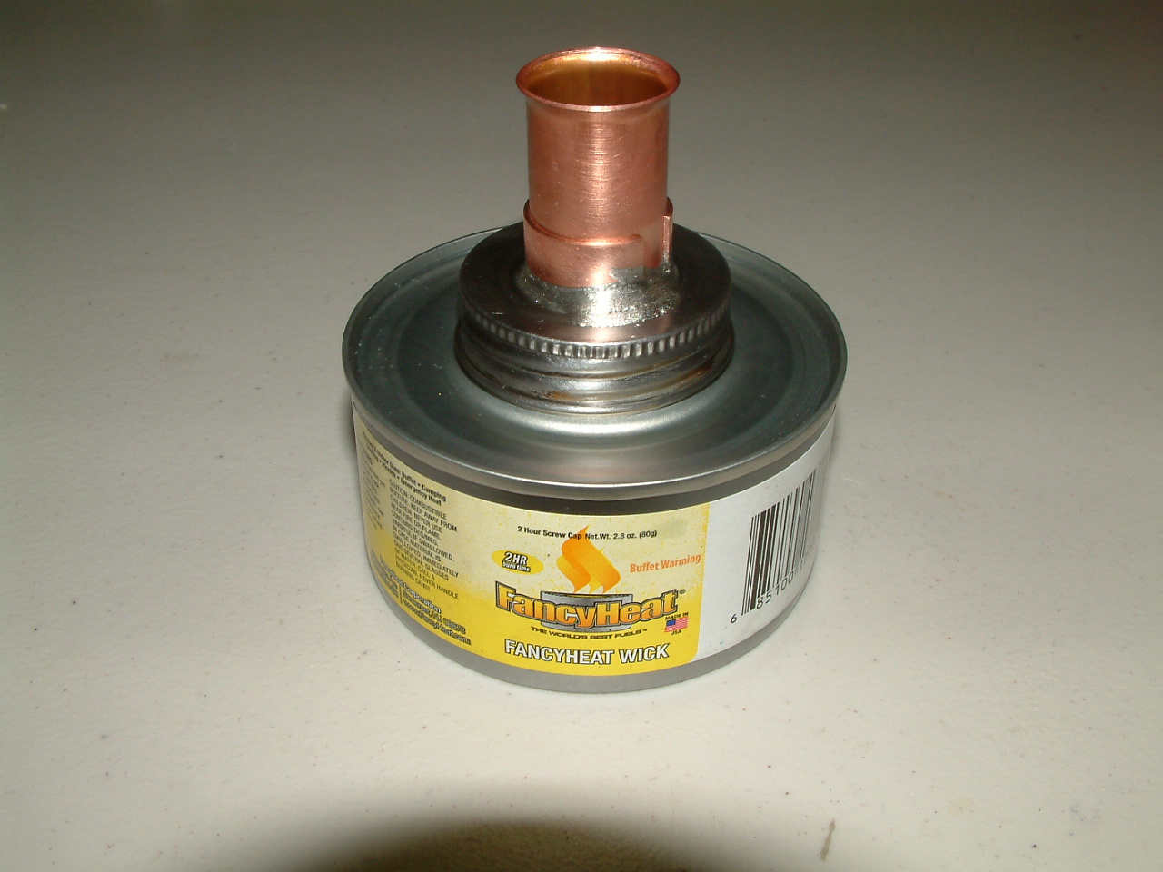

    Found this can of oil in the Dollar store. I guess it is a food warmer wick type heater. It is a very easy oil can make over. Just poke a screw driver into the top with the wick. Bend it a bit and it pops out. Drill a hole in the can lid and fit it up with a piece of 3/4 copper tubing and an an extra "collar" made from the same copper tube.
    Solder it up and presto, a "spill proof" oil can. One for the lathe, one for the mill and one for the bench. Easy to clean out the chips with that removable top.
    If you want it to stay put on the mill table just put in a nice neo magnet (3/4" by 1/4") and you will really have to work hard to knock it off the mill.
    Cheers, JR

    So are you using a acid brush or how do you get the oil out?

    Acid brushes work great. Small china bristle brushes work fine, and even cheap hobby paint brushes.
    As long as it fits in the spout it will work. Small brush for small jobs, big brush for large jobs.
    Cheers, JR

    As an aside to this topic...
    If you want to go really OCD on this style of no-spill container, the associated mathematics can become moderately complex. Assuming that you want the can to be no-spill on its side and completely inverted there are mathematical relations among the following variables that must be satisfied...
    inner diameter of can
    inner diameter of tube
    projection of tube into can interior
    I actually wrote a computer program to do the calculations but never published it because I realized that nobody is that OCD about such a mundane item.
    At the other end of the spectrum, we have this design that demonstrates that even I am not that OCD...
    Full description here... http://www.homemadetools.net/forum/q...ontainer-38026
    [Although writing a program for a no-spill with conical top would be a fun few minutes of work.]
