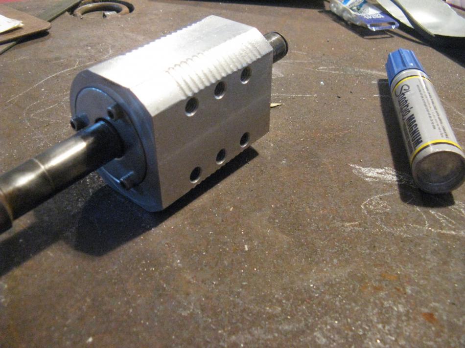

    Here is my mandrel which I will use to slow down my wood working Rockwell drill to make it more useful and easy to use in drilling metal at lower speed and with more torque. I poured aluminum that I heated in an old pottery kiln directly into a soup can. Then a buddy Rob,Soup can mandrel-homemade-shop-tools-008.jpg in Edmonton machined the flats and drilled and tapped the bottom for bolts. He also made pockets for the 3/4" I.D. bearings and fastened the large washers as retainers. During part of this he was giving me an excellent tutorial on how to setup and run the Haas CNC mill. Naturally I immediately forgot a bunch.

    Cool stuff. That's a nicely cast piece.

    I like it. The ribs from the can are stylish.

    So cool, I like how you left the ridges on the casting, kind of "Andy Warholish" It looks exactly like something that would fit on my Gingery mill quite nicely.
