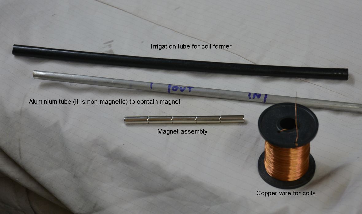

    How I made an LVT for my shock dyno.
    That is a Linear Velocity Transducer. As motion is involved I have made a movie.
    An LVT measures linear velocity over a limited range depending on the construction details. I wanted a transducer that had a range of 100 mm. with a maximum velocity of 1 m/s.
    Something completely different.-bits-4-100mm-lvt.jpg Click for full size
    Here are the ingredients. It could not get much simpler.

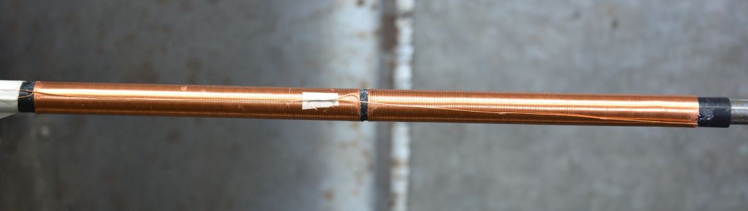

    In the making.

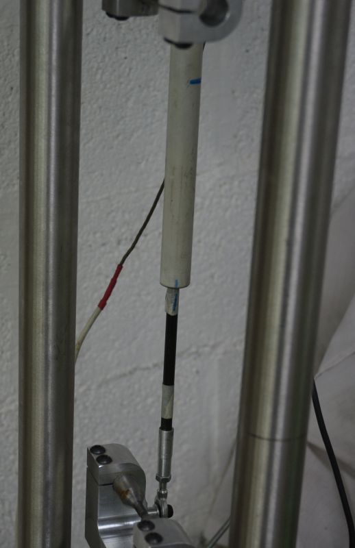

Size:  7.2 KB Something completely different.-mounted-2.jpg
    What is inside and mounted.

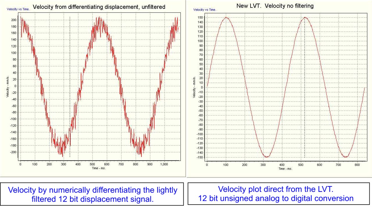

    Until I made this device I got the velocity information in the usual way of measuring displacement with a potentiometer and differentiating that signal. The process of numerical differentiation leads to noise in the velocity signal. The noise level depends on the resolution of the DAC (Digital Analog Conversion). I used a 12 bit LabJack U3 to convert the data, if I had used a 10 bit Arduino the noise level would have been 4 times more.
    This pic shows the difference between getting the velocity direct from the LVT and indirectly from the potentiometer.

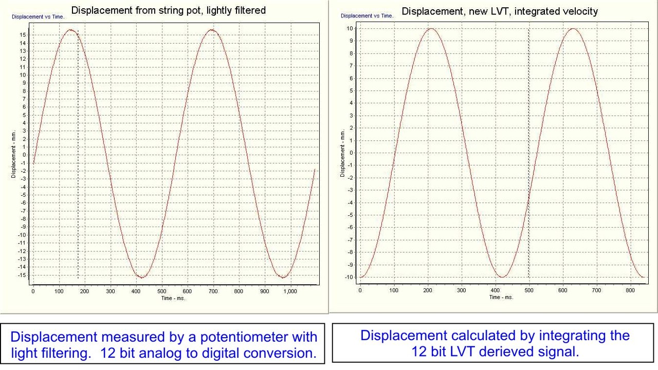

    I still want displacement information, but I now get that by integrating the velocity signal which reduces noise. I get a slightly better displacement signal from the velocity than directly. This is often termed a "win-win".
