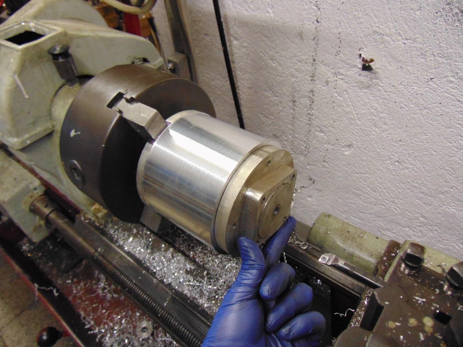

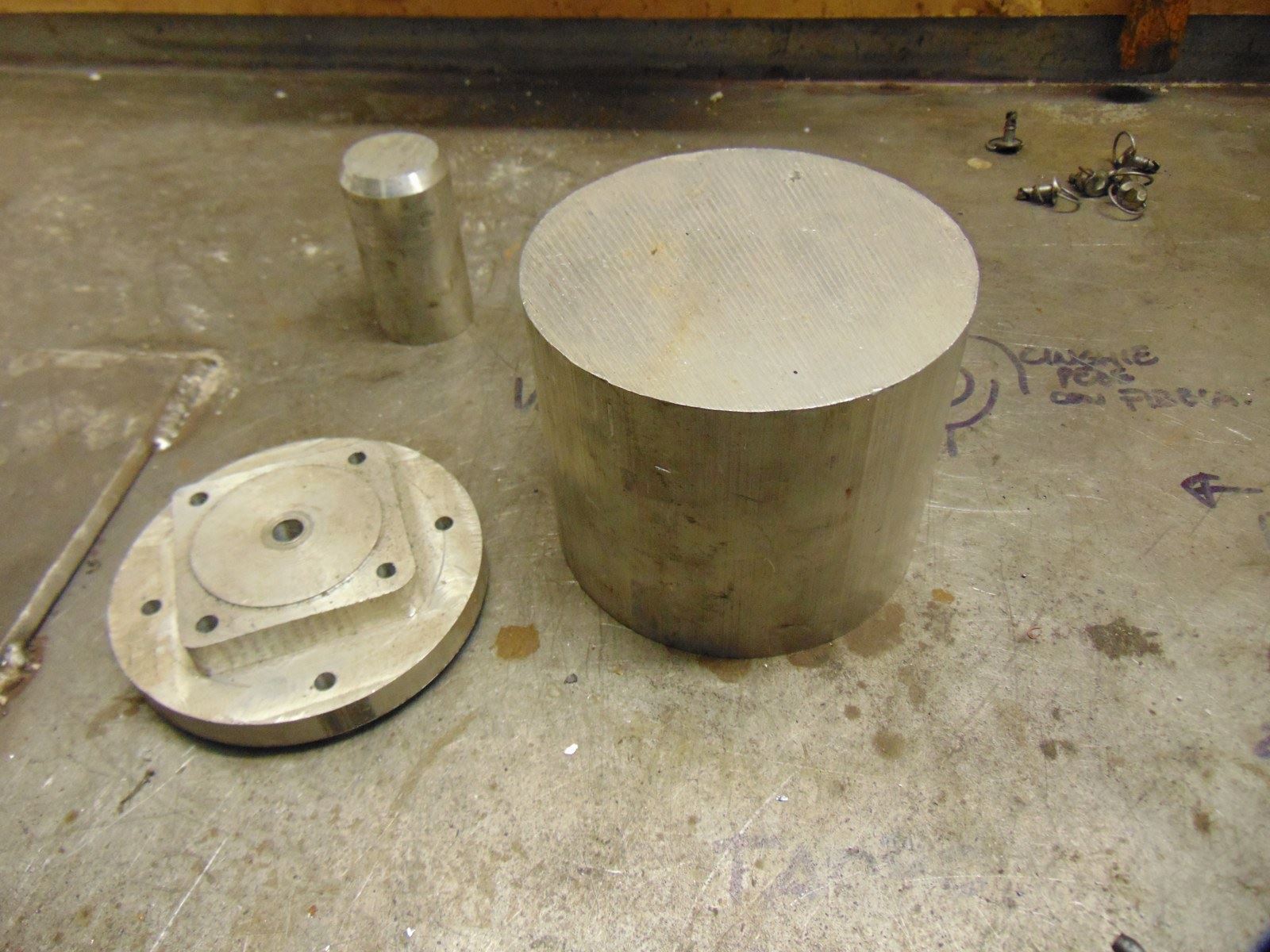

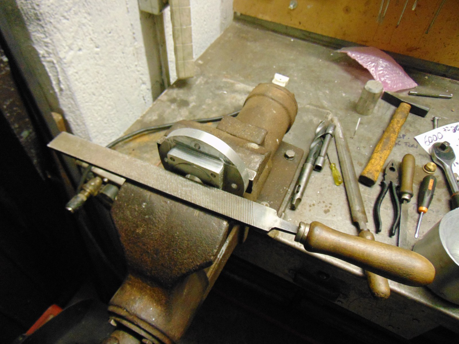

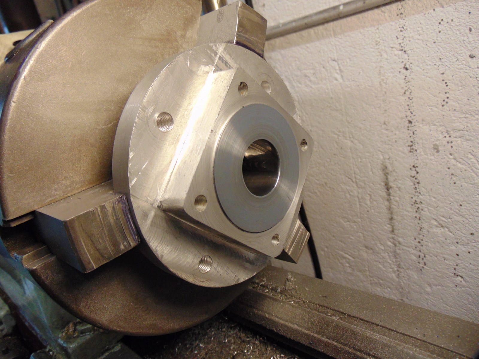

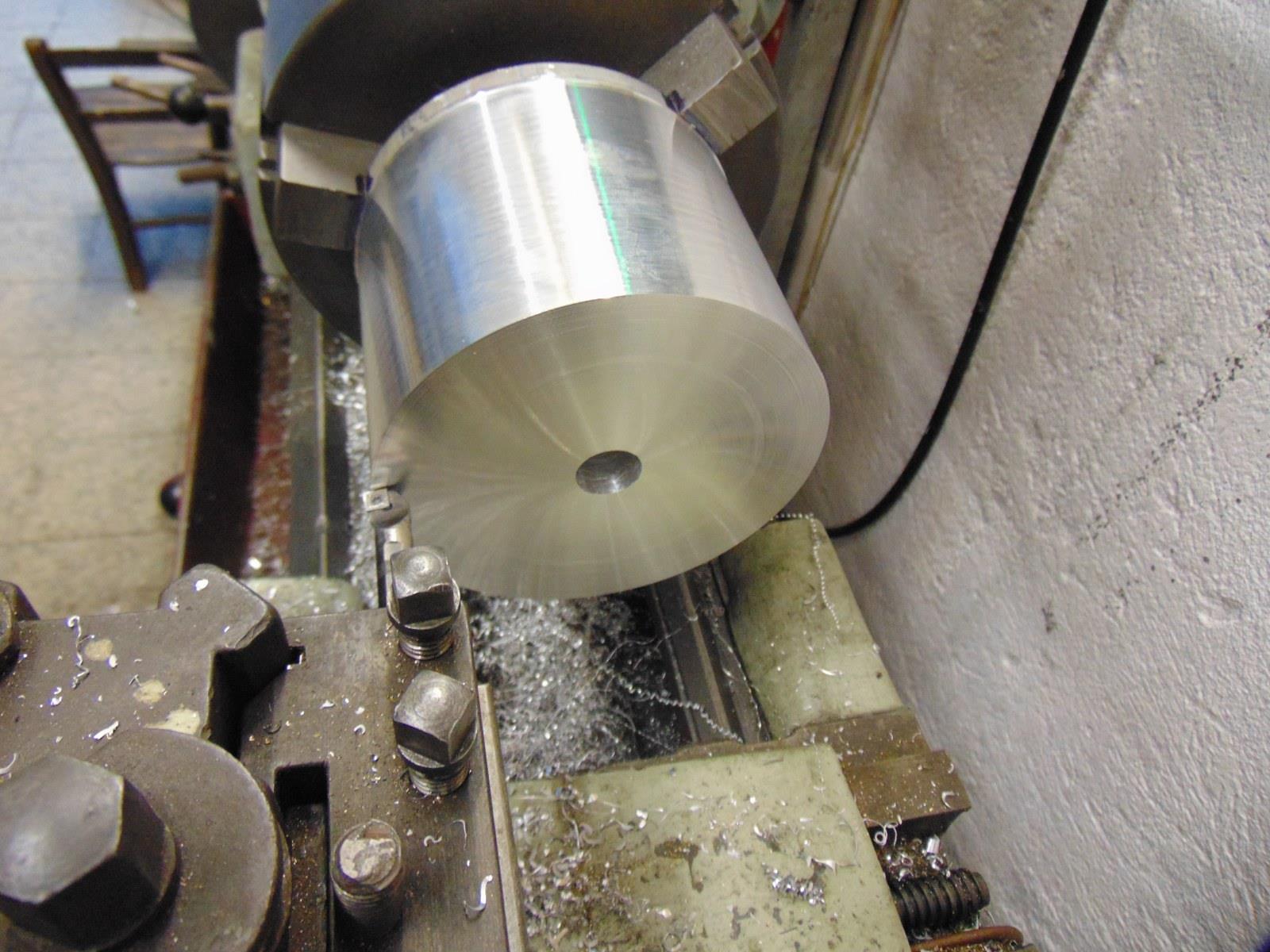

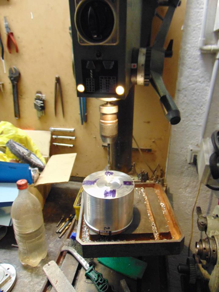

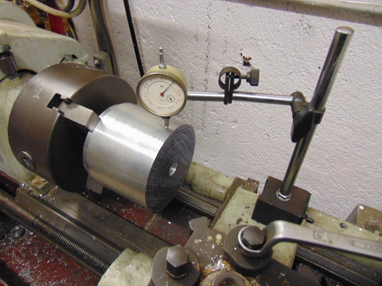

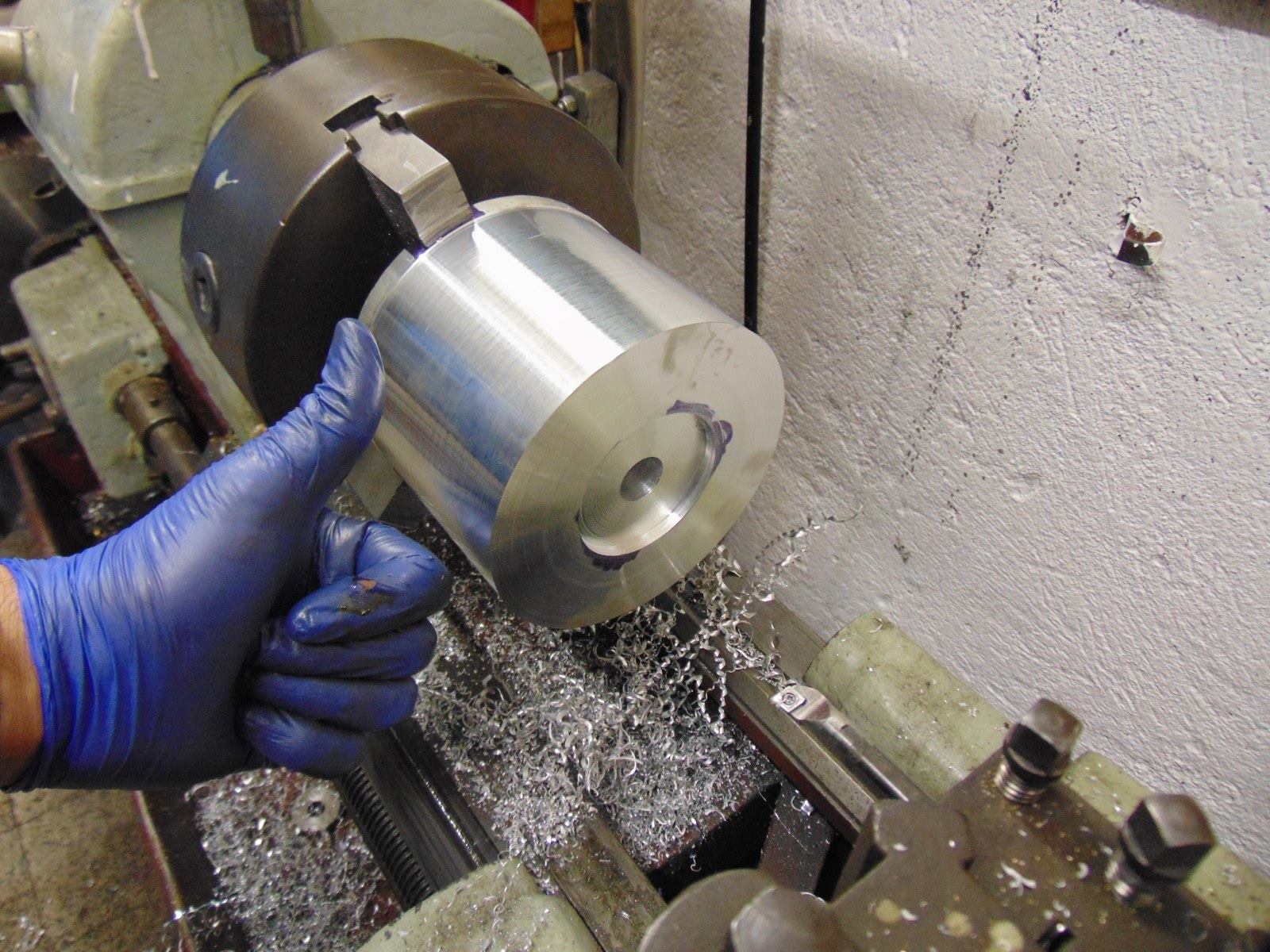

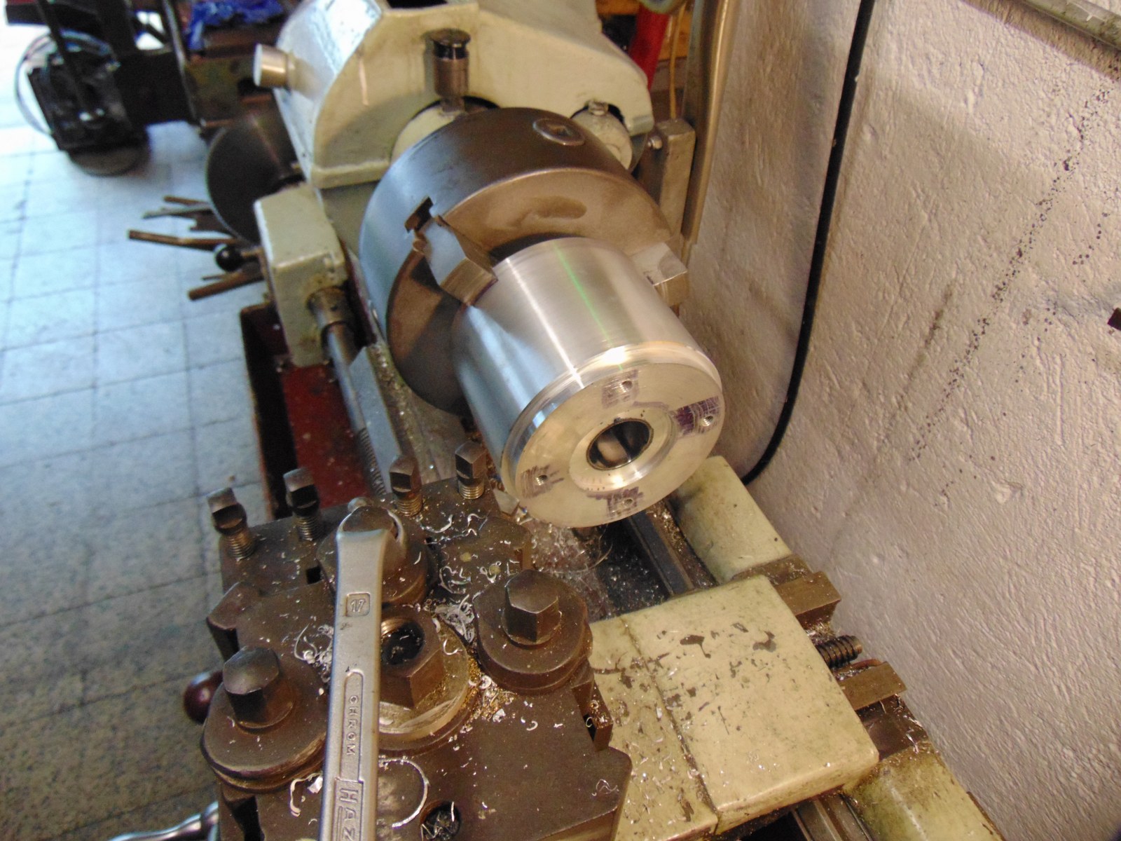

    Hi all!
    I'm building the second horn for my RCF Nd1710 mt3 audio driver, 1" exit , 108db/w/m, 1-20khz range, titanium diaphragm and strong magnet.
    The big boy is a 130mm round bar, normal aluminum that melt on tools
    I chose tractrix contour, I tried it many times in the past, it works perfectly for home use for middle and high frequency.
    Probably I will buy a good finishing tool
    Some pictures of the horn , still work in progress
    Saluti
    Stefano

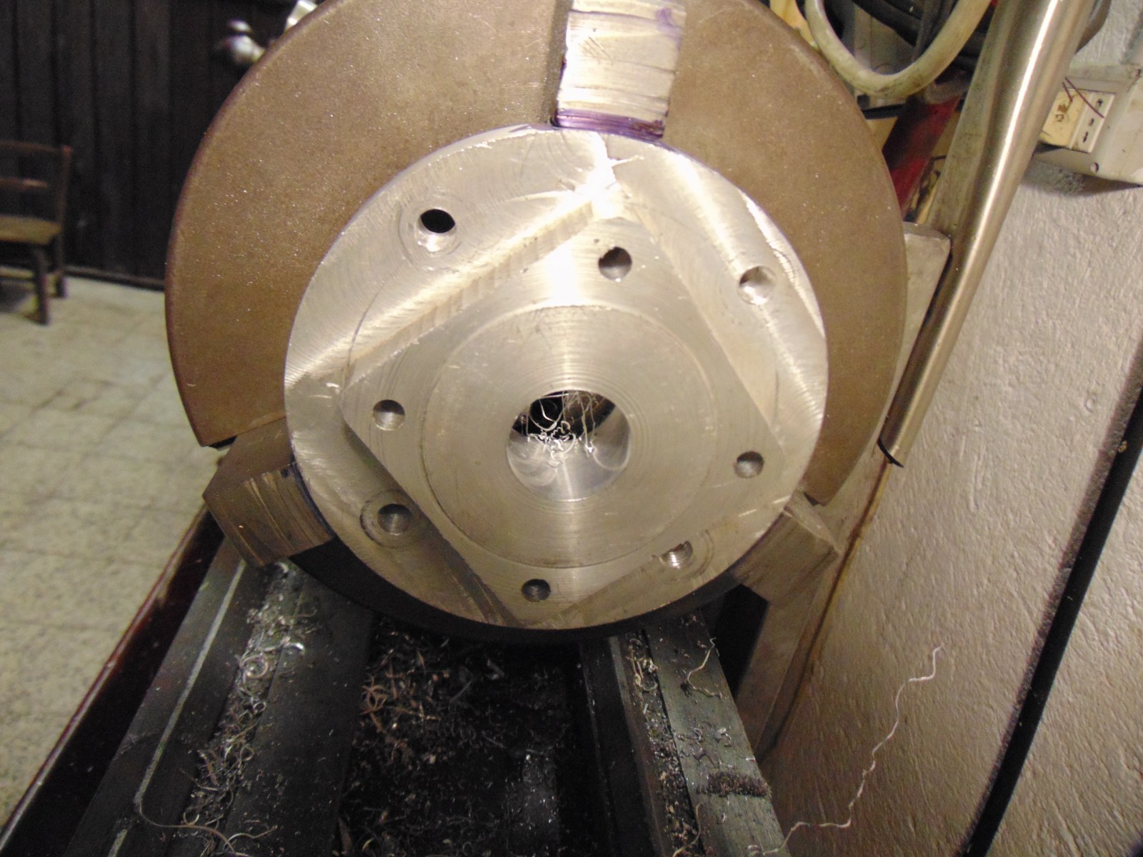

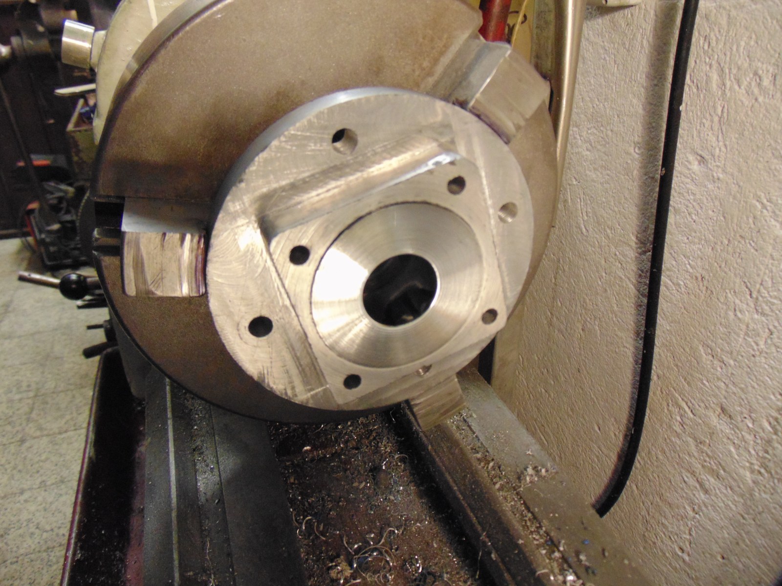

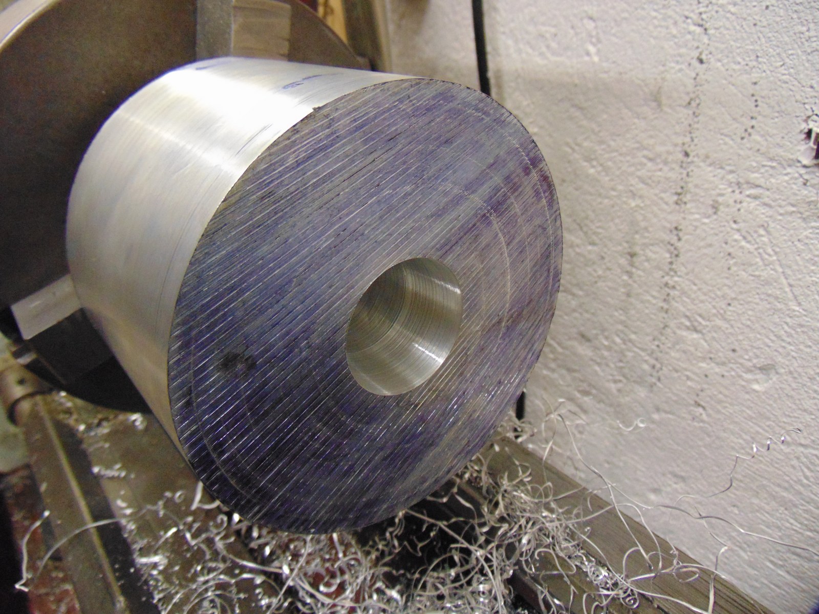

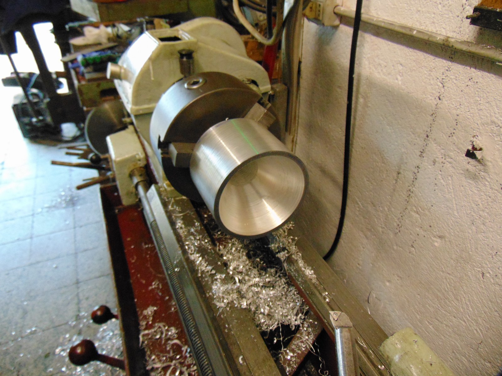

    Aluminum streamers today!

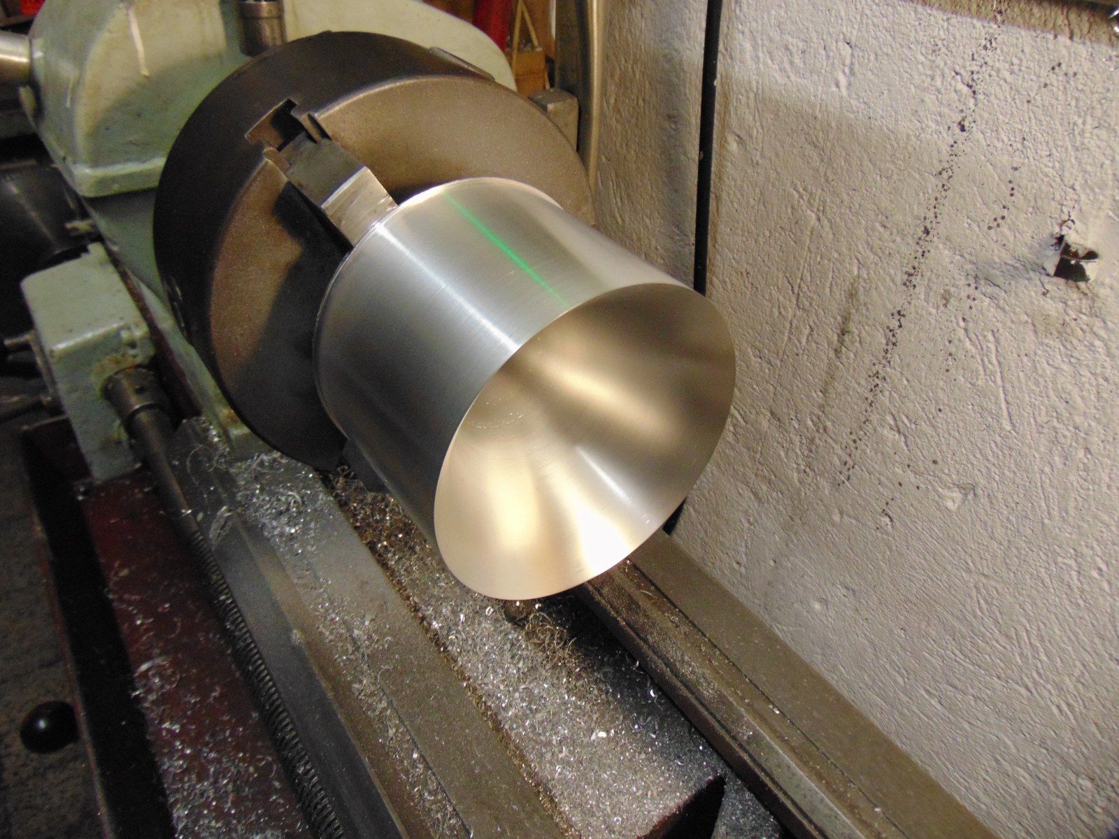

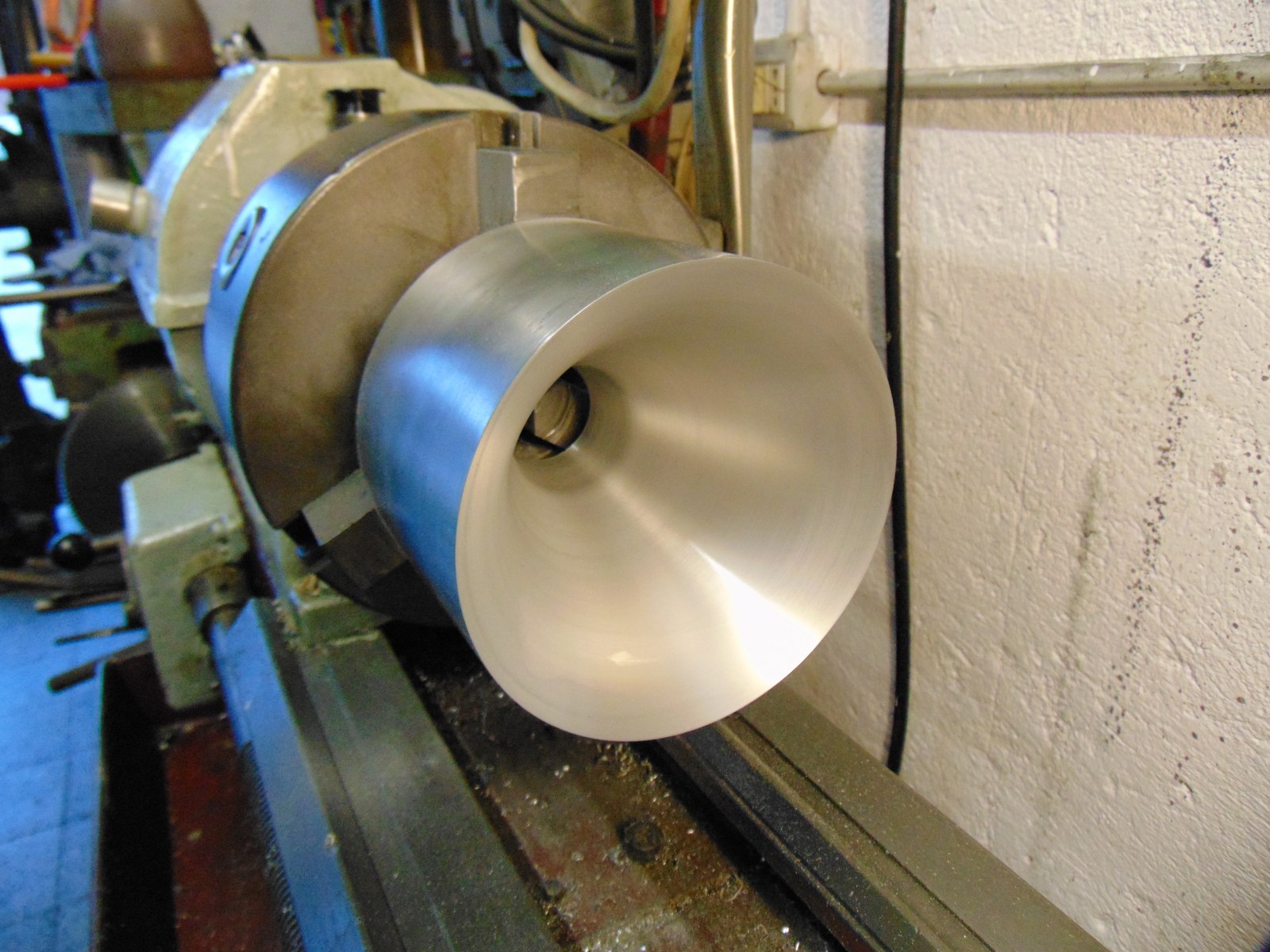

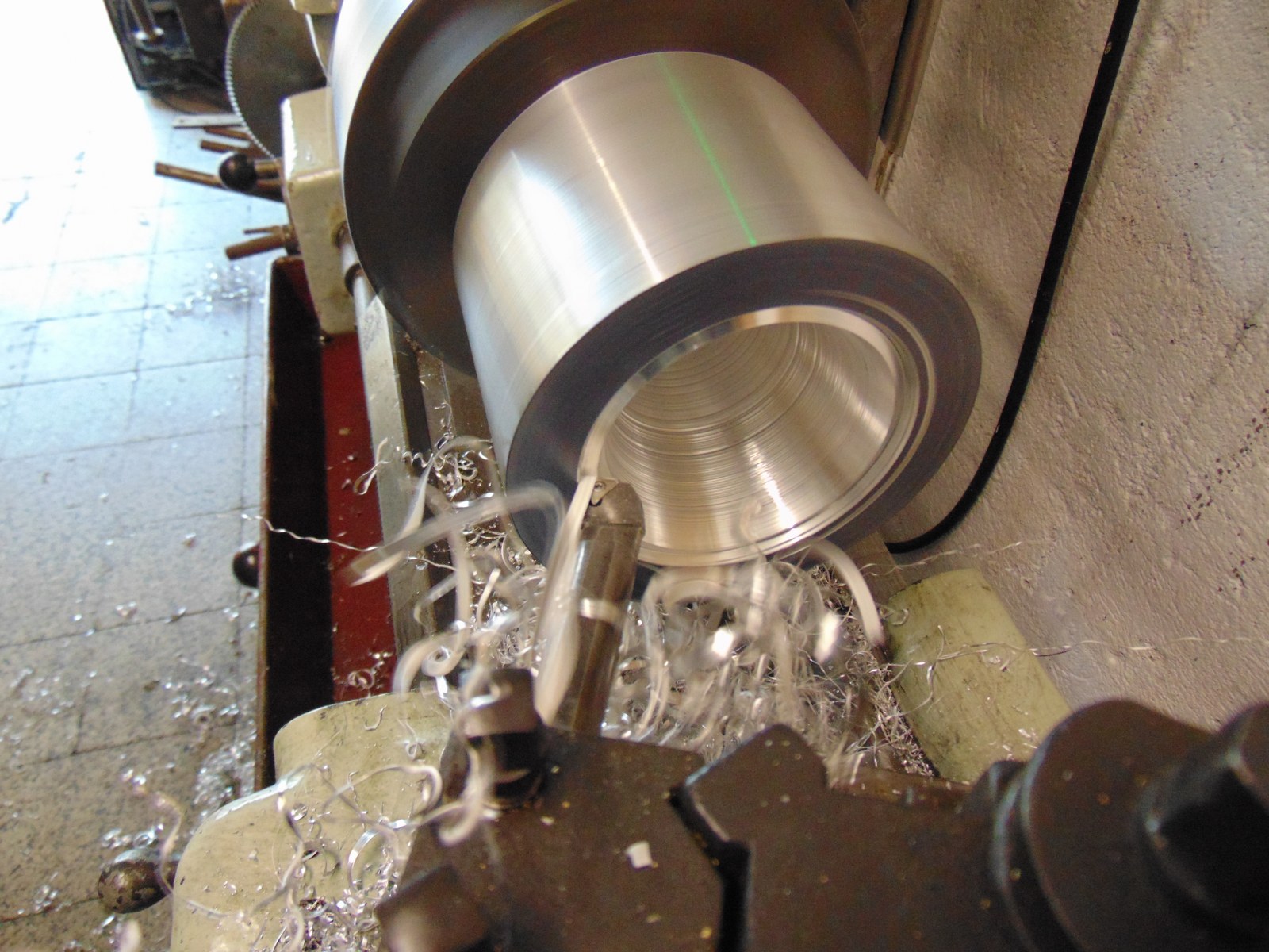

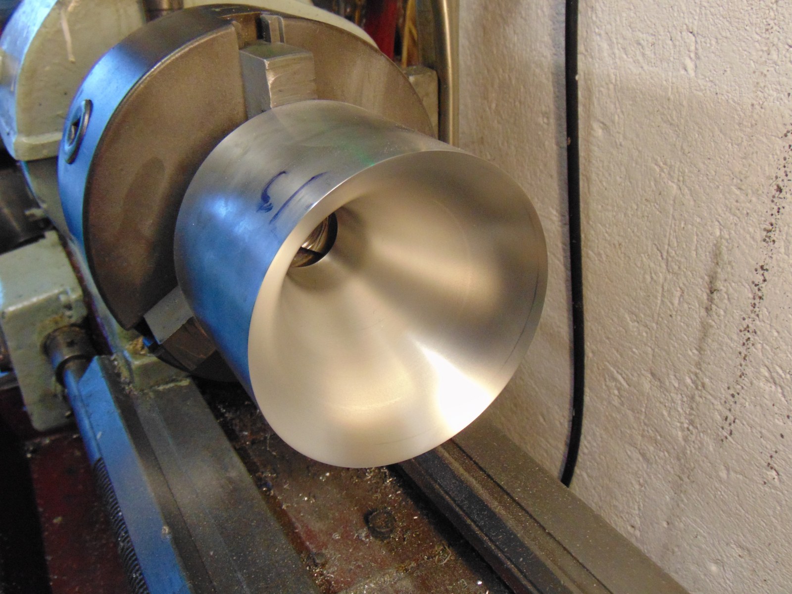

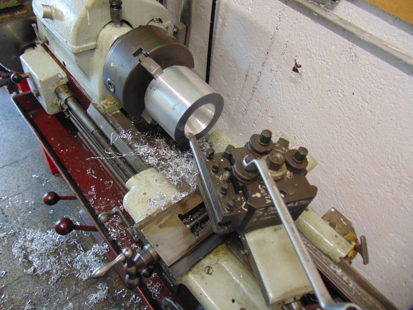

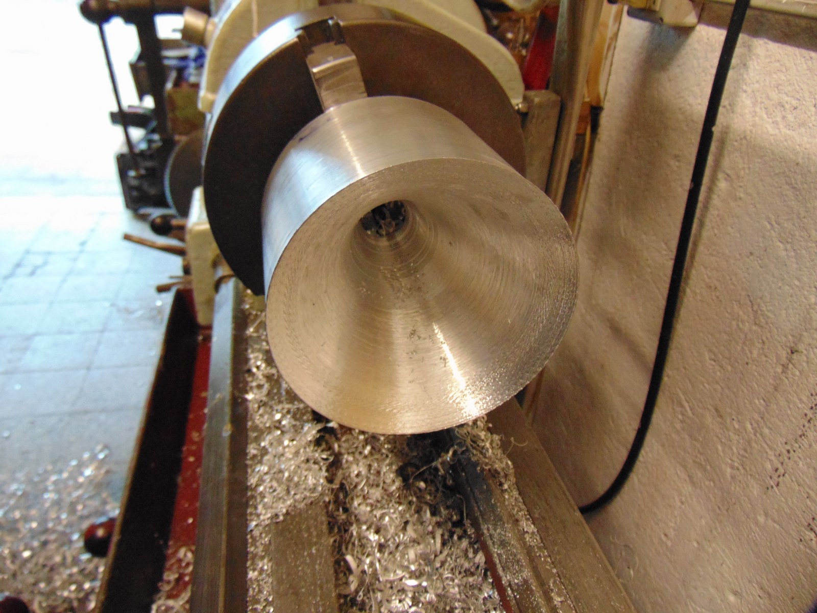

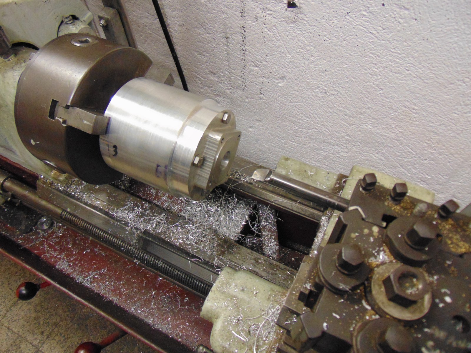

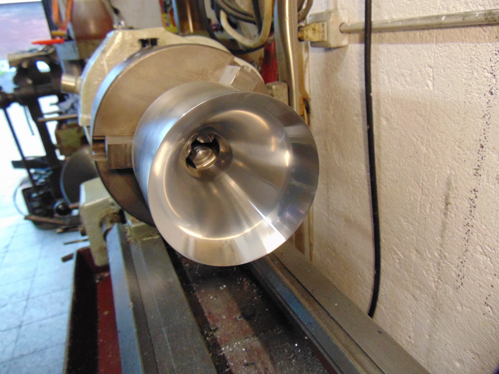

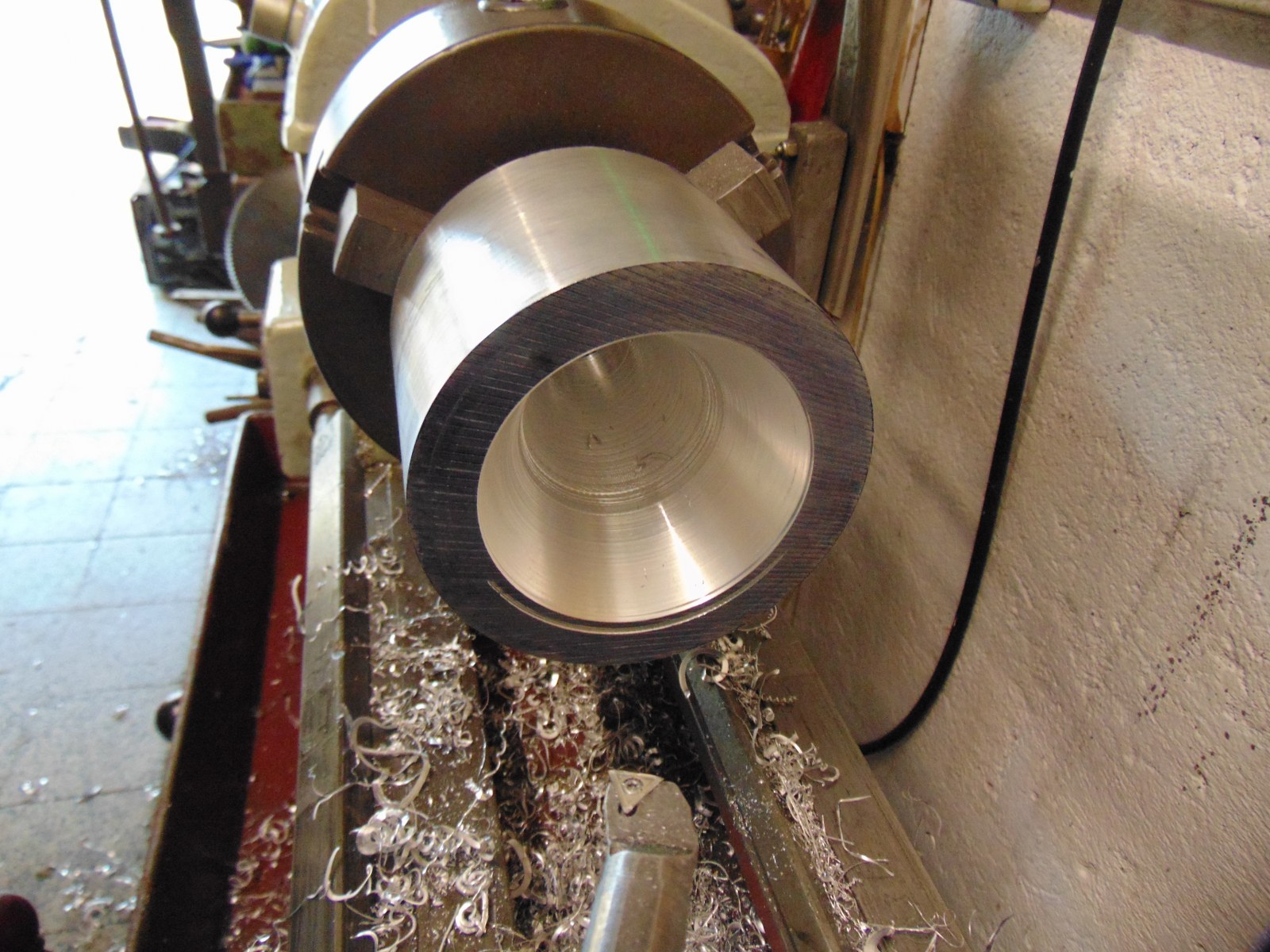

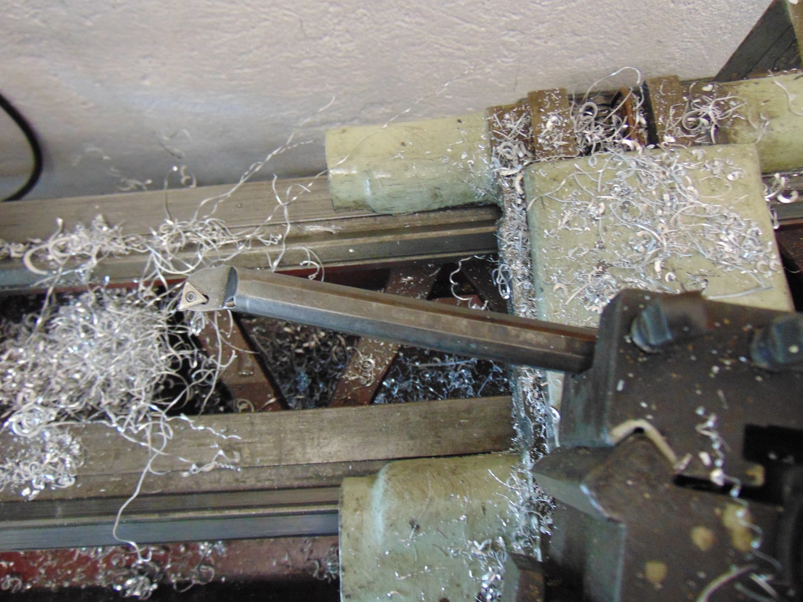

    The raw profile of the horn is done, with the lathe at limit. My endowment of boring bar is limited, for this tool I have no new carbide tips. Unluckily the only right tool I have, it's short and tiny, not enough for this job but I do what I can.
    Now it's time to use the files, lot of sand paper and finally wool and polish!
    I'm having some trouble about vibration using boring tool and up to 20° angle, have some good advice in order to have a good smooth surface?
    thanks
    Stefano

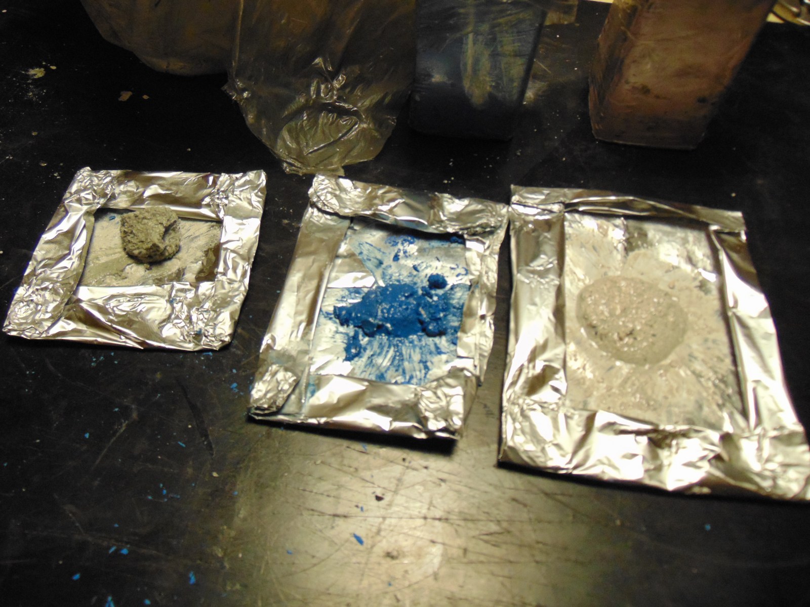

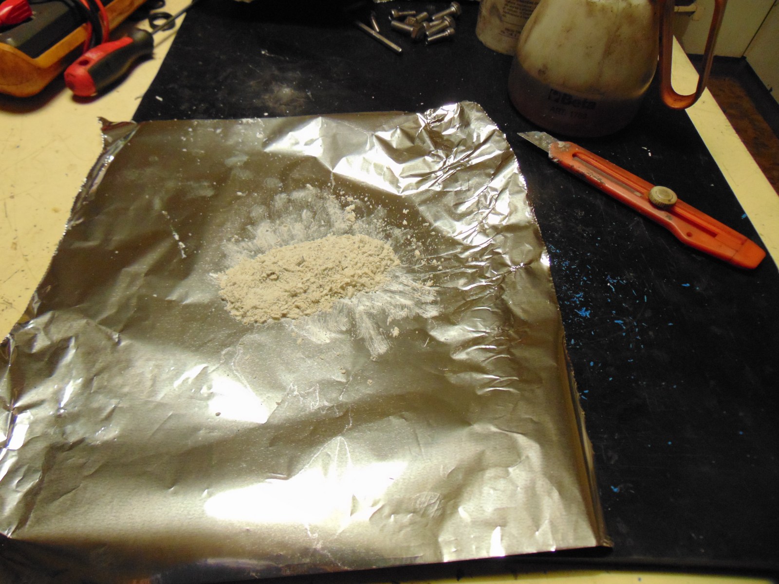

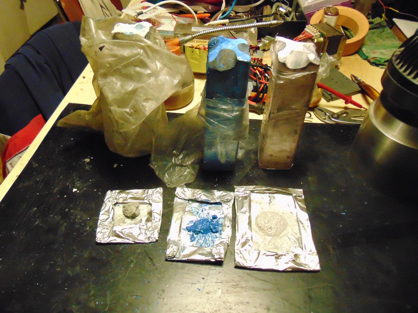

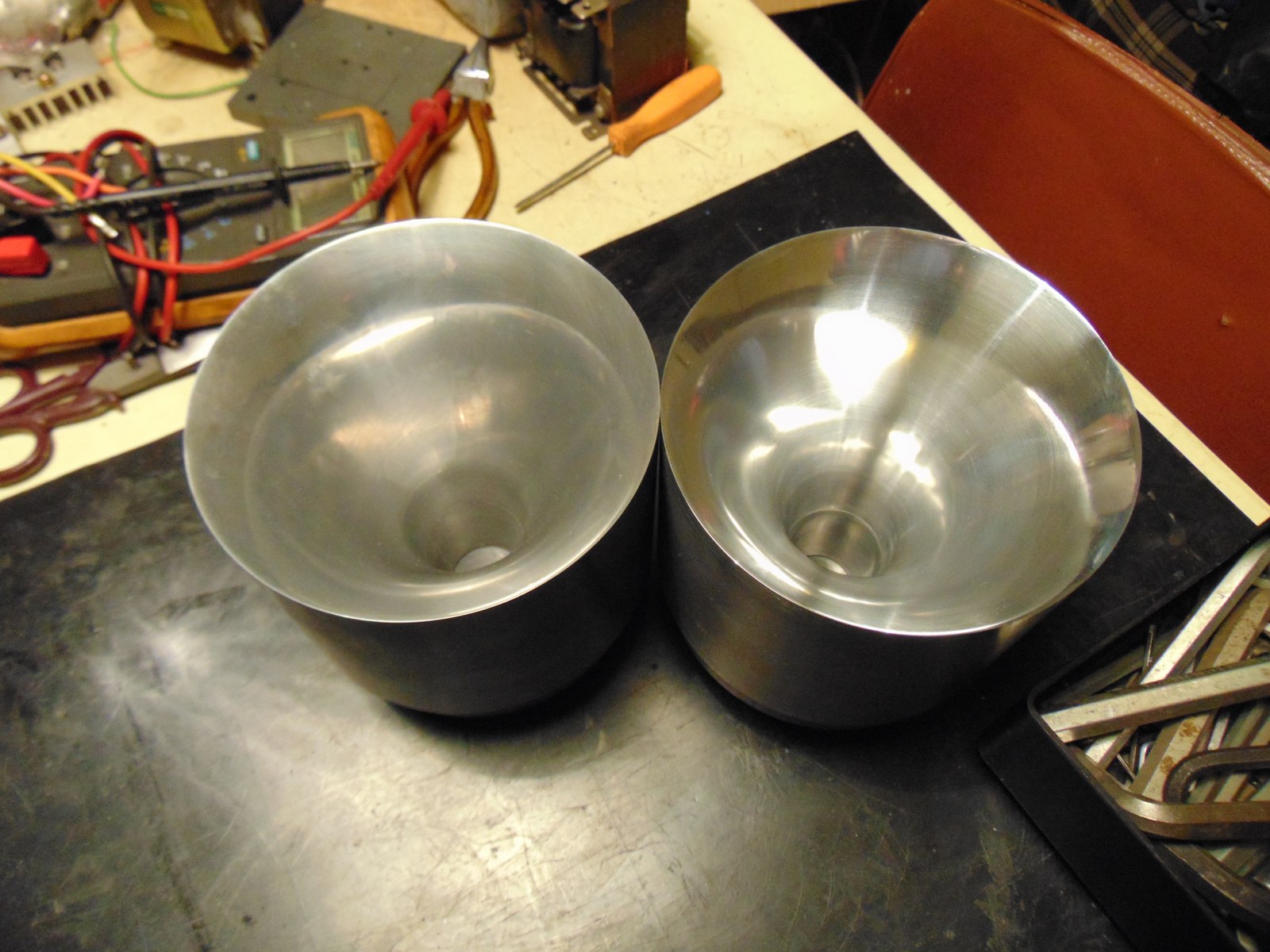

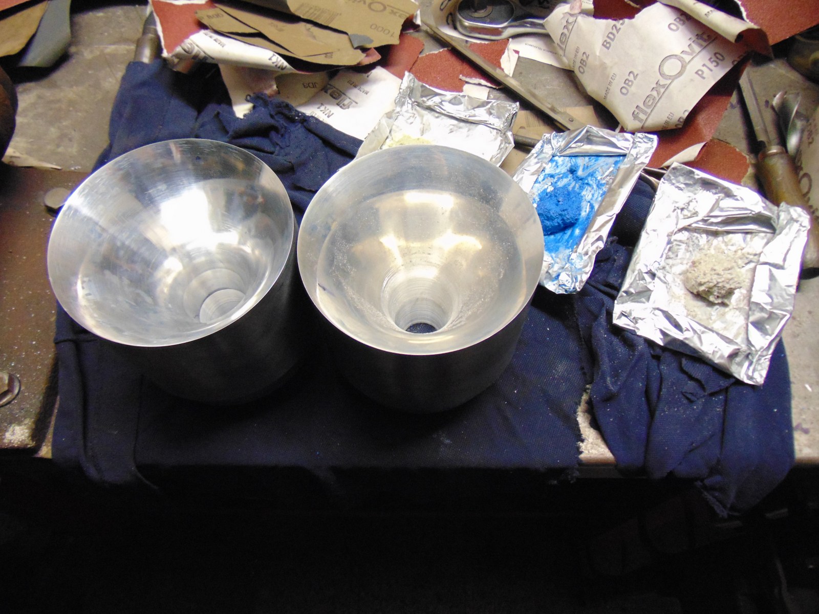

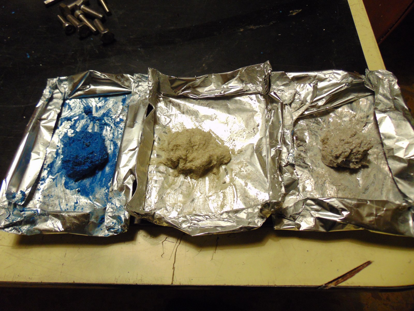

    Ready to polish the inside of horn… unluckily I can't use cotton wheels and normal paste.
    I'm trying to make a "grease" paste with powder, I hope it will be good!
    Solid horn  -  work in progress-dsc04695_1600x1200.jpg Solid horn  -  work in progress-dsc04696_1600x1200.jpg Solid horn  -  work in progress-dsc04697_1600x1200.jpg
  12. #8
    11,716
    2,228
    If you can't find any jewelers rouge then a wad of lambs wool on a stick and tooth paste usually works for me.

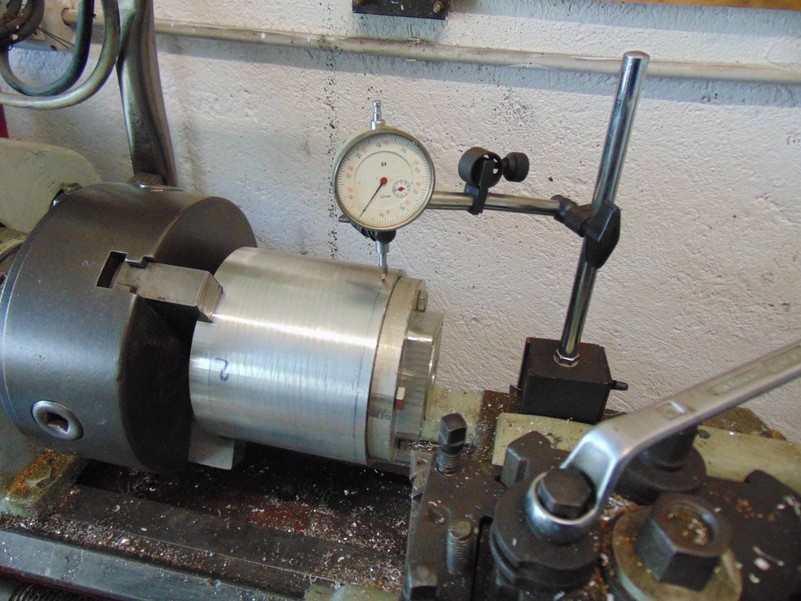

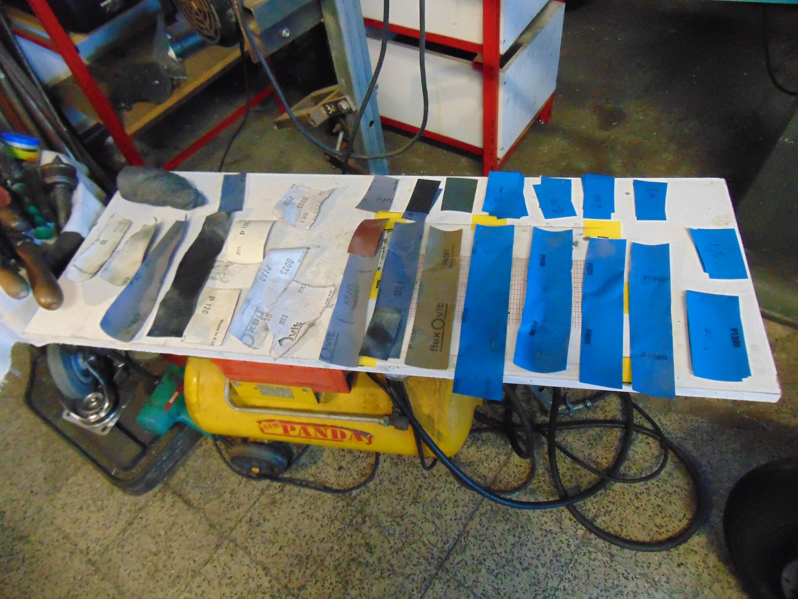

    Some work of adjustment, lot of sand paper needed, lot of passion.
    I prepare a second special recipe for the polishing paste with lithium grease and oil, it should work fine, at least it can stick better to surface. The trouble is that I can't push so much to increase heat, like with cotton wheels. Another trouble this soft aluminum is a crap to polish compared to ergal, scratch are behind every corner.
    I'm thinking about the next step, Last time I build brass long feet from solid bar (H frame), maybe I will machine a couple of rods fixed directly to the horn.

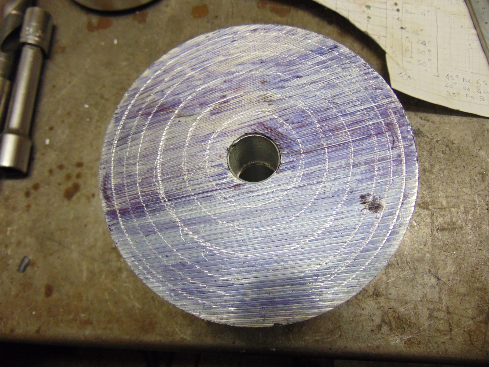

    Lot of time with sandpaper, from 60 to 1500 grit, about 5 hours to polish both, I still need half an hour, the abrasive mix with grease and oil is hard to clean inside the horn, in first picture there is the veil on the surface.
    I have to finish the adaptor, and thinking about the pedestal, I found 25mm solid brass round bar that seems perfect for the purpose, I'm still undecided if make a stand alone unit or fix to the horn through screws.
