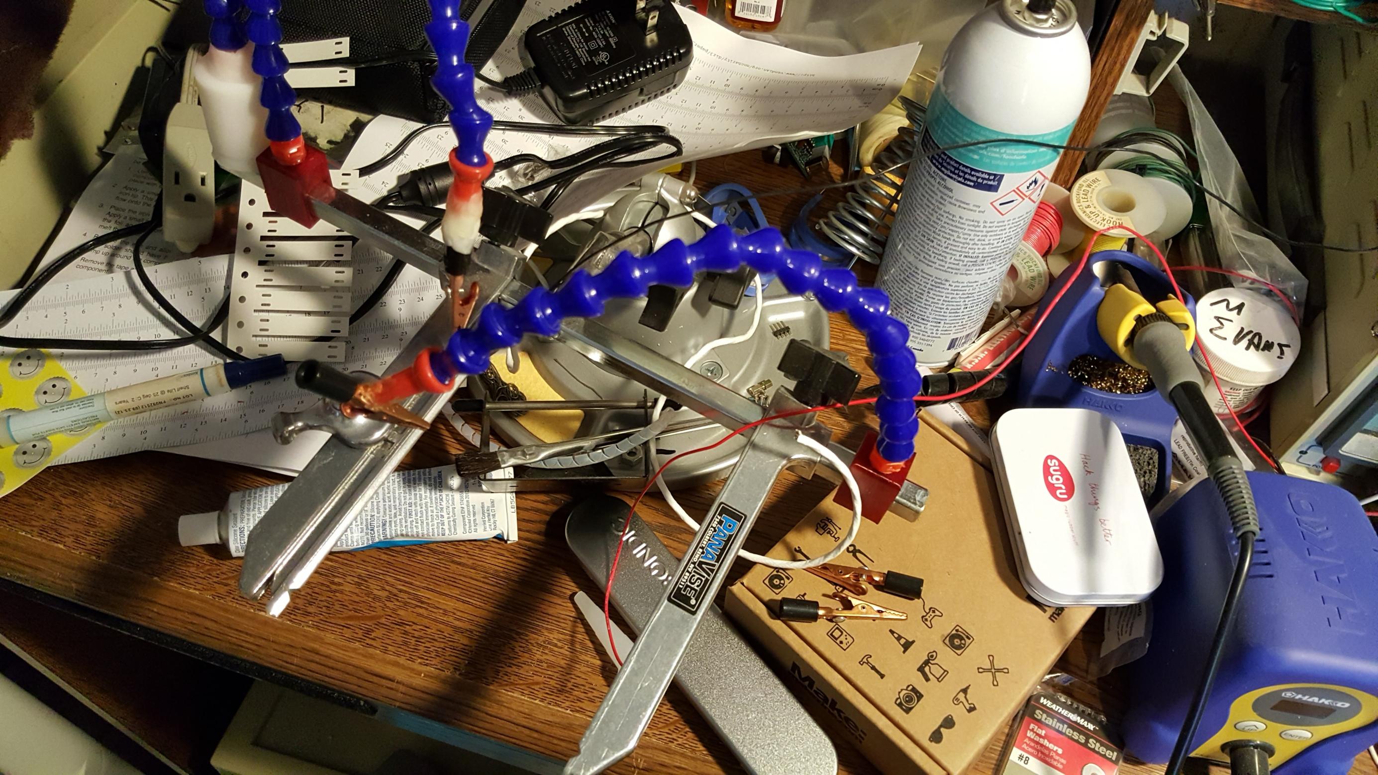

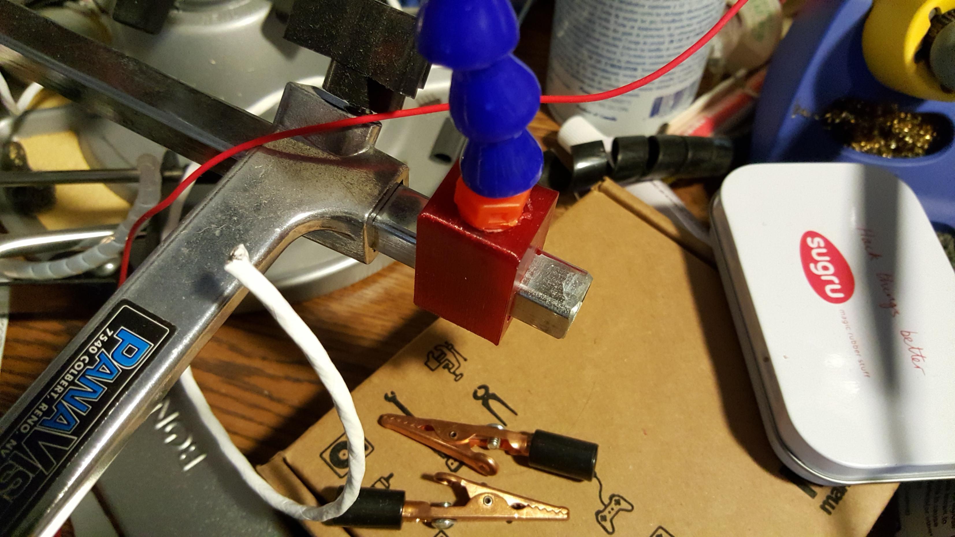

    I gave away my commercial third hand as I did not like it. I wanted something that would work directly with my panavice. I tried using magnets for mounting these but even the strongest did not hold well enough so I 3d printed adapter blocks. The ones I have built so far just use clips on for the ends but this can be adapted to all kinds of assistive holding. Soldering third hand for panavice-20160101_135531.jpgSoldering third hand for panavice-20160101_135511.jpg
    The rods are just coolant tubes from Amazon, if you need to do something more heavy duty just go up in size. The 1/4" work great for electronics work but I'd go to 1/2" to make a light or the like.
