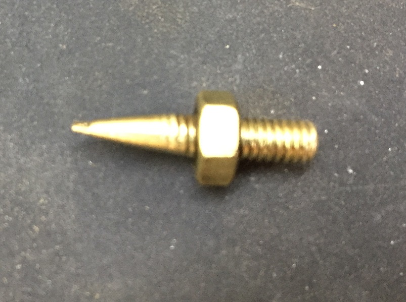

    New parcel from AE has just arrived after 6 months. 2 x 16 LCD display. Need to do some very fine soldering (16 Pins) to connect a I2C module to it. This reduces the 16 input pins to 4 input pins bla bla bla..
    when checking on my soldering iron...well known brand with screw in tips it was well past its soldering electronics and only suited for tinning wire. So no easy home made solution to new tips.
    But it turned out not that difficuilt.

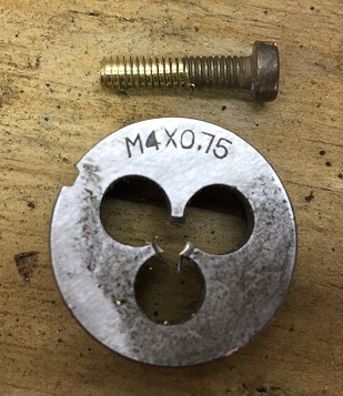

    1) It turned out to be a M4 x 0.75 tread. standard M4 is usually 0.7mm pitch.

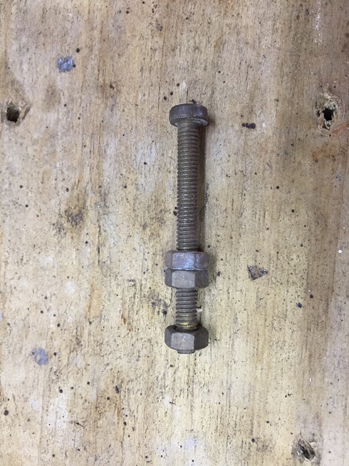

    fortunately I have one of those very cheep set of tap and dies, but with all the sizes.
    Good enough to recut brass screw, but not all the way....

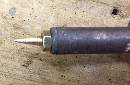

    Left a few 0,7 treads so I can screw the nut back on again, in order to be used when ever you want to remove the tip again. Will solder to tip the first time I use it. Once cold this will be fixed so can use a spanner to remove.
    Done...

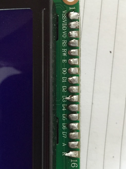

    It actually works quite well. will make one even sharper.

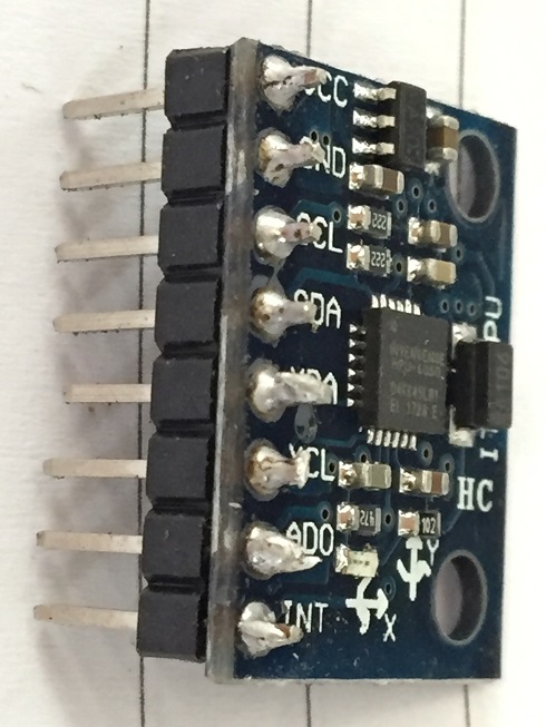

    and forgot I had this little 3 axis gyro that needed header pins soldered on.
    that little board is only 21mm x 15mm and 8 pins.
