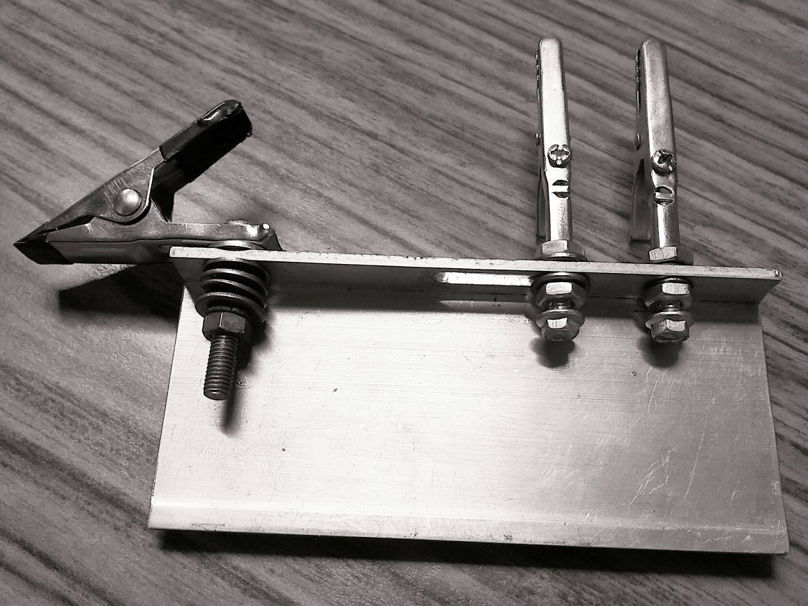

    Posting a very recent [3 minutes ago] fixture, simplifying repairs inside vehicles or other tight spots. Cost is super low, already had the material, bits totaled about $1.50. Angle aluminum 1/8" x 1/2" x 2", spring clamp with *10 fasteners, 2 alligator clips with *8 thread-cutting fasteners, a ring of magnet of ceramic/ ferrite, and a little 2 part epoxy.

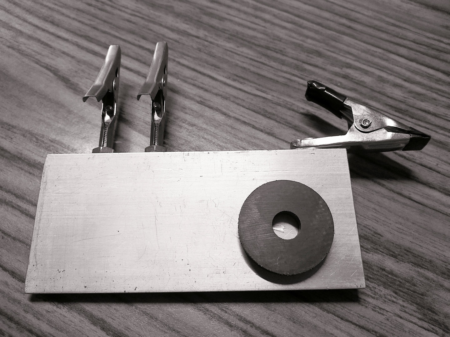

    The magnet offers lots of mounting locations in auto's, that don't appear in say, boats, it's epoxied in place.
    That's where the spring clamp comes into play....even grabs a cardboard box or plastic tray. The clamp is mounted with a stack of lock-washers and flat-washers to create a clutch, holding a convenient position

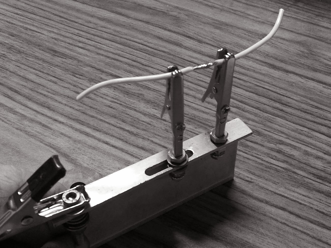

    Mounting the alligator clips, one is in a hole, the other is slotted. That allows mesh or western union splices in multiple wire sizes, as larger wire wants a proportionally bit longer connection. It's also a clutch, allowing quick but firm slide adjustment.

    Magnet is to be mounted as shown; too late and cool out for a dependable bond, can wait till morning.
    Hashed awhile over desired elements that materials on hand accommodated; heavier bits at one end, a profile flat as possible, stores in the tool kit, adaptability, plus [of course] the entertainment achieved doing something useful and lasting.

    Far as copying, of course I don't mind. However; mods are in order.
    While assembly works as intended,a little disappointed by the magnet. The placement is sensible, just insufficient flux to stay in position selected, calls for adding one to opposite end. The clip is compact, however jaw profile is a little too 'pointed' [?], will try curving them out a bit.

    I did 7 years worth of miniature and sub-miniature electronic assembly, much of it under a microscope. Those tools offered nothing compatible with repairs-in-place work. Cost effective is subjective; that market leans toward assembly benches, clean rooms and ESD garb.
    Many examples depend on a heavy base, or excess height for say, under dash of a car. Articulating arms require fiddly adjustments, both of which positioned above something to steady elbows or arms, along with excess width outside 'work area'.
    Mine is thin, low and narrow, compact enough for pocket or parts tray, cheap as can be, perfectly adapted to splicing, and I've seen none combining 2 means of attachment...not worthy of a patent, yet total up unique enough to qualify.
