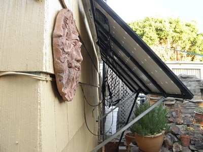

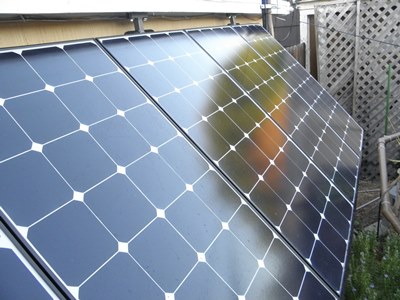

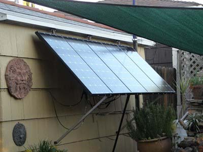

    This is a five panel array of 100 watt solar panels which charge 2 banks of 4 RV 12 v battery's.

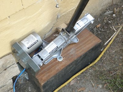

    The panels are controlled by a 12v car jack to move the array as the sun's position changes every month.
    Solar array angle iron metal frame-p1250001.jpgSolar array angle iron metal frame-p1250029.jpgSolar array angle iron metal frame-p1250014.jpgSolar array angle iron metal frame-p1250014.jpg

    Looks like a cool setup! That use of a scissors jack is innovative.
