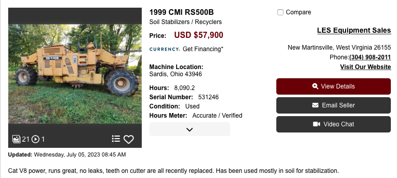

    You can get one to till up your garden for $60,000 US.
