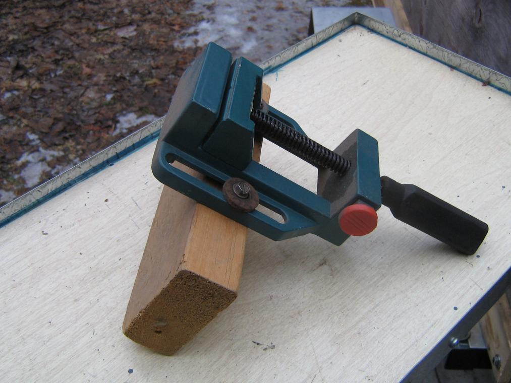

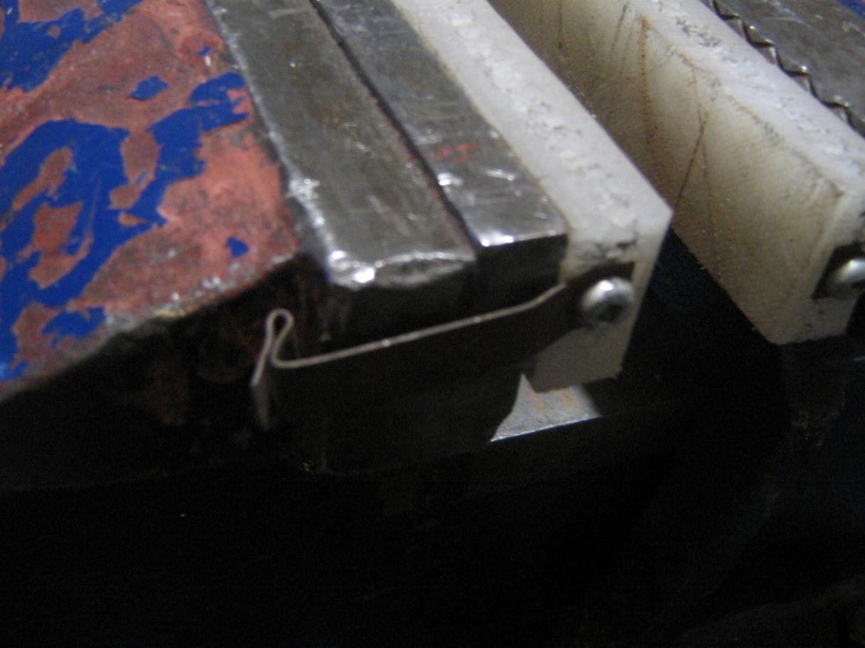

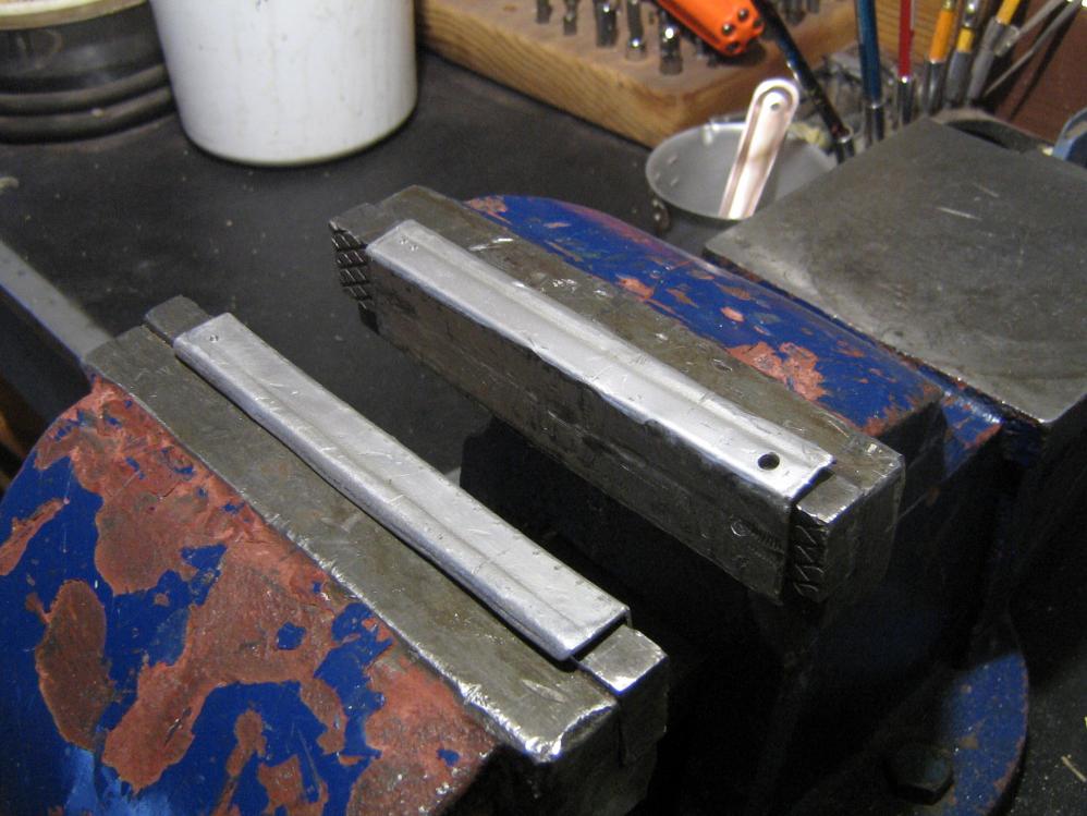

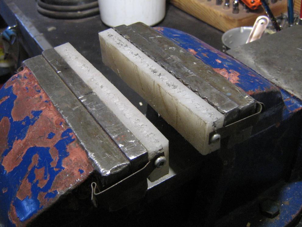

    The aluminum one's are bent to form around the jaws of the vise, the nylon one's are from an old cutting board and are held in place using clips from headlight screens.

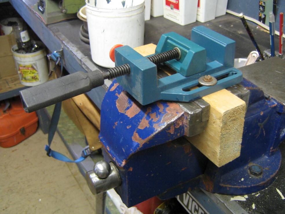

    A 2" x 4" provides a way of mounting a small speed screw vise to the bench vise.
