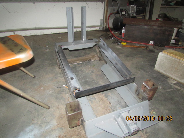

    I am adding a picture of the final version. I kept having trouble with the rear of the sled climbing on top of the sod, so I made some changes. I had the wood on the bottom of the rails and the sod would ball up and lift the sled, so I raised the platform and cut back some of the bottom rails and it cuts like it should now, so here is the final version. Bob.Sod removal sled.-img_0415.jpg

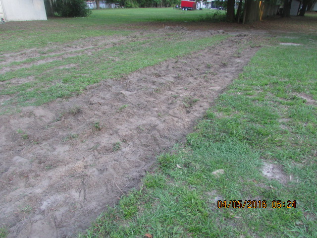

    Here is a picture after the cutting and sod removal, worked out very well. Had to add about 140 lbs. to cut properly. Bob.Sod removal sled.-img_0416.jpg
