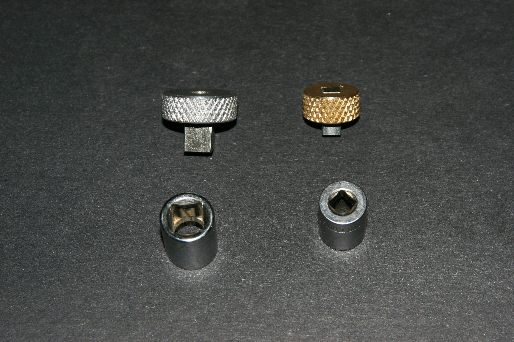

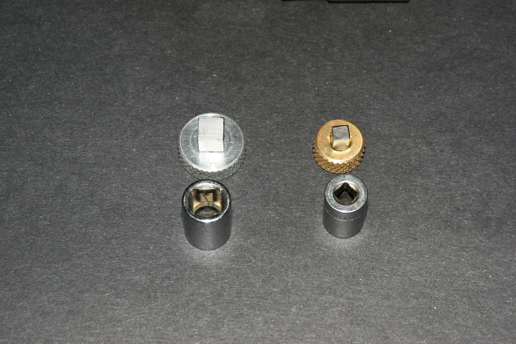

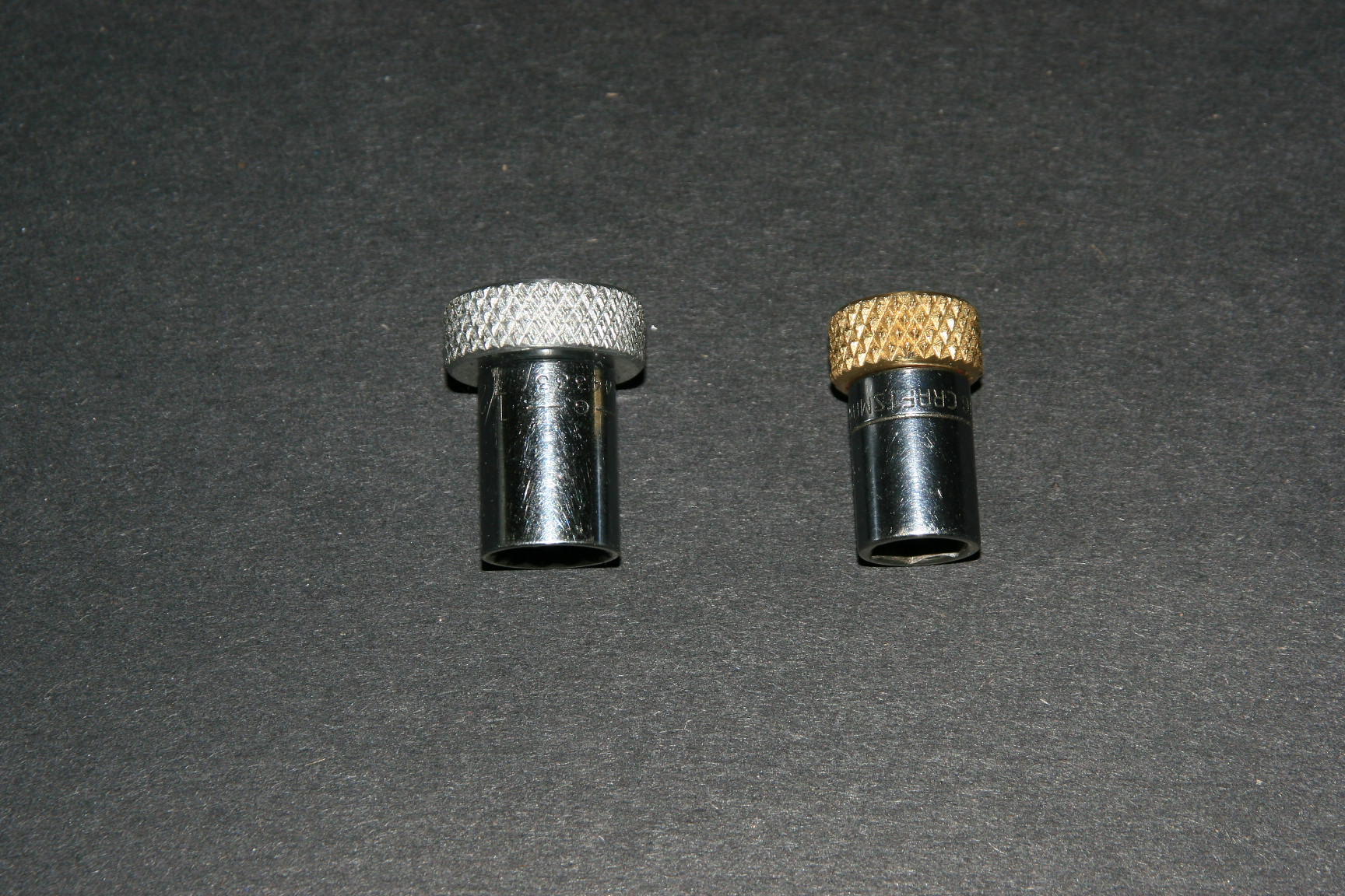

    It is much faster to spin on nuts with a little knob than using most any wrench.
    Using just a socket will usually result in sticking due to coarse threads or even small amounts of junk in the threads or small burrs.
    This little tool will allow you to spin on nuts fast.
    It also will do most of the turning in close access areas where the ratchet is moved rapidly in short strokes.
    Easy to make and use.
    I made mine with a new rotary broaching tool that I just finished but you could use other methods such as
    using allthread for the knurled knob attachment and then just tapping out the knurled knob to the thread size on the allthread.
    The thread of the allthread would be removed for the part that will engage the socket.
    For mine I used some key stock for the 1/4 inch one and then just milled down some 3/8 cold rolled to fit in the 1/4" broached hole in the knob.
    Cheers JR

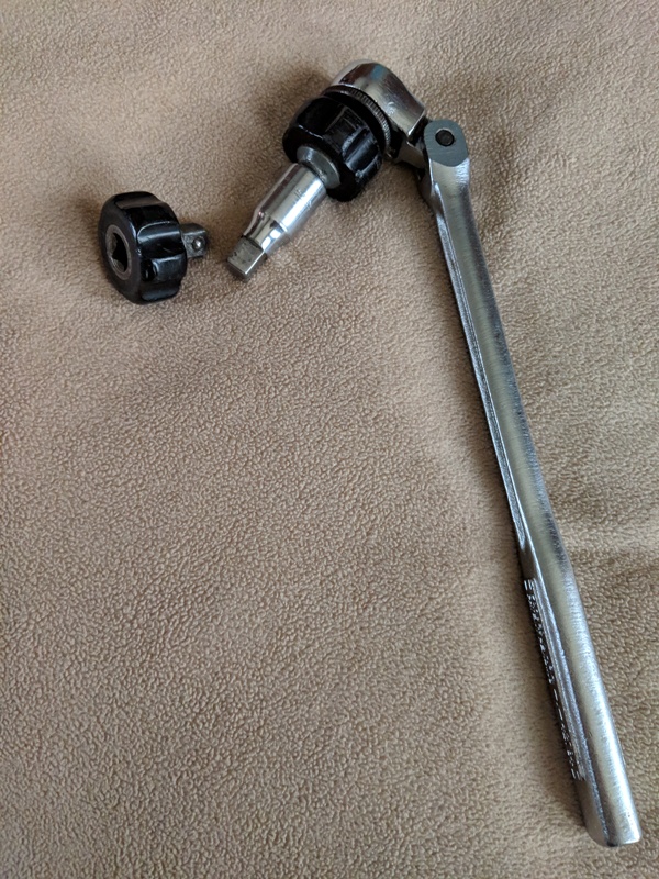

    JR that was a great idea! I love/loved those things for years...ok, at least 3+ decades. Have whats left of several sets (1/4, 3/8, 1/2) that I got from Matco, IIRC back in the day. Mine were metal set into a phenolic or plastic of some kind perfect fitting knob and had ball detents to hold the sockets or extensions. Used them so much I wore out the ball detent then made a special drift punch to re-crimp the ball and spring.
    I've tried the knurled ones and found them to be too small and not as comfortable. I like the scallop shape to these and the thickness of the knob gives a good feel. If I had a mill I might try this shape.
    Here are a couple of 3/8" I have.
    Socket Wrench Thumb Wheel for close quarters use and speed use-ratchet_knobs_800x600.jpg
    Thanks for the great idea and post!

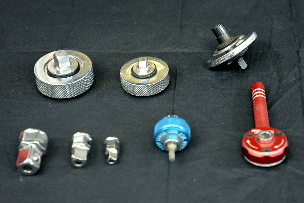

    Here is a pic of my collection, rather than write a story I made a short video with details of each one.
    Socket Wrench Thumb Wheel for close quarters use and speed use-thecollection.jpg Click for full size.
    The video is here on YouTube
