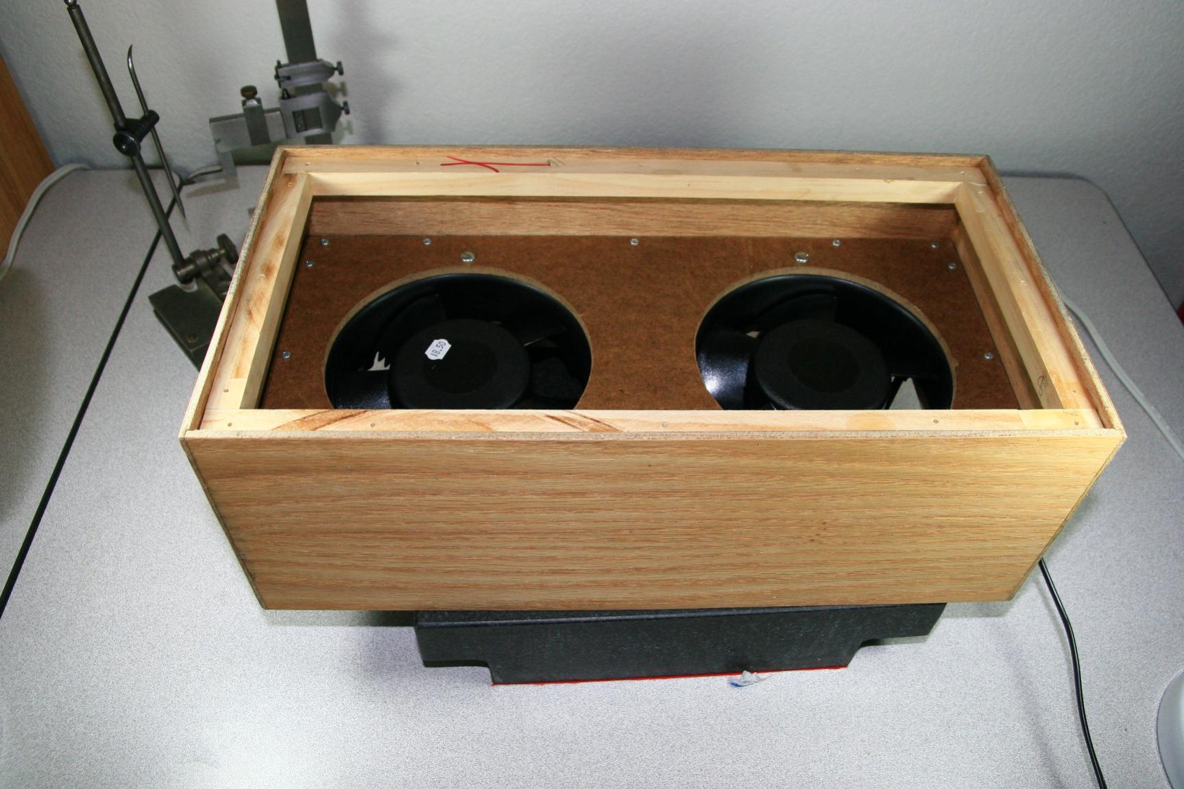

    Since setting up my inside shop the need for a way to collect fumes from CA (super glue) and oil smoke from the cutting process was evident.

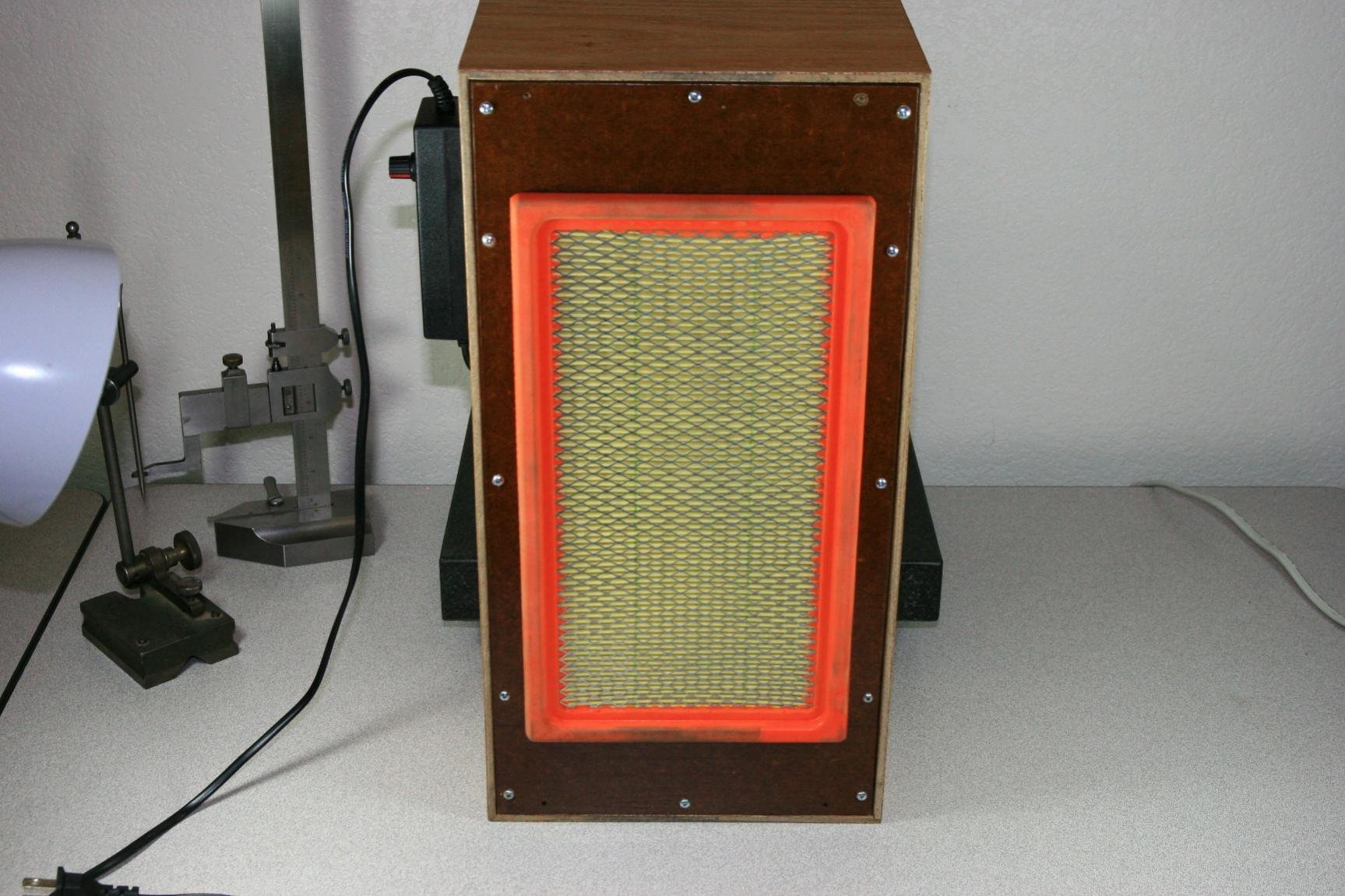

    I was going to use house type air filters and cut them to fit my fans but then the light went on and I thought why not use a ready made Fram air filter for my car?

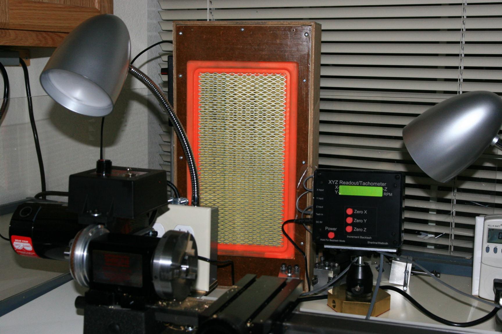

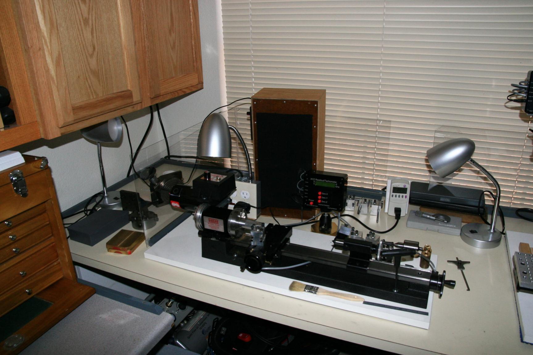

    So we have an inexpensive desk/bench top air filter. Able to suck in tall stacks of smoke from soldering or turning with oil on the lathe.
    CA fumes will be pulled into the filter and away from me.

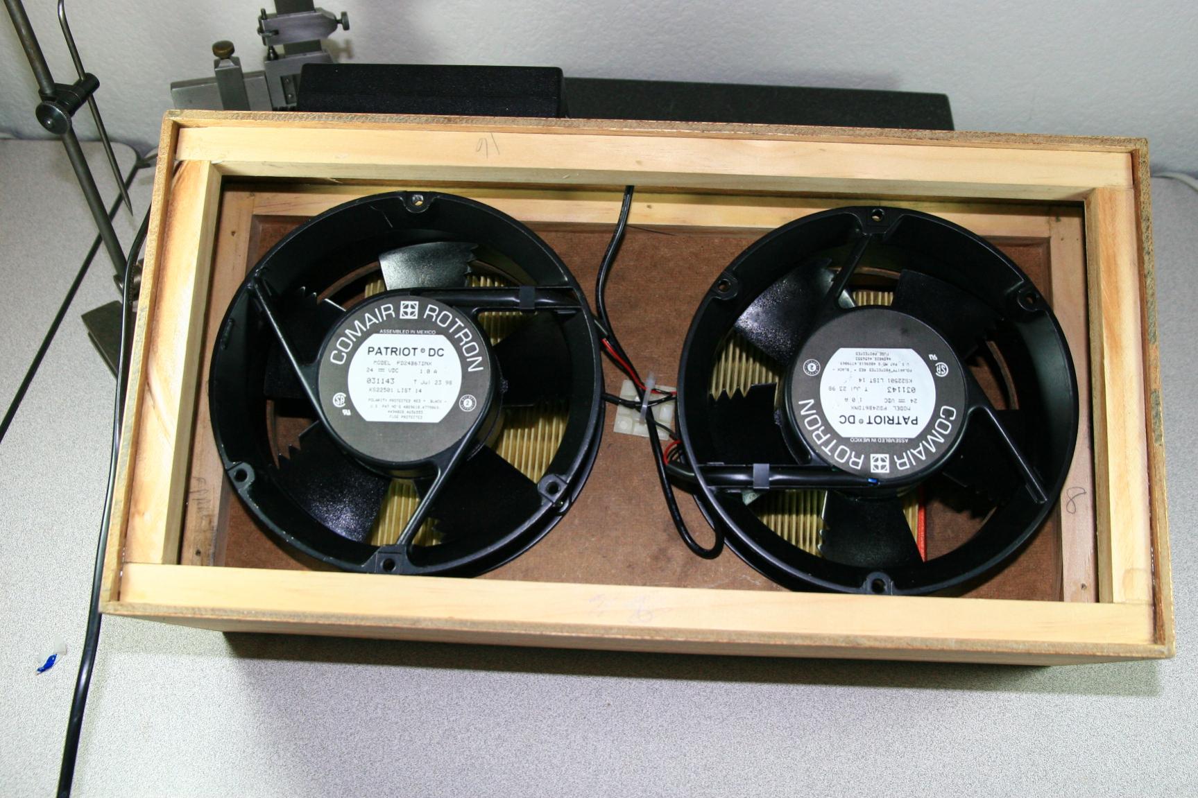

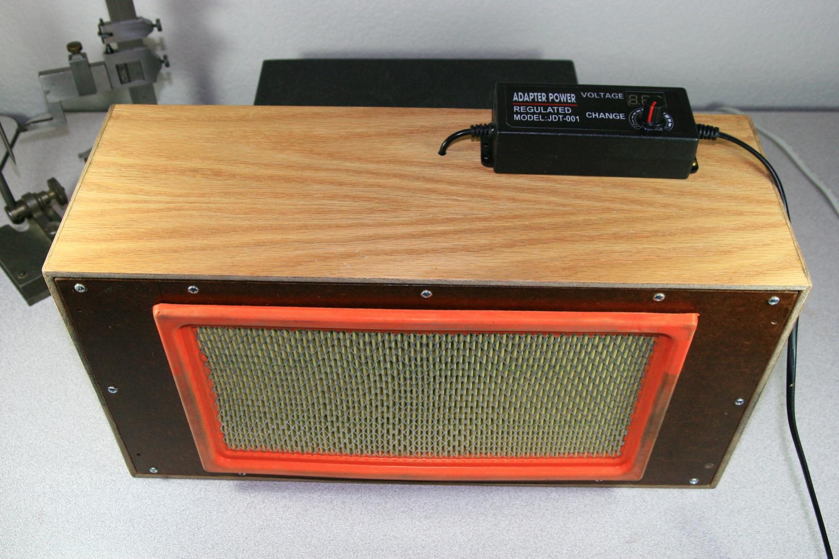

    I found the 24 vdc 235cfm fans at Allelectronics for $18.00 each. The power supply is 4-24vdc from eBay and the fram filter from my car.
    Wood and masonite as found in the shop.
    Fans run quite and move enough air to suck in and trap a lot of smoke or fumes.
    Cheers, JR
    Just added the carbon mesh filter to the front instead of the back. I think it will work better there where it can grab some small chips and I can always use the shop vac to clean it up a bit.

    Thanks PJ, I just added one picture to the first post. It shows that I put the carbon mesh filter on the front of the unit. Hides that orange filter color.
    That is not why I put it on the front. I thought it would be easier to vacuum up small chips there than from the pleated filter.
    Ran two smoke tests with the filter on and off. Both tests pulled all the smoke from a match into the filter. The match was located at the lathe tool bit and it was obvious that all the smoke went to the filter inlet. I think it will work good while turning.
