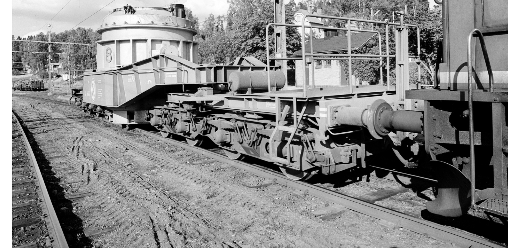

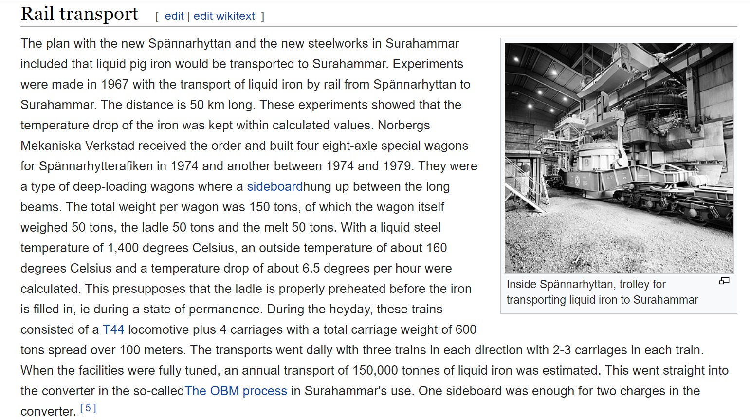

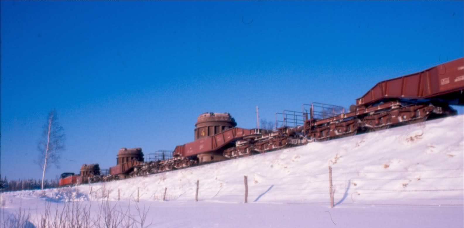

    Quote Originally Posted by olmike View Post
    How do they clean up something like that?
    With great difficulty.
    Suggestions: Prybars, power cutters and shovels for starters.
    Then add a fork lift for speed and biggie dumpsters for some recycling...
    I haven't personally experienced that - but I think the hopefully NOT clean floor
    and the shrinking of aluminum when solidifying should help loosening.
    There was a similar "spill" one early morning back in the seventies in a foundry not far from where I grew up,
    but that was 50 metric tons of red-hot glowing pig iron @ 2000-ish deg F...
    Enuff to ruin the coming day's sleep for the whole swing shift.
    Put the shop outta commission for two weeks...
    From https://sv.wikipedia.org/wiki/Sp%C3%...stransporterna
    "The Melt", as the 600 ton cargo train was nicked:
    Pic: Roger Lundberg, from https://www.flickr.com/photos/gamla_...n/photostream/
    From: https://digitaltmuseum.se/0210180776.../media?slide=0
    Last edited by DIYSwede; Mar 22, 2021 at 05:22 PM. Reason: added links, info & pics
