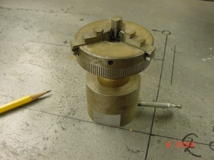

    Small Rotary Mill/Drill Fixture
    I built this little guy back in the mid-nineties to machine model car wheel centers. It simply clamped up in the cross-slide vise in the drill press and I would rotate it by hand to drill lug nut holes and make spokes in the wheel.
    As you can see it has a bit of a patina problem. Taking it apart you can see it is pretty simple. A small 3" chuck (Sherline I believe) a 3/4" dia. spindle threaded for 3/4-16 on one end and a turned block with a bronze bushing pressed into it.
    This shows a wheel center I made. It is kind of rough in the lug nut areas and is a reject piece. I made this table to solve the roughness issue. Never had a problem holding the pieces with this.
    This was used in the drill press and, now that I have the FrankenMill, I decided to fix it up a bit and do some of the stuff that I couldn't when I didn't have the tools. The first thing I did was mill off a couple of flat spots so it will clamp square and sturdy into the mill vise.

    The second thing I want to do is replace this clamp screw with a ball set screw for automatic detents.
    But first I need to make an adapter spindle so I can fit this 3" chuck to my H/V rotary table.
    That's another story.
