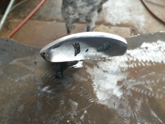

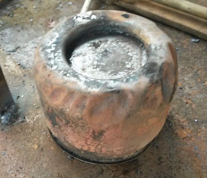

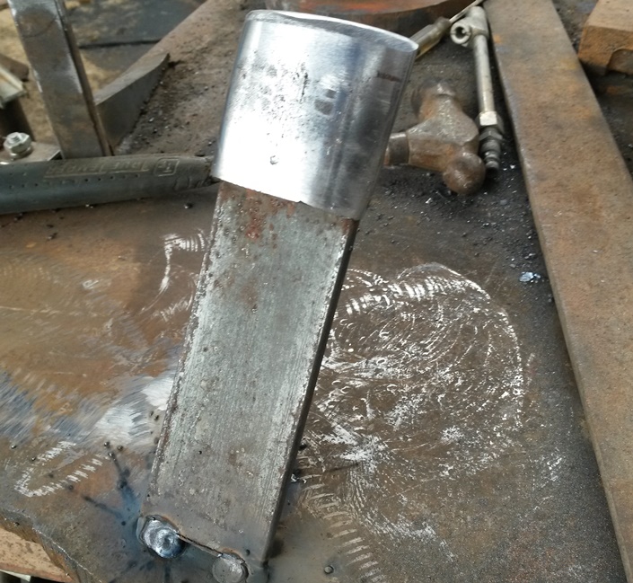

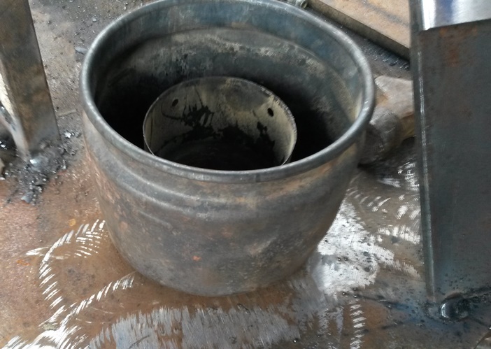

    The cup on the oil bath breather on my 8N ford had become badly dented over the years I suspect that who ever owned the tractor had problems removing it each time he needed to clean it and change out the oil There is an easy way to remove these but many just give them a whack. I'm doing a bit of clean up and re paint on the old tractor so I wanted to straighten the cup as well. Now first off I could have bought a new cup for around $40.00 and a used one in good condition for around $10.00 but why would I want to do that.
    This is more for educational purposes than anything as the dents did not reduce functionality at all

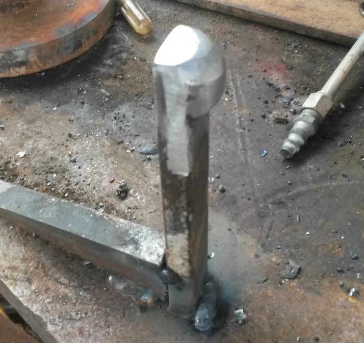

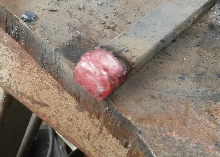

    I welded a blob on a piece of 1/2 by 1" bar stock then ground it to the desired radius then welded it to my table to use an an anvil so I could hammer out the worst of the dents.
    the cup before starting

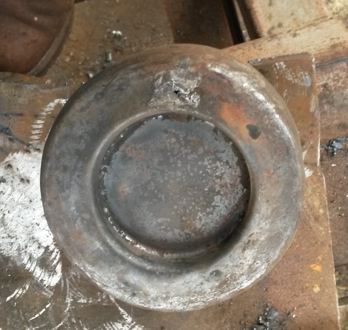

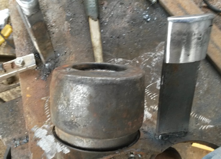

    After I had removed the worst of the dents I needed a large radius anvil to get the correct shape this was made from a piece of 1/4 by 2 flat bar and a segment cut from a piece of 4 inch pipe
    the cup after a hammering it back into shape a little more fine hammering and it will be ready for pain

    This is very good, especially your make do and mend philosophy. But, pardon me, Frank, you WELDED it to your table? If you don’t own an anvil, would it not be better to have a bolster on your bench, with a hardy hole cut in it, so that you could insert other anvil tools that you might make?
    11,729
    2,238
    You are correct Philip, for most cases having a hardy hole or even a pattern of holes to bolt tools or fixtures to is a far better way.
    the table top at the time was just a slab of 1" plate steel weighing about 500 lbs tossed atop of a pair of work horses that I was using to cut things out of the plate to become other tools or parts. it is far better to be able to grind off a weld than to have a permanent hole cut in it, as it takes a lot less time to grind off a weld than weld up a hole and grind that flush should I require that section of the plate for something else later.
    I keep thinking that one day I will carve out a shape from a piece of 4 1/4" thick plate that I have in the shape of a Peter Wright, but I just can't bring myself to making the first cut in the piece of steel. It is 13" wide and 11 ft long and as sure as I cut something out of it I will need it for something else

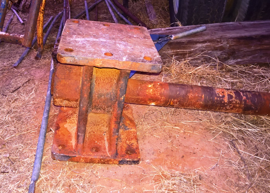

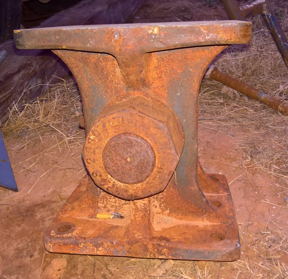

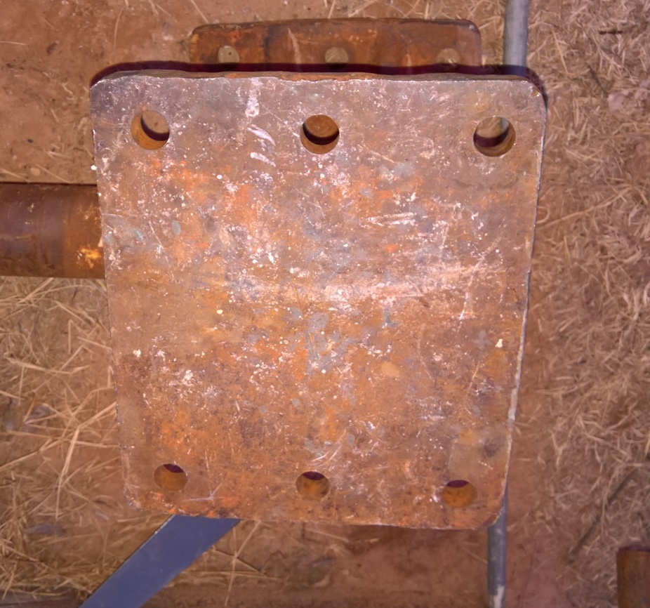

    In the mean time I mostly use what ever is handy all an anvil is, is a mass that is more than the material needing to be worked.
    I have this for when I have some heavy hitting to do it is something out of an old cotton mill. I had a 12 ft long 3 1/2 " steed rod bolted to it. My neighbor gave it to me to get it out of his way and because I needed a length of 3 inch or larger rod to make something out of. The top roller of my plate roll is made from that shaft.
    I still have a 4 ft section left
    the top and bottom flanges are about 12 x14 and 1 1/4inch thick
    the block is about 16 inches tall
