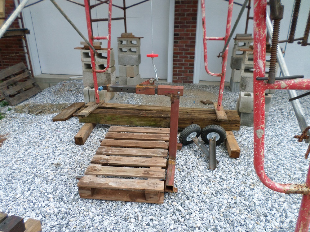

    Once all the welding was complete, it was time to test it.

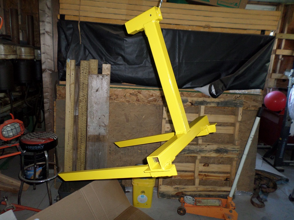

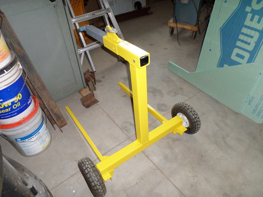

    After I used it for a period of time, I finally had a chance to take it inside the shop and clean it up for paint.
    I ended up painting it yellow with a few of the parts a grey.

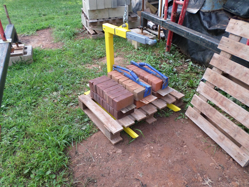

    Then I continued to use it for the rest of my bricking project.
    Notice that the wheels are easy to take on and off. They are simply 5/8" bolts welded into an angle iron that slides into the pallet lifter tube. The wheels are from Harbor Freight.
