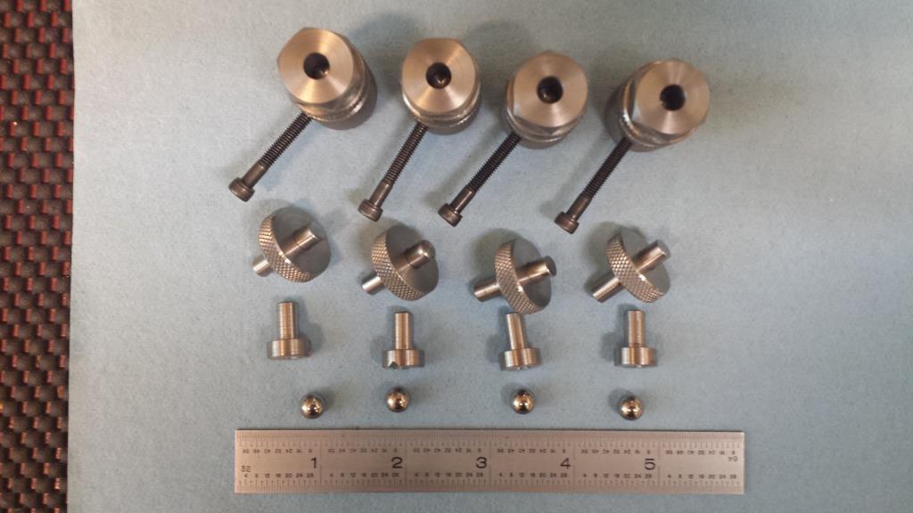

    Now that there are thousands of members to HomemadeTools.net - Encyclopedia of Homemade Tools, I am sure others are contributing tools to this year's 2016 "What's in Your Box" tool giveaway hosted by Keith Fenner on his YouTube channel.

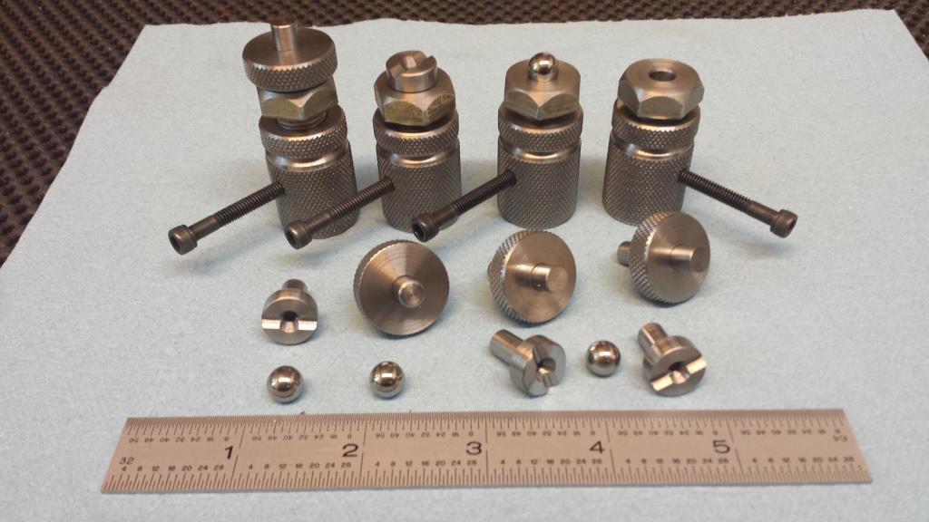

    This year I decided to make the small machinist jacks and accessories I had previously featured on HMT at http://www.homemadetools.net/forum/m...st-jacks-19843 . The new versions are made from 1144 Stressproof steel and parts of the accessories use O-1 drill rod for added strength. These jacks also have the retained 0.250" ball bearings near the bottom of the top hole in the jack screws. The ball bearings provide a smooth surface for rotating the accessories.
    Small Machinist Jacks for "What's in your box? 2016 Tool Giveaway"-small-machinist-jacks-accessories.jpg
    Small Machinist Jacks for "What's in your box? 2016 Tool Giveaway"-view-retained-ball-bearings-set-into-top-machinist-jacks.jpg

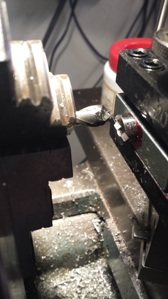

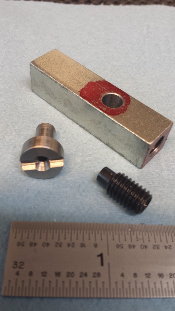

    I also tried something new by milling the v-groove to one of the accessories using my geared head lathe and a fixture that clamps in the QCTP. The fixture locks the part in place with a M8X1.25 dog point set screw and proved to be very strong and helped produce a smooth finish using the power cross feed. This way only a lathe is required to make these machinist jacks.
    Small Machinist Jacks for "What's in your box? 2016 Tool Giveaway"-fixture-holding-parting-when-machining-v-groove.jpg
    Small Machinist Jacks for "What's in your box? 2016 Tool Giveaway"-machining-v-groove-machinist-jack-accessory-made-o-1-drill-rod.jpg

    Excellent design and execution Paul Jones, and correct quantity too.
    The whole set is A1, cylindrical bodies, lock nut, Vee, ball, large and small flat contacts, and a handle too. Knowing pitch of the jack threads, can interpolate adjustments via 'counting' flats on screw portion. Good choice of material as well. Sometimes cast Asian, and case hardened Starrett's bases don't 'adhere' to granite or iron for one handed operation, irritating on light weight parts. Completely interchangeable, configuring into any situation I can think of. Occasionally I have to assemble 3 different jacks, especially on valve castings. Usually can't get through a day with just 3, critical for inspection; especially surface plate leveling.

    I have the original set I designed and built, and these have served me well but I discovered some "improvements". The set for the "2016 Tool Giveaway" incorporates these improvements and much easier to make the second time around. The knurled lock nut can be removed if the space is too narrow to fit the jack with the knurled nut still attached, and the handle can also serve as a thread lock because the side threaded hole goes all the way through to the bolt. As you pointed out, I selected the 20 threads per inch to allow for a way to estimate an adjustment knowing the thread pitch.
