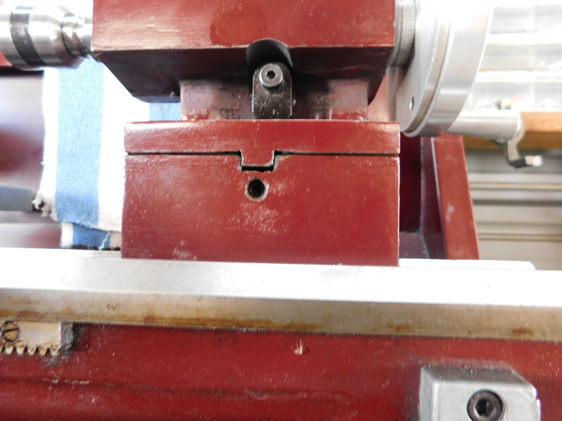

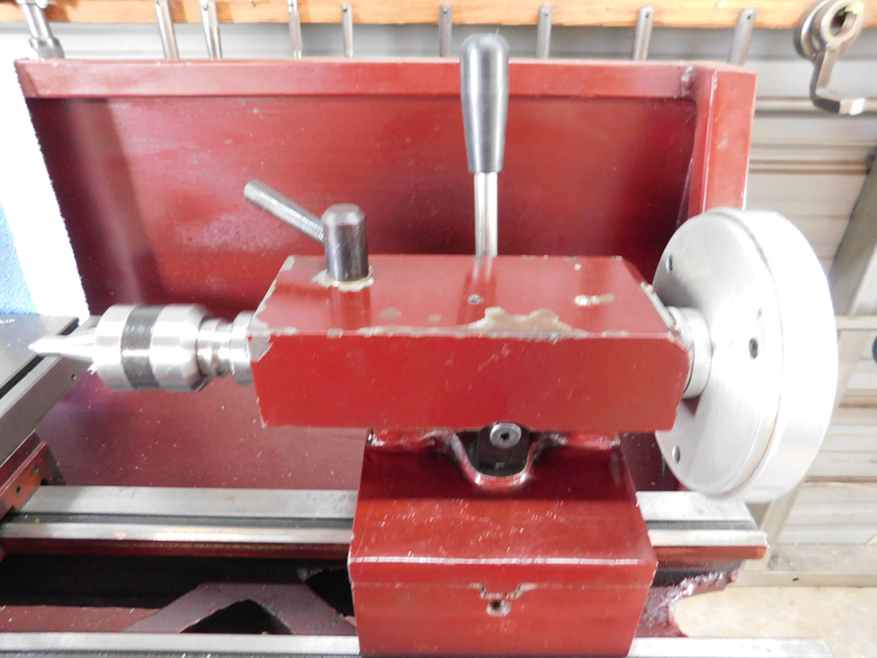

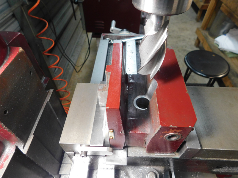

    Got tired of tightening that single bolt that clamps the tailstock to the bed of the lathe so I decided to do something about it, nothing fancy or new, just a cam, shoulder bolt, lever, knob and a little machining on the tailstock housing, the photos below shows the general principle.
    Thanks for looking
    Doug

    A couple years ago I did something similar to what your talking about and it worked ok too, but I decided to make something a little more efficient, this cam also has a spring between the clamp plate and the tailstock housing keeping them separated, it slides very smoothly up and down the bed and doesn't hang anywhere.
    Doug

    Your welcome Yves78
    The cam lock isn't at all complicated, as you can see in the first photo i'm reaming and counterboring the hole for the cam, very simple design
    Thanks Doug
