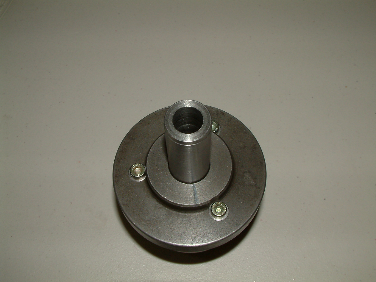

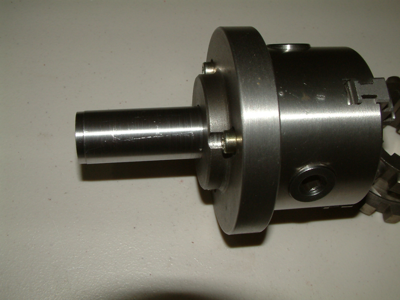

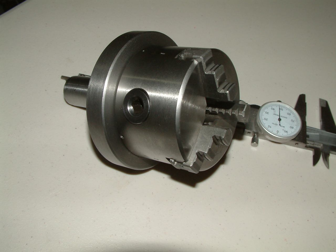

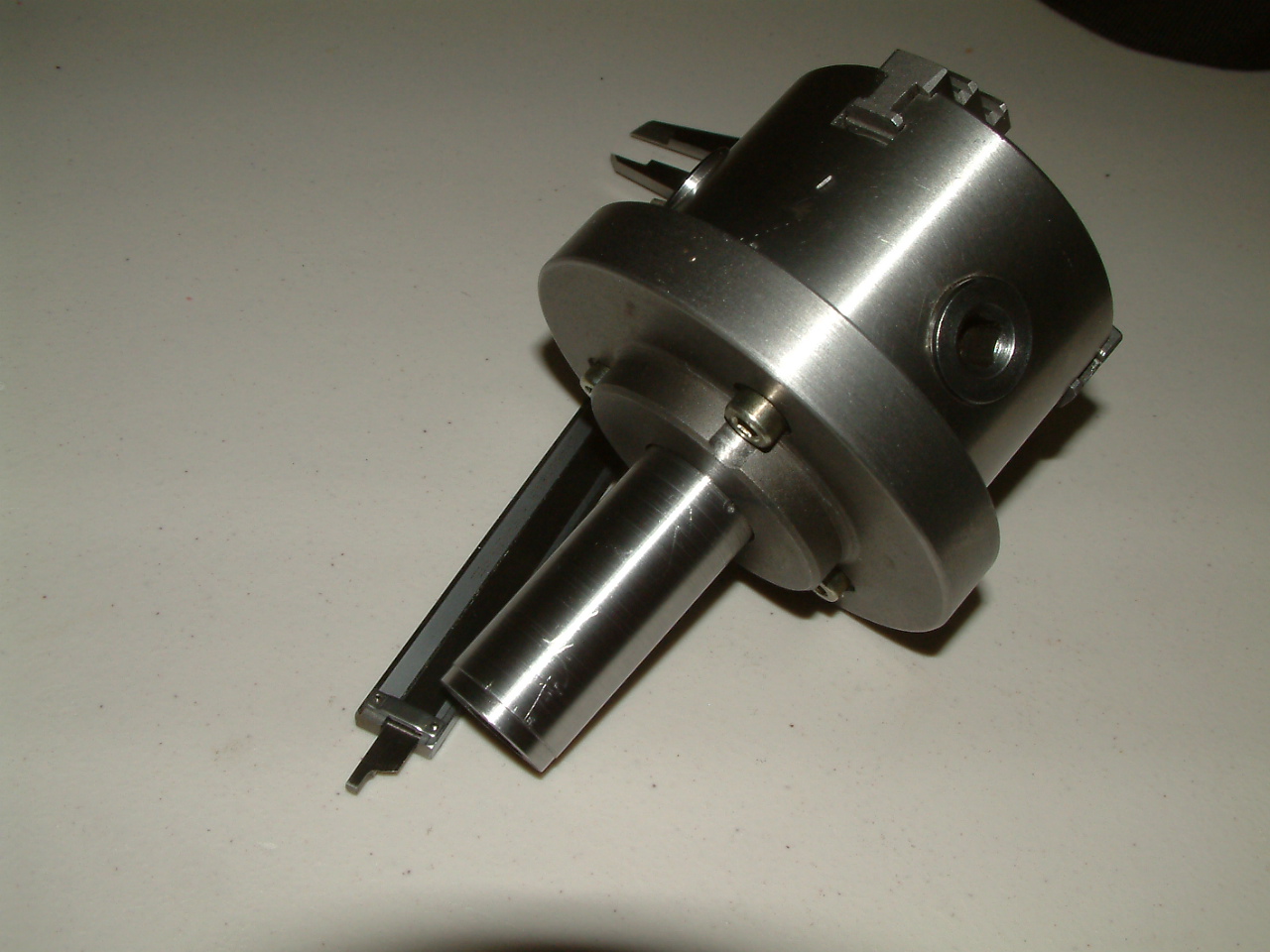

    I have a 5" 6 jaw chuck that is my go to chuck on the mini lathe. It cannot grip anything smaller than about a half inch diameter. So I end up switching it out for the original 3-jaw that came with the lathe. I bought a cast iron adapter plate from Little Machine Shop. It had a 1" x 10 tpi thread so I turned a piece of 1018 steel to .995" and single point threaded it on the lathe. Now the mini lathe chart only goes down to 12 tpi but LMS has a neat program that will compute the gear train to make any pitch from 1 to 256 tpi. It came up with 80 on A and 50 on D. Checked that with a scratch thread and it was right on. Then I simply faced the adapter on the lathe. Made up 3 screw points for the 6mm x 1 chuck thread and transfered the holes to the adapter plate.
    I checked it several times and I can get it set to within .002" of runout. If I need better I will just have to change out to my 5C collet chuck.
    Cheers, JR

    Over the weekend I had to change-out my 6" 3-jaw chuck for my 8" 4-jaw chuck on my geared head lathe and thought it would be much easier sometimes to just use my old 5" 4-jaw from my mini lathe and add new arbor for holding in the 6" 3-jaw chuck. I looked at this posting to see how you did the arbor when I notice your 3-jaw chuck with the arbor has four adjustment screws (I think you already posted the adjustment screw modification on HMT). I like the convience of chucking a smaller 4-jaw chuck in the 3-jaw chuck.
    Question: Since you have the four adjustment screws, I wondered why you couldn't adjust the 3-jaw chuck TIR to be better than 0.002" and mark the arbor with a witness mark for holding it the same way each time in the 6-jaw chuck?
    Paul
  16. The Following User Says Thank You to Paul Jones For This Useful Post:
    PJs (Nov 10, 2016)
  17. #9
    Jun 2016
    939
    1,190
    Thanked 2,128 Times in 566 Posts
    jjr2001's Tools
    Well I had such a nice fit on the register that I did not want to turn it under size at the time I made the adapter. However you are correct and It was quite easy to turn the register under size a bit and now it is better than .0005" or 5 tenths inch. I like it much better now.... Thanks for the motivation.
