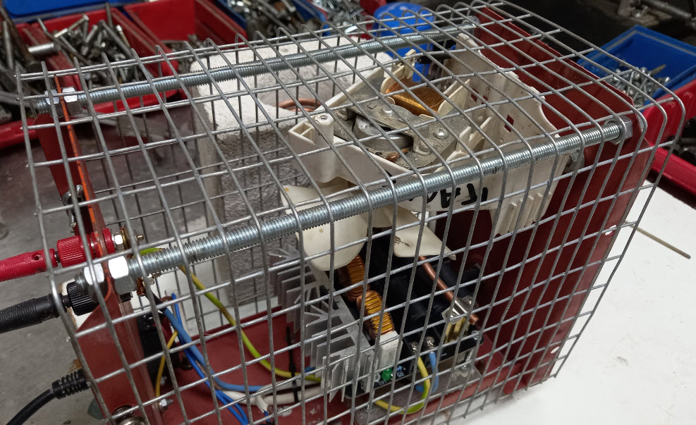

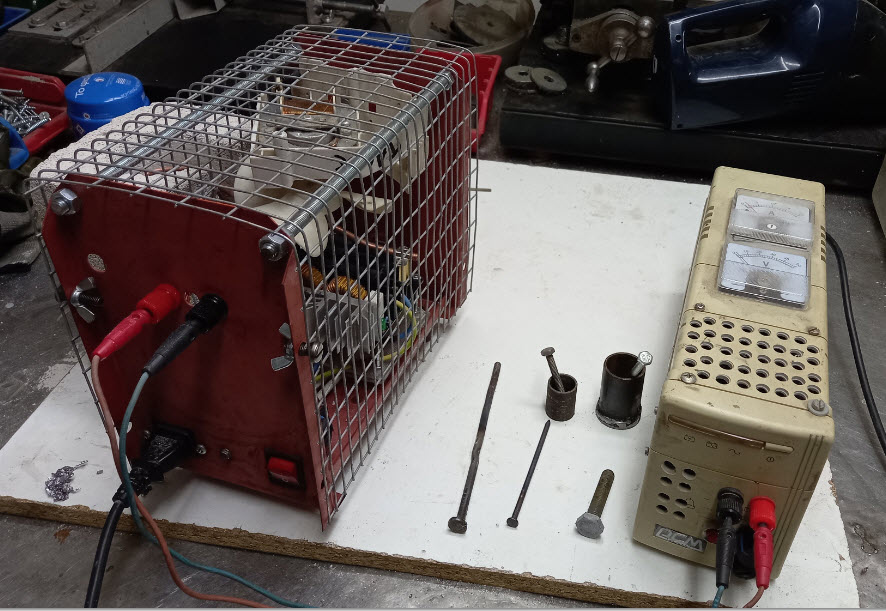

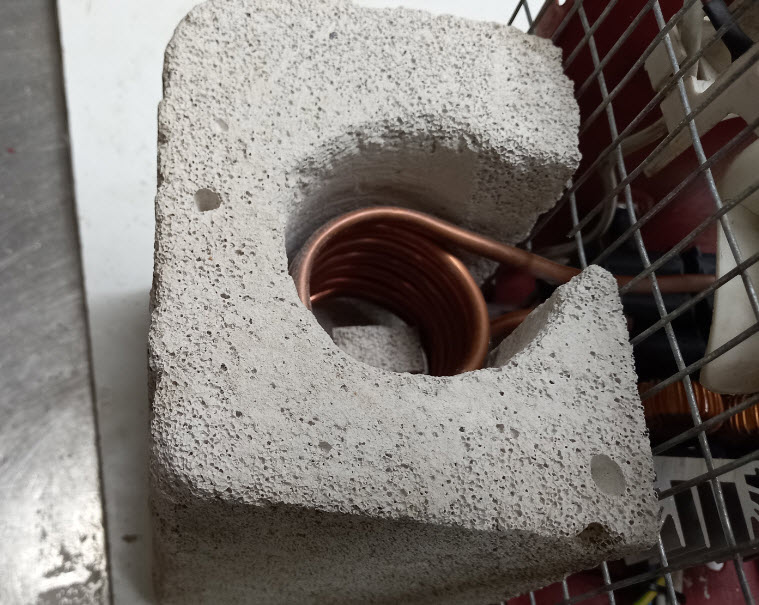

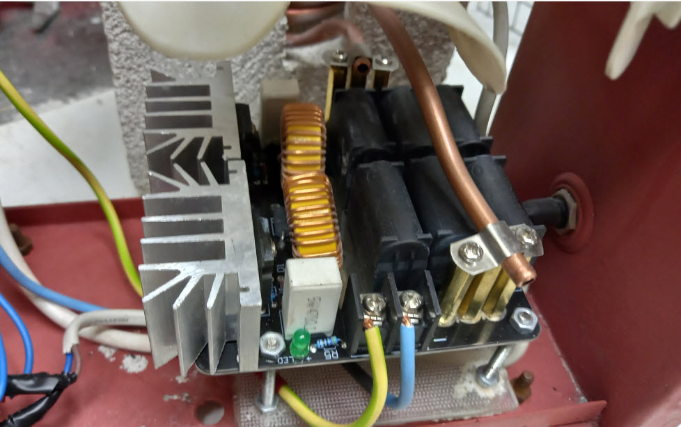

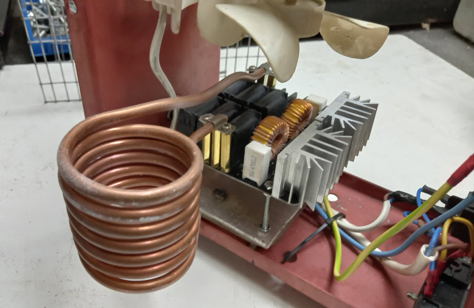

    Here i make some tests with an induction heating device to understand the way it works.
    Attached Thumbnails Attached Thumbnails SMALL  INDUCTION HEATING DEVICE-1.jpg   SMALL  INDUCTION HEATING DEVICE-2.jpg   SMALL  INDUCTION HEATING DEVICE-3.jpg   SMALL  INDUCTION HEATING DEVICE-4.jpg   SMALL  INDUCTION HEATING DEVICE-5.jpg

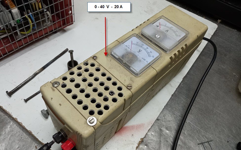

    I got it from bangood (you can see the link in the video) and I've used a strong homemade power supply from 2 transformers (the primaries in parallel-the secondaries in series) from old ups with a 35 A bridze rectifier with heat sink and two 4700 μF capacitors in parallel.I also put a big fan (230 v) from microwave oven to cool the system. Later i 'll make some testw with other coils to find the limits of thiw system.
