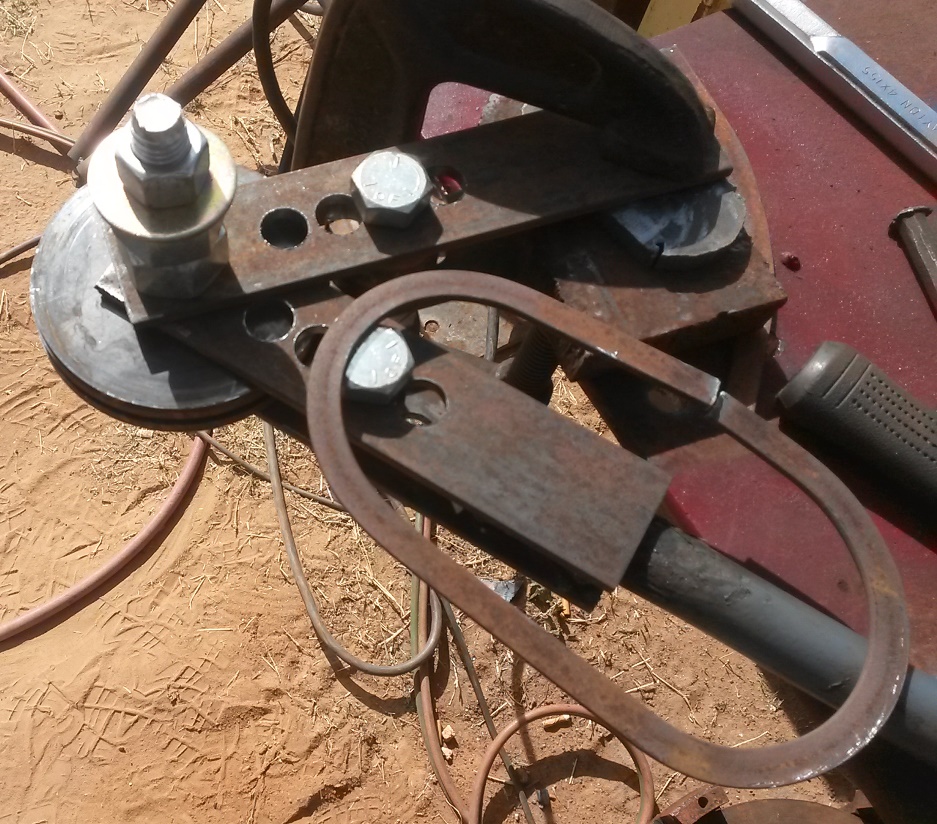

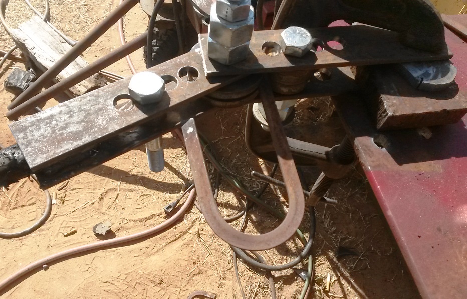

    Needing to form some 1/8" by 1/2" flat bar to make some letters I decided it was time to toss together a Hossfeld style bender
    the bender is nothing more than 4 pieces of 1/4 x 2" flat bar with a few holes drilled in them and some round disks of varying diameters and thicknesses plus some 3/4' bolts for the pins with a length of 3/4" pipe welded in as a handle.
    just change the size of the disks to get a different diameter

    HO$$, I didn't bother with any drawings or plans. Basically the bender was simply cobbled together designed around my need to make some 3" x 5" letters and some 4.5" x 8" letters using 1/8 by 1/2" flat bar. so to get a 3"x 5" number "0" I needed to make the inside radius 1 inch A 3/4" flat washer just happened to be 2" in diameter and I had some 3" diameter disks that were 3/8" thick Stack 2 of those with the washer in between for the die to form those letters.
    For the larger letters I searched through my pile of disks and found one that was 3.5" in diameter and 1/8" thick, then to make the rest of the die I located a pair of 4.5" by 1/4" thick but I still needed another 1/4" to have the same 7/8" stack up as with the smaller die set. so I located a pair of disks that were 1/8" thick just slightly smaller in OD than the 4.5" for the rolling die I found a pair of 1.5" x 3/8" disks and another one 1/8" thick I chucked these disks up in the lathe 1 by 1 and drilled a 3/4" hole through the center. For the pulling block that is simply a head bolt nut from a caterpillar engine I heated it to anneal it soft enough to drill then chucked in in the lathe and drilled out the threads. Trust me from past experiences with these nuts they have to be annealed or you're going to have to re sharpen the drill several times just to drill out the threads they are that hard. Then I turned it down to only 7/8' tall
    for the bender bars themselves I stacked all 4 of them and drilled the first hole near one end then centered one of the 3" disks on the hole and centered the 1.5" disk on the bars touching the 3" disk. to drill the 2nd hole then replaced the 3" with a 4.5" and repeated for the next hole just encase I need to make a larger diameter bend later on I stepped over a distance and drilled another hole. For right now the only actual fabrication that was done was to flatten a 18" long 3/4" sch 80 pipe on one end to 7/8" so I could weld it between the swing bars as a handle the frame bars are just clamped to the table with a piece of 1 3/8" thick piece of steel Later I will weld up the frame properly and add a bolting base so I can bolt it to my work table.

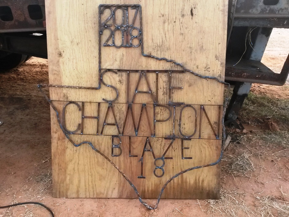

    This is what I made the bender for
    My sister's Grand son is the qtr back on his school's 6 man football team He has 2 state rings now and 1 more year before he graduates I told her that I am making the 2019 numbers and keeping them in my shop until next year so he had better take the team to the championship and win next year.

    Thanks Pj my sis said she wanted it for his up coming birthday there is 20 feet of 1/2" sq twisted bar to make the boarder of Texas and almost 50 feet of 1/8 by 1/2 inch flat bar to make the letters and the lines to support them I really hope he likes it enough to keep it a long time, and to give him the incentive to strive to do his very best in life.

    I saw the twisted bar and wondered how you got it to match the state line. Fabulous BD gift and sure he will treasure it.

    To get the twisted bar to emulate the state line shapes I heated and bent it in many places
    It doesn't exactly match the state line but then again 90% of the topo. maps don't perfectly match the state line either. For instance I dropped the red river route a little too far south over where Texas meets Arkansas by about 50 miles and IO left out the inlet at the port of Galveston and the one at Houston but its close enough to give the impression of the shape of Texas
