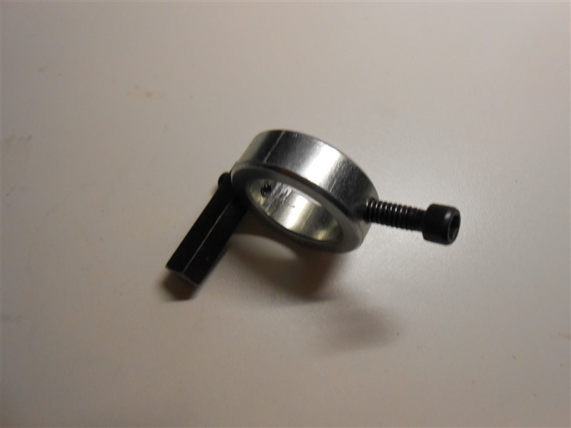

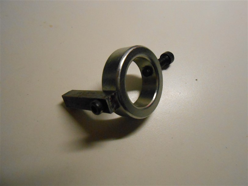

    Here's a budget build for ya. A small lathe dog I made for my 3 inch chuck on the mini lathe.
    It's made from a store bought 1-1/2" x 1/2" metal spacer, a piece of 5/16" square stock and 2 cap screws. (8-32 & 1/4-20)
    Other sizes similar in design can also be made if needed.
