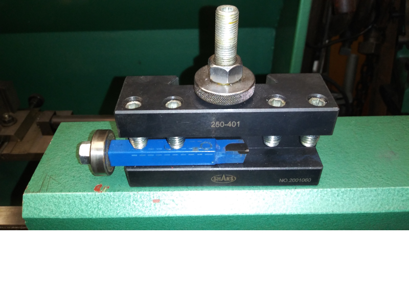

    I needed a holder for a 3/8" shank boring bar. The logical choice was a scrap cemented cutter by drilling a hole in the end to the depth of length of the boring bar shank, then cross drilling and tapping for a standard 3/8" flat point grub screw

    I can always silver solder a new carbide on the 5/8" square

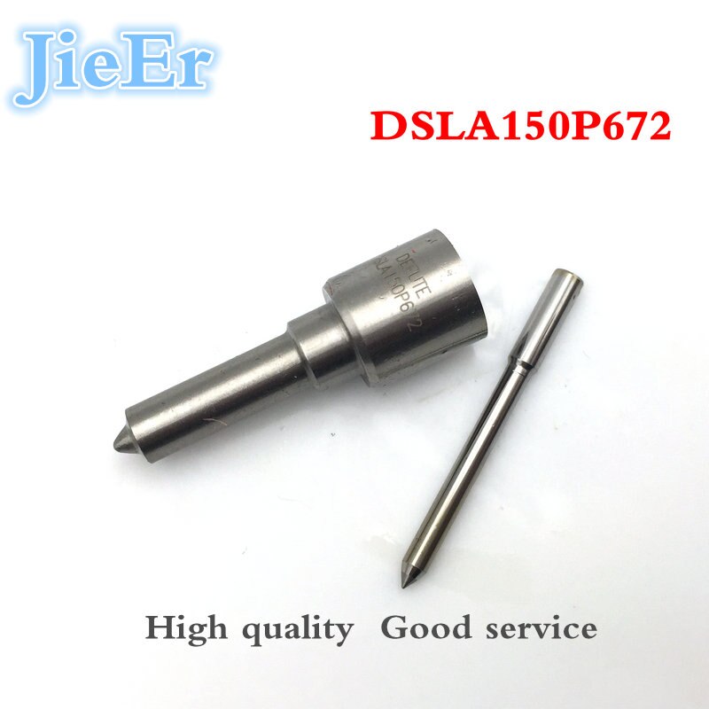

    I found that old injector needles in the 9 litre and up sizes make great small boring bars in a holder similar to yours. Very good quality steel with Vanadium, Chromium and Molybdenum among the ingredients. Takes a mirror polish and hones razor sharp. They make excellent trepanning tools as well.

    From your 9 liter reference I'm thinking this is some sort of large engine injector. But I have no clue what this injector needle is.
    You are correct. Diesel engine fuel injectors have a 'needle' inside the nozzles. When fuel is supplied to the injector pressure upon a land on the needle lifts it off its seat and allows fuel to flow in some designs, others can be electrically operated.
    The needles are made of a high alloy steel that makes excellent tools such as small punches, lathe tools, scribes, gravers etc.
    If you visit a fuel shop or maybe a heavy equipment workshop, truck shop they often have a pile of old nozzles in a scrap bin. For a small donation to the social club you can usually get a good supply.

    small boring bar holder-fuel-nozzle-injection-nozzle.jpg The bodies would make a good blade if you are into forging cutlery.
