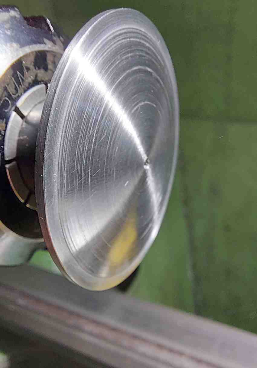

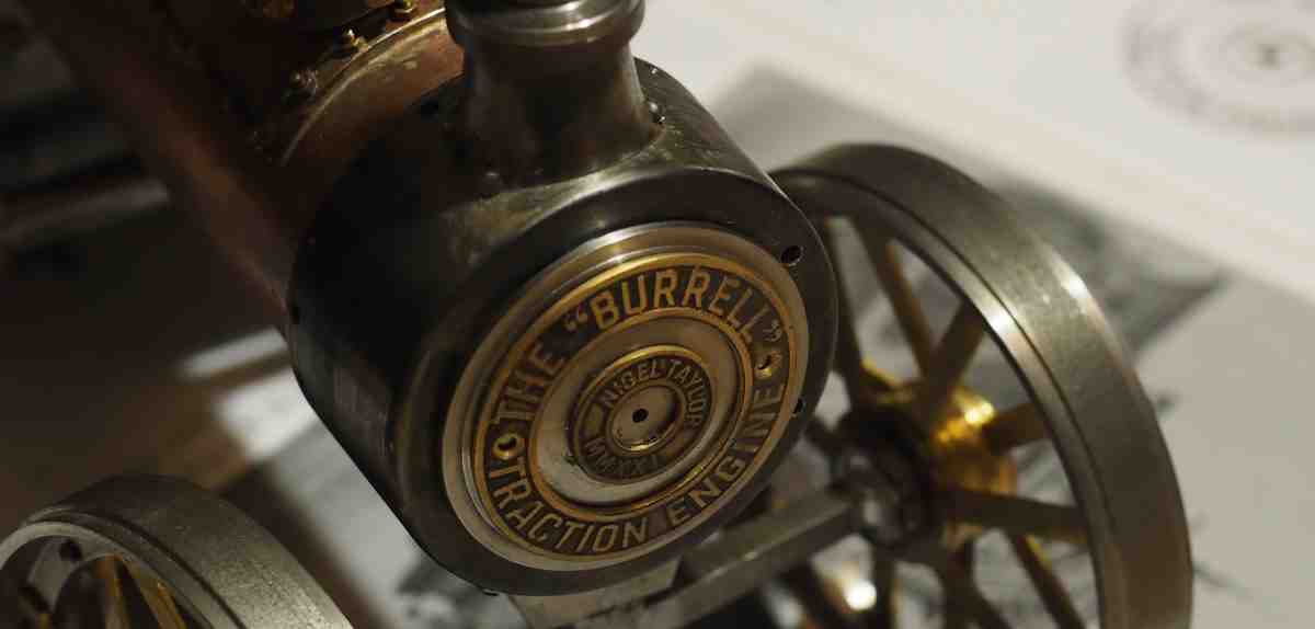

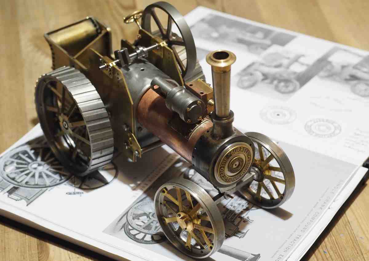

    The old flat smokebox door really annoyed me. So, after making a tool to machine a radius of 71.4mm I turned a domed door.
    I then annealed and pressed the brass plaques to shape, I used a sheet of rubber and two blocks of wood in the vice to do this.
    It's only a small change, but I think it looks much better.

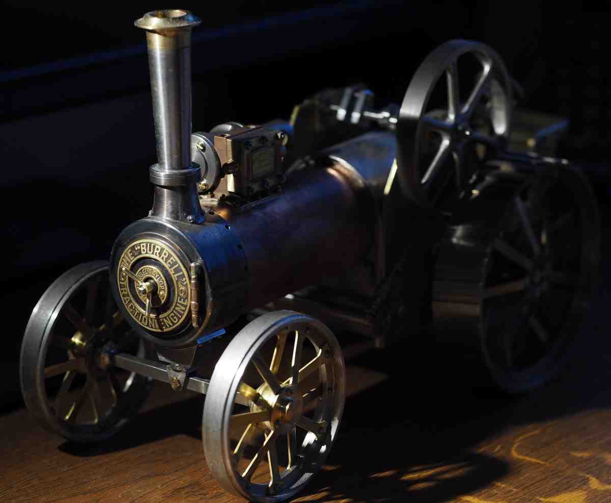

    The engine with radiused smokebox door sat on my A4 notebook.
    Merry Christmas and Happy New Year to everybody who has supported me over the last year, Nigel

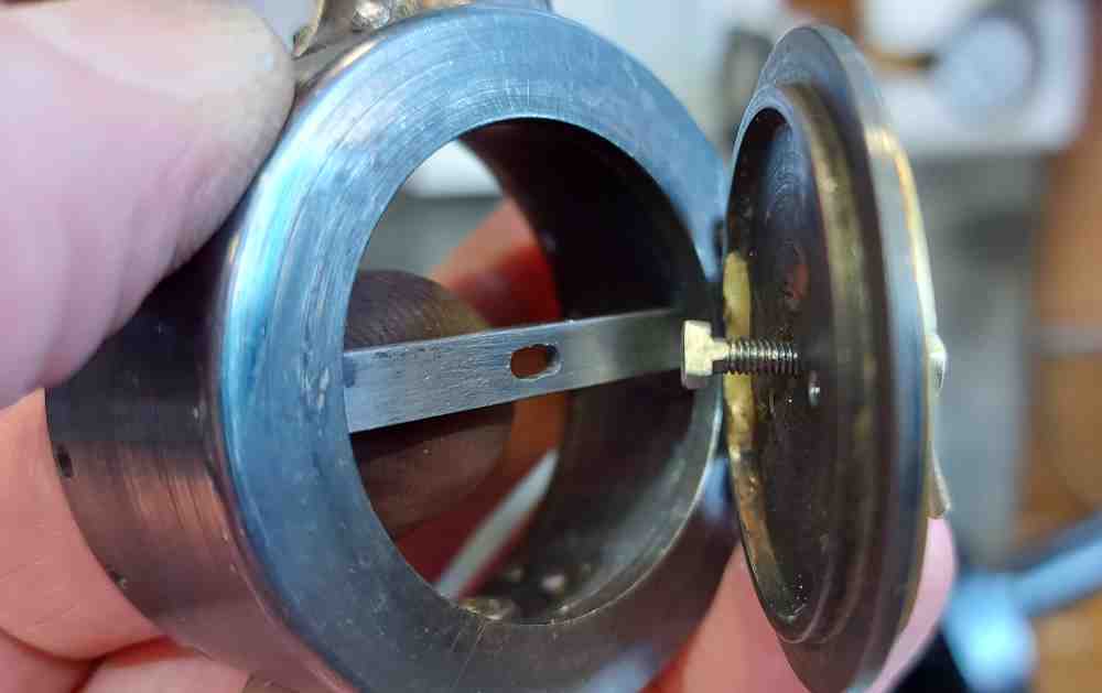

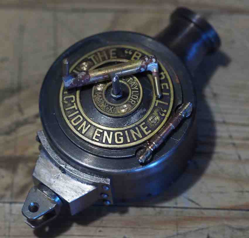

    I've now made the Burrell door handles and the locking system, this now all works at 1/20th scale.
    This hopefully shows the basic locking system.
    The Burrell door lock is a T-head bolt with flat sides on the threaded section. This bolt goes through the door from the back, a handle with a slot then goes on allowing the bolt to be rotated. A second handle with a threaded not then allows the bolt to be pulled up tight.
    In the smokebox a beam goes across the diameter of the opening and has a slot in it to allow the bolt head to go through. Then the bolt is rotated and hence the T-head gets a purchase on the beam.
    The handles were made as one part based on them being so small and then I split them into two parts later.
    Still lots to do

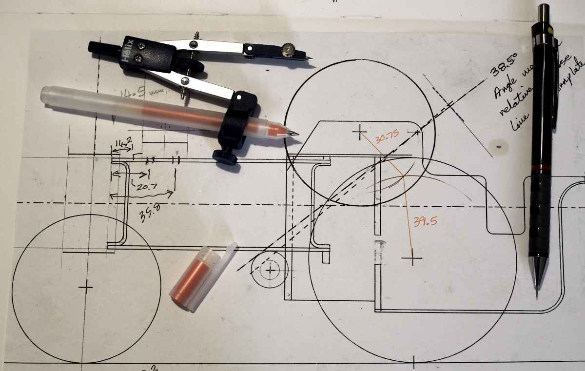

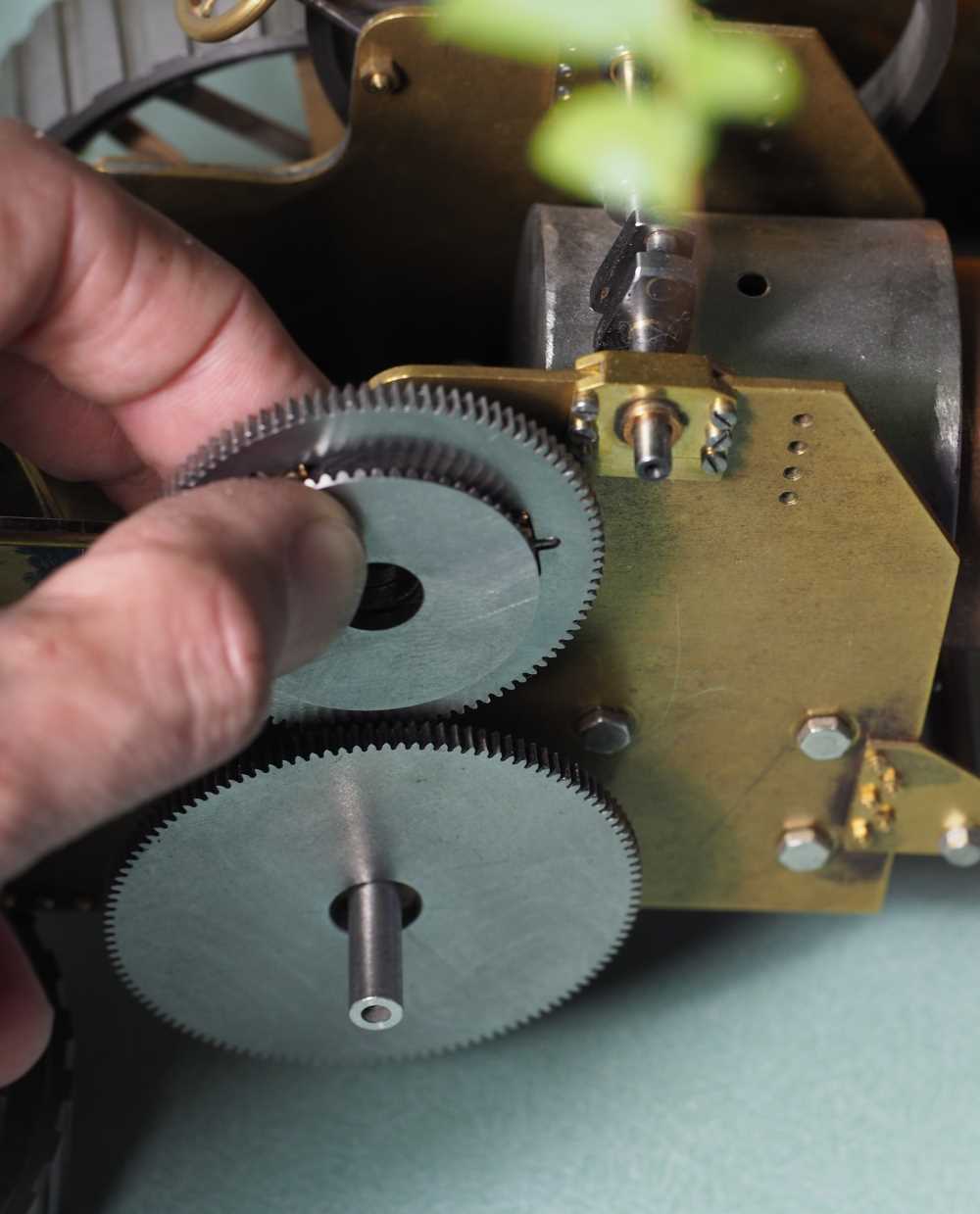

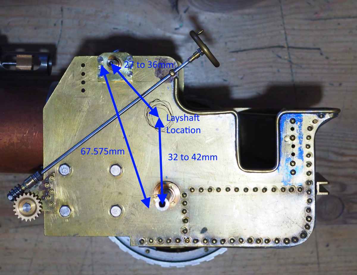

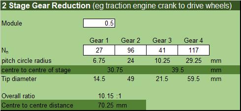

    Just been working out how to get to 10:1 as an overall ratio and where the layshaft can go.
    then some calculations of the options (using excel)
    and I think I have a sensible result
    Next step is cutting some gears

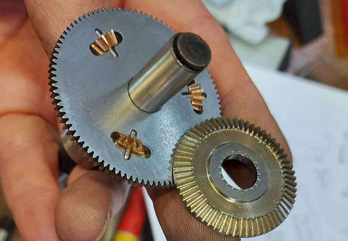

    the first prototype differential for the Burrell, some way to go yet, but hopefully you can see what I'm trying to achieve
  9. The Following User Says Thank You to editor@glue-it.com For This Useful Post:
    nova_robotics (Mar 1, 2022)

    a still image of the gears here

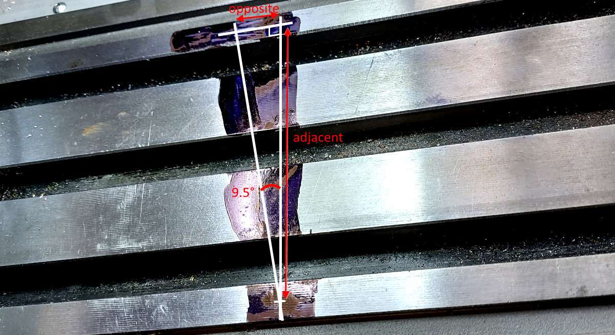

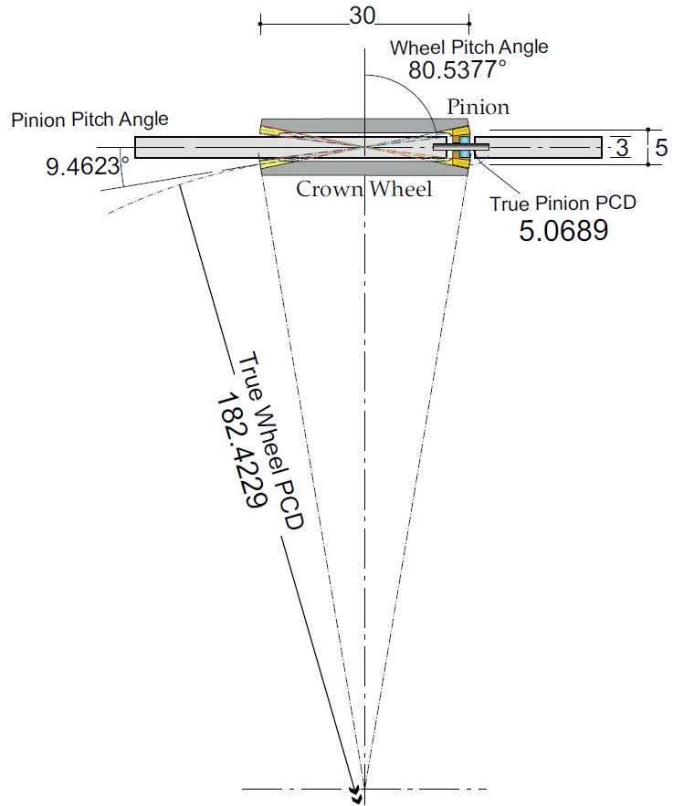

    I have to firstly say a huge thanks to JG for sorting out the angles and cutting of these bevels. I thought I knew how to cut them and they would be easy....how wrong I was

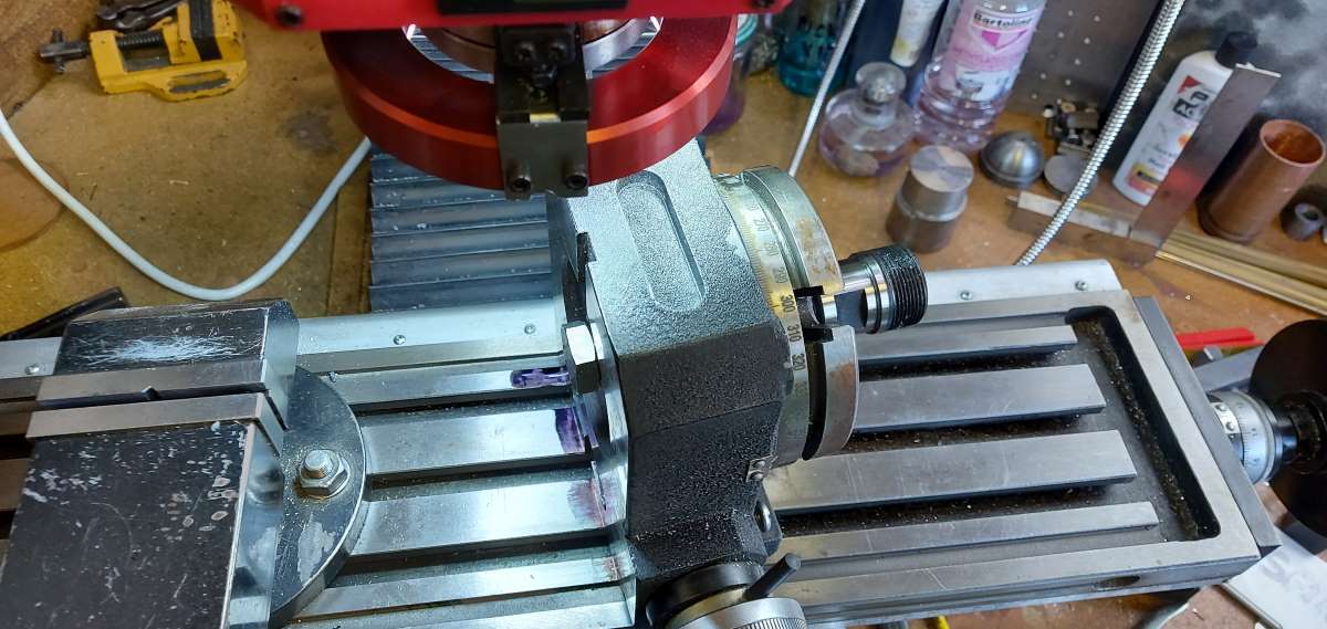

    I spent a happy hour (no drinking) setting out a 9.5° angle on the milling table and then aligning the rotary table to it.
    Now I have to go and cut those gears. Must admit that the cost and effort required in fitting the DRO has been paid back several times over...and it isn't the simplest thing to fit
  12. #110
    Supporting Member editor@glue-it.com's Avatar
    Apr 2017
    UK
    291
    40
    Thanked 483 Times in 136 Posts
    editor@glue-it.com's Tools

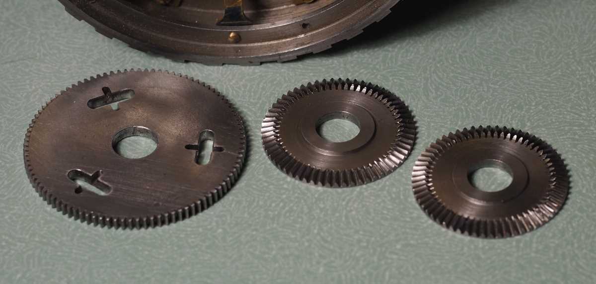

    The differential has not started again, but there is a different angle on the Burrell.
    I have to say a big thanks to JG for contacting me and offering to calculate the correct angle for the bevels. As you probably saw in the above youtube they don't run that well. JG's calculations showed that the angle needs to be close to 9.5° rather than 20°, hence last post on setting out the 9.5° on the table.
    Since then I have managed to re-cut the crown wheels. Perhaps I should not have re-cut them, but there was enough material in them still.
    plus, this has thinned down the whole assembly. Although, note that the next image isn't using the correct pinion wheels - they are to be made from scratch again as 10T and 9.5°
