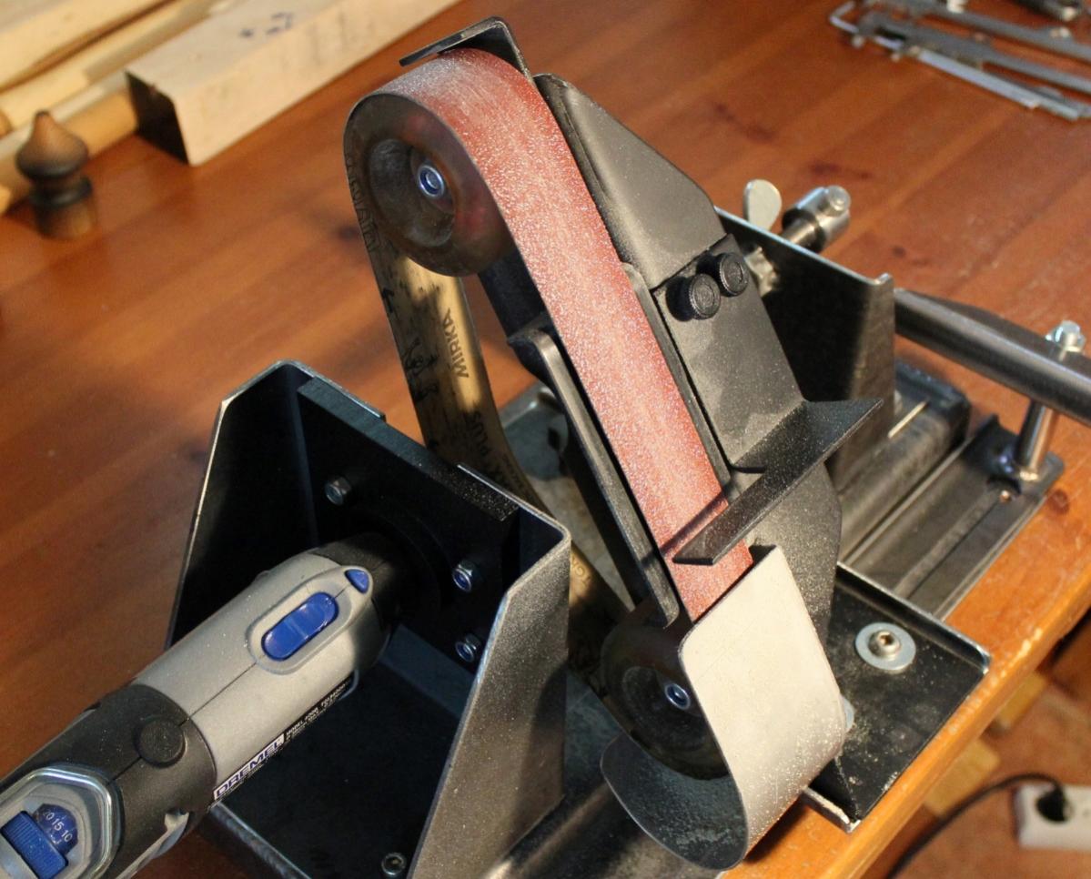

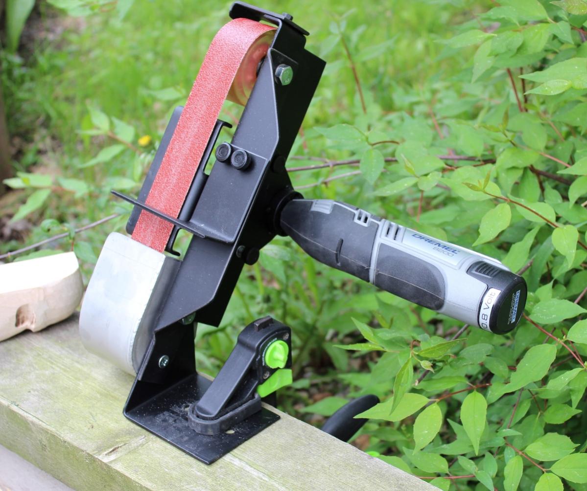

    I made a simple belt sander attachment for dremel rotary tool.
    Material i used 3mm thick steel and wheels from a skateboard.
    Small beltsander/lathe  attachment for rotary tool.-6.jpg
    Structure is very simple and Its made from 5 pieces, connected together with nuts and screws.
    Sander is powered with a Dremel 4000 rotary tool wich can be removed after use.
    Small beltsander/lathe  attachment for rotary tool.-5.jpg

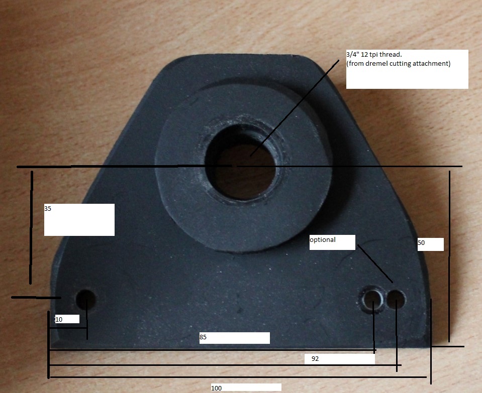

    But, it has some improvements and a closer look for the buil itself.
    "Plans with the main measures" measures are in millimeters. One inch is 25.4 millimeters.
    Small beltsander/lathe  attachment for rotary tool.-nauhis-piirrus-2.jpgSmall beltsander/lathe  attachment for rotary tool.-nauhis-piirrus-3.jpgSmall beltsander/lathe  attachment for rotary tool.-nauhis-piirrus-1.jpg
    Later i made a little changes to it and now its an attachment in my rotary tool lathe construction.
    Modified a splash guard from a dremel tool to hold the rotary tool, so its very quick and easy to attach.
    Small beltsander/lathe  attachment for rotary tool.-1.jpg
    Small beltsander/lathe  attachment for rotary tool.-2.jpg
